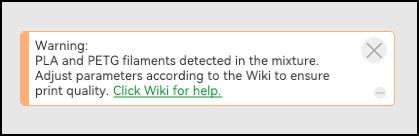

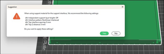

A while back I bought the dedicated product “Support for ABS” and have been very pleased with how well it works. Because I was so satisfied with the particular purpose made filament I bought a spool of “Support for PLA/PETG”. This stuff.
I have loaded it in a slot, imported a model, enable supports and painted the area needing support. I am getting the below message and the link takes me to a wiki page about using PLA to support the PETG. I suspect that is dated and does not reflect a dedicated support interface material. Searched the wiki to no avail. There may be something I’ve missed but this is as much about the Studio slicer not getting the message the RFID is sending.

I always get the same warning when using that support filament with PETG. Now I just ignore it. I guess I’d call it a slicer bug. Yea if it was PLA it would probably stick to PLA, so I’m not sure what it is going on about. There are no “support” filament types in the system at all (eg. when adding a new filament) so maybe that’s the issue and “PLA” is the closest in terms of print settings. :person_shrugging:

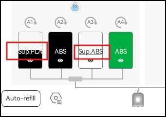

I have two different types of support filaments, depending on what the model is to be made of. The name of each. Bambu sells 4 different support filaments. I did what @maxthreed suggested and ignored it, which is what was going to be my plan already.
The support filament materials main feature is that it will not stick, or only weakly stick to (in my case here) to the PETG. They have a RFID that identifies them as what they are.
  • Support for ABS
  • Support for PLA/PETG
The stuff works great. I know lots of people go through a lot of effort to not use supports but I would recommend it to anyone. Because it is only ever 1 layer thick, a spool can last for years probably. I have the two materials in the green squares.

AMS RFID Detects them correctly

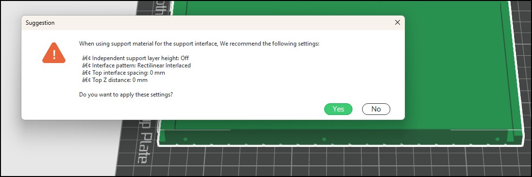

This is message when I use ABS and Support for ABS as my printing media.
You’re right, the AMS/printer itself seems to name the filament type properly. What I meant, and just re-verified, in Studio itself there’s no apparent distinction for support type filaments. Or more specifically, the “Support for PLA/PETG” filament profile inherits from (starts with) the basic PLA profile, and to the slicer it appears to be a “PLA” type. So then it throws that minor fit because normally mixing PLA with PETG may require special attention (it also does this when one wants to use plain PLA for PETG interface or vice versa). In contrast, the “Support for ABS” filament type inherits from the base ABS filament profile, so to the slicer it’s just another ABS filament (hence no complaining).
If you’re curious where I’m finding the inheritance stuff, it’s directly in the JSON filament profiles installed in the Studio configuration data folder → system → BBL → filament. For example from Bambu Support For PLA-PETG @base.json
    "inherits": "fdm_filament_pla",
Which uses the file named fdm_filament_pla.json in the same folder for the base settings, only overriding some options. Then there are more specific profiles for each printer and (in many cass) per nozzle size, each inheriting from the more general configs.
