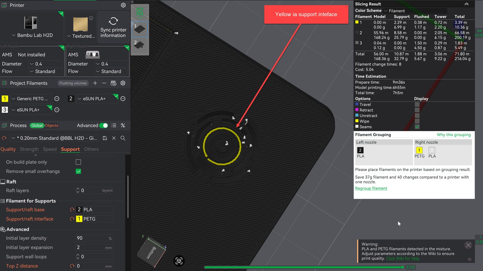

Support inteface is being printed when it shouldnt
Software version: 2.1.0.59
Printer: H2D
Print: Left Nozzle has PLA. Right nozzle has AMS with transparent PLA and PETG (used for support interface)

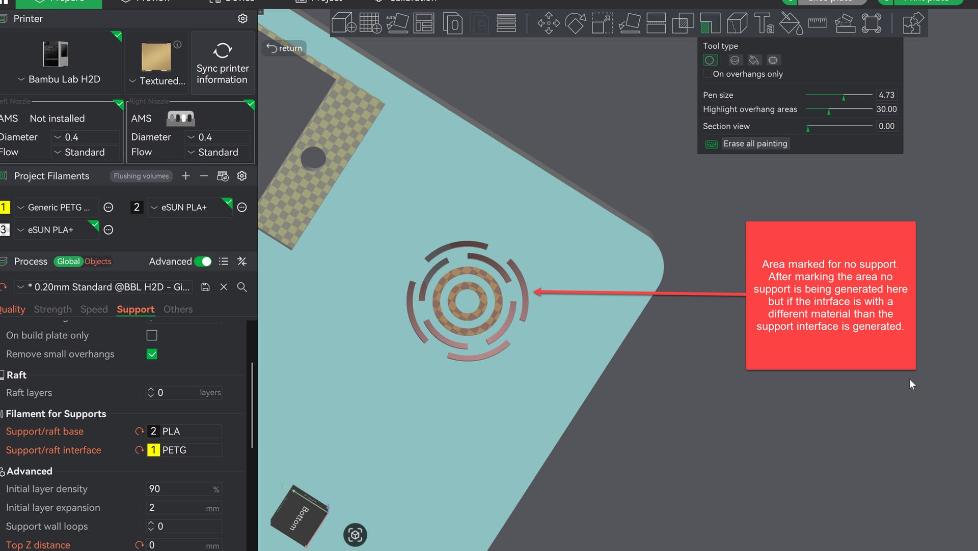

While marked out areas that I don’t want support on them do not have support, they do have some support interface that shouldn’t be there.
