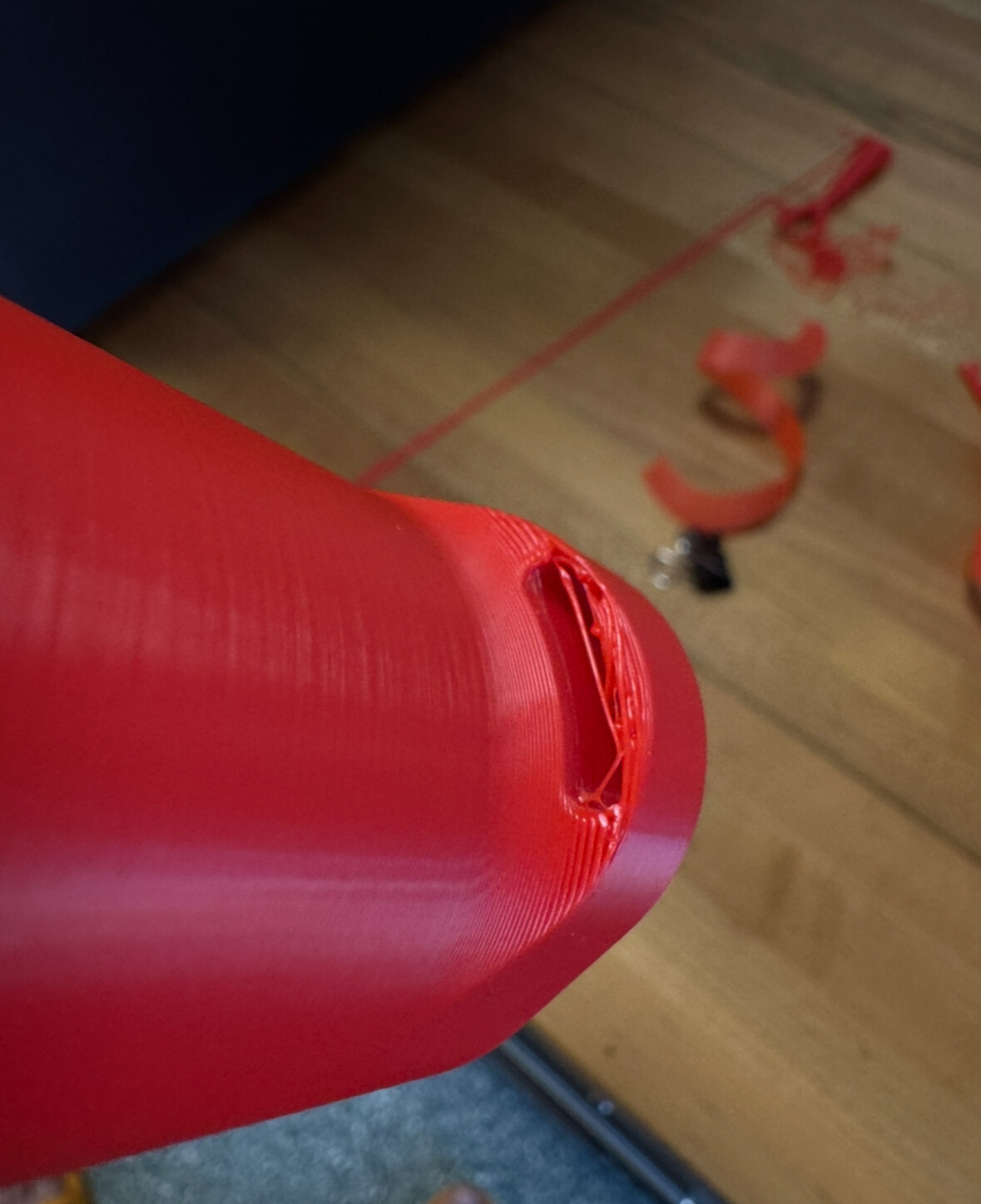

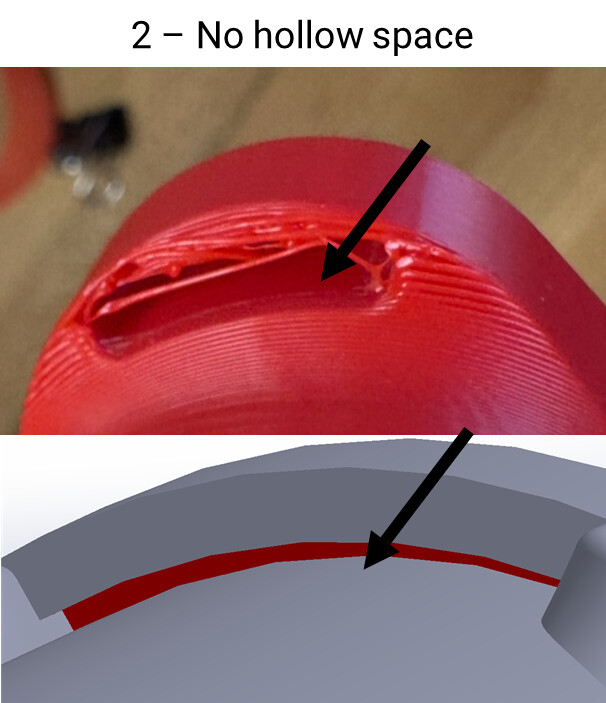

My prints on the P1S and Bambu brand filament using stock settings result in the part having a frayed/stringy appearance where there are supports. It’s as if there should be a boundary layer that is missing.
I get this regardless of filament type.

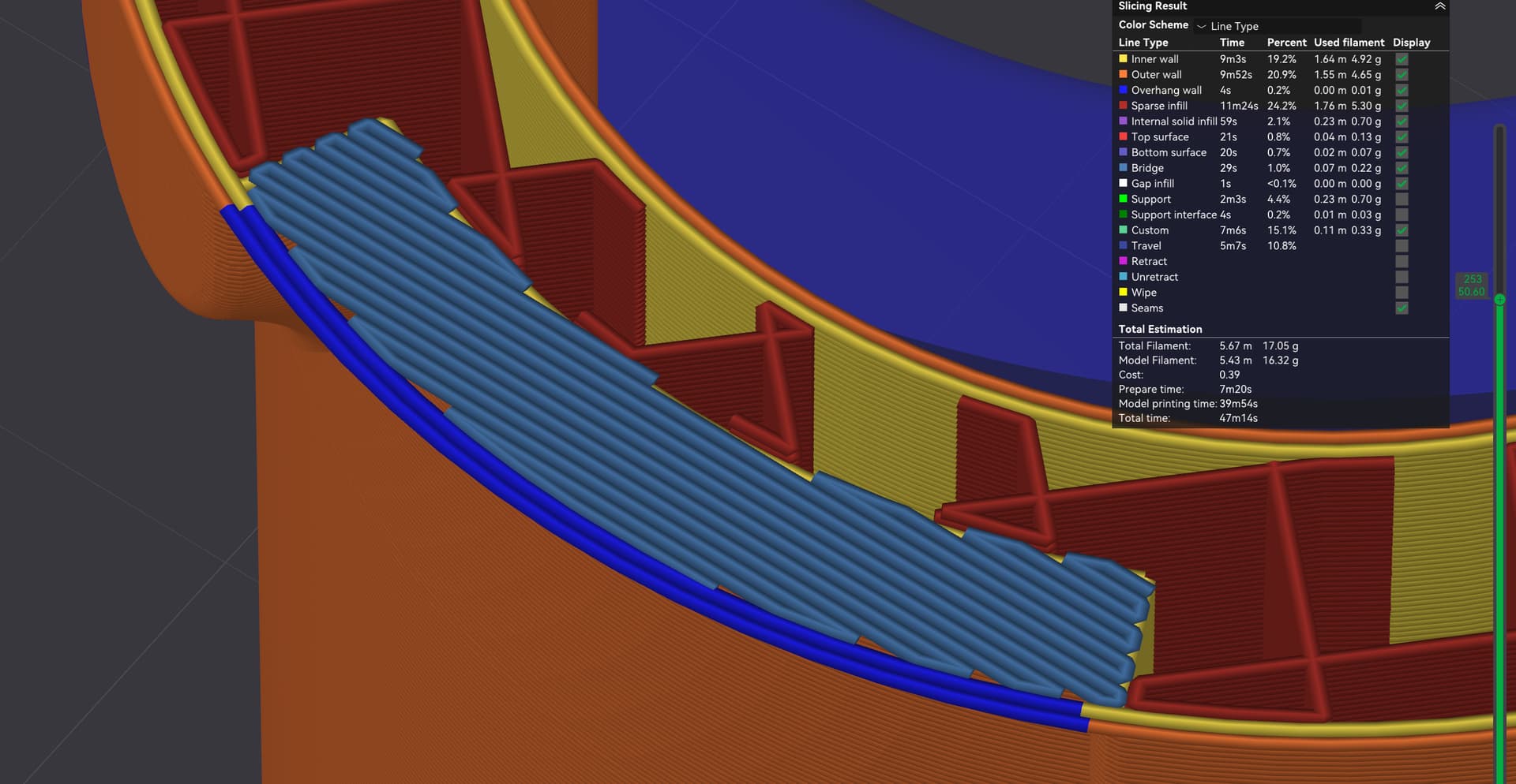

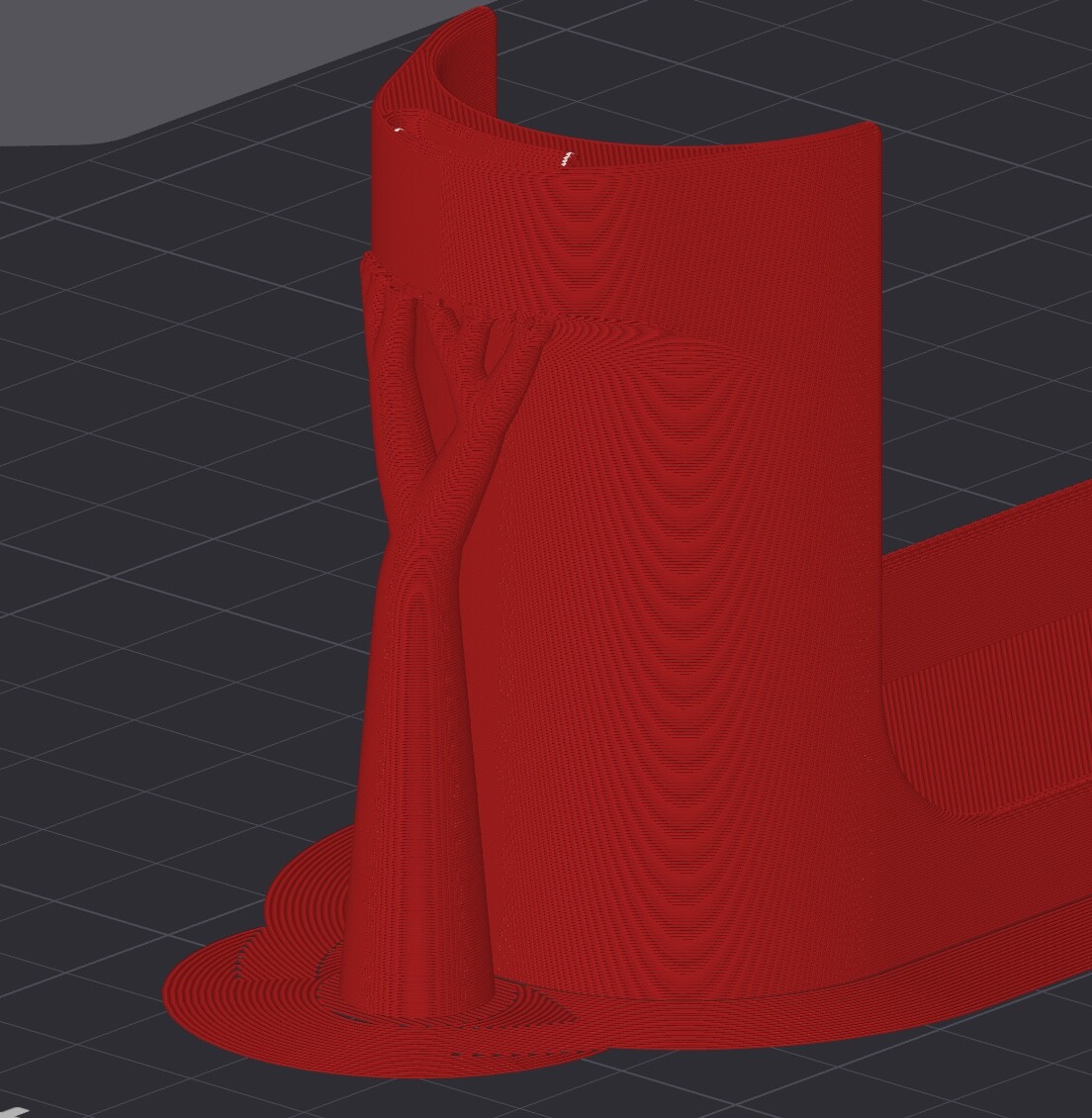

Hi,
Can you share an image of a slicer preview, where one can see the supports? I know the problem, but I’m unsure how it prints.
Thanks
Here is a screenshot of the support tree
Hi
Ty for the image. It’s clearer what can be causing the hairy or stringy surface. Nevertheless, I don’t see if the support surface is solid and/or planar or has a hollow space within and/or an angle. In the case of a hollow, what is the solid region thickness?
Also, do you have AMS, and if so, PETG filament?

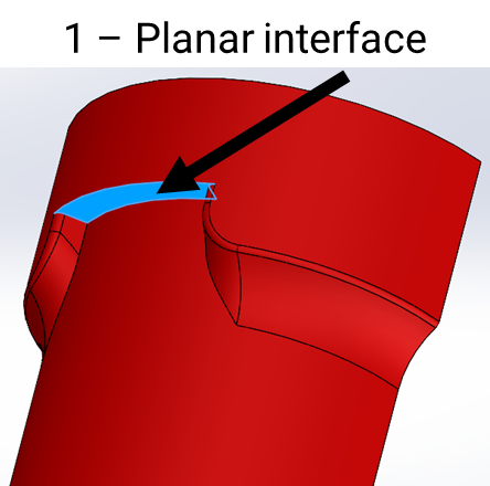

The support surface is planar, flat and not angled.
It has hollows only in so far as a tree support structure has gaps between the branches.
Yes, I use an AMS.

This print behavior I have seen with all materials I have used so far - PLA basic, PLA matte, PETG and ASA.
It’s as if there is no skin on the underside of the part where it meets the support surface.

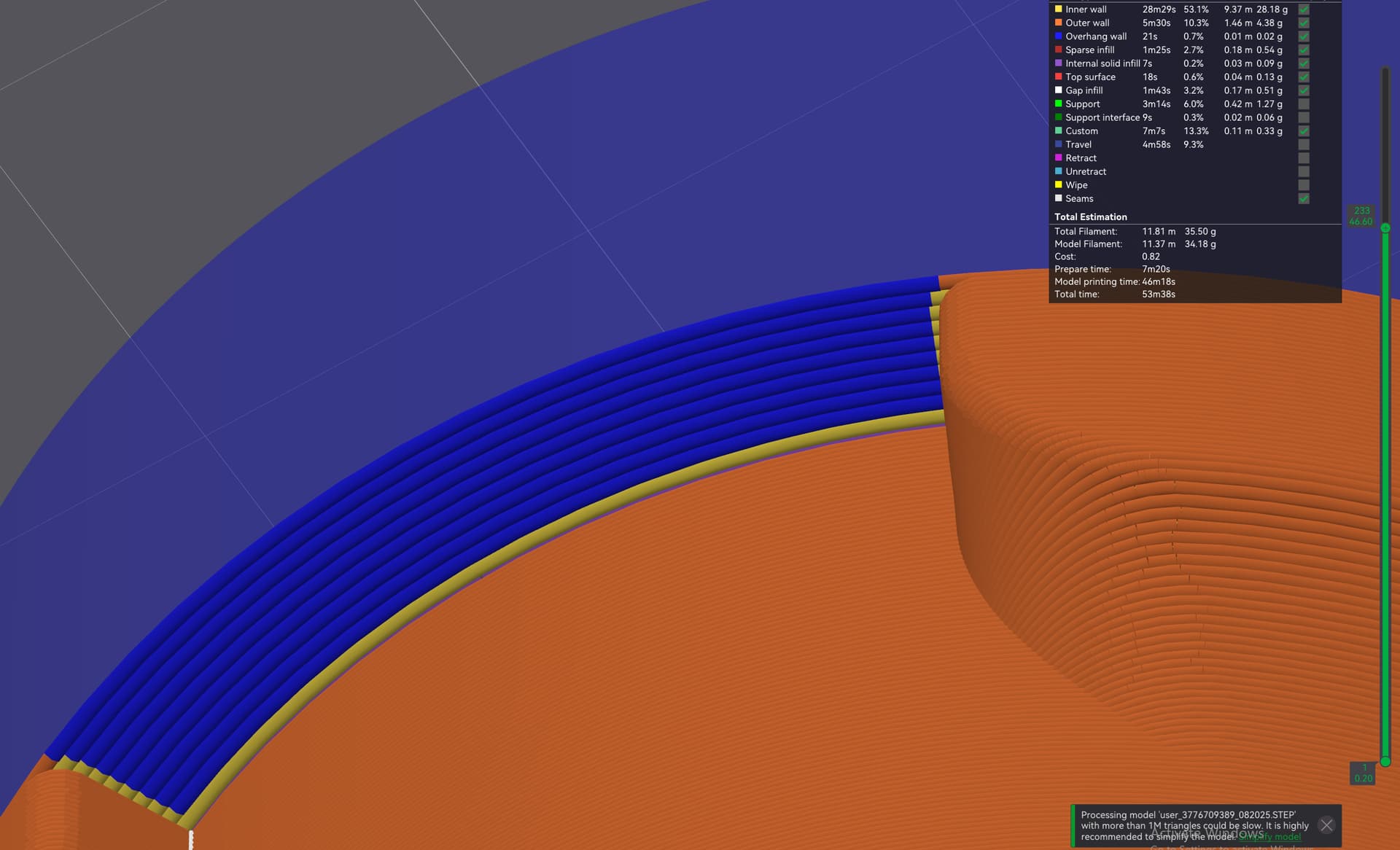

What I can see from your print is that the outer walls print well, and strings appear in the lower radius lines. If true, it means that the overhang walls printed well, but they fail, which may be related to the orientation that occurs at the bridges, i.e.:
A possible tweak is increasing the wall number in that region, eliminating the bridges. I.e. you can print all as an overhang wall, with the path following the radius, and less likely to not hold:

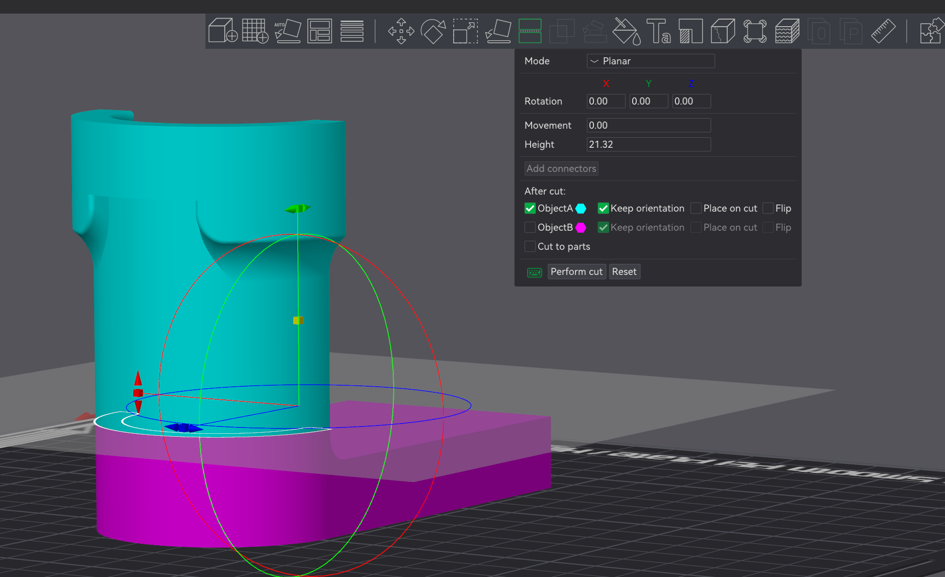

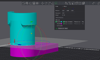

Of course, you should focus on the most likely ones and change one at a time, as you did (I guess). To avoid wasting filament, I would suggest making a smaller test file by cutting your model to use in tests, e.g.:

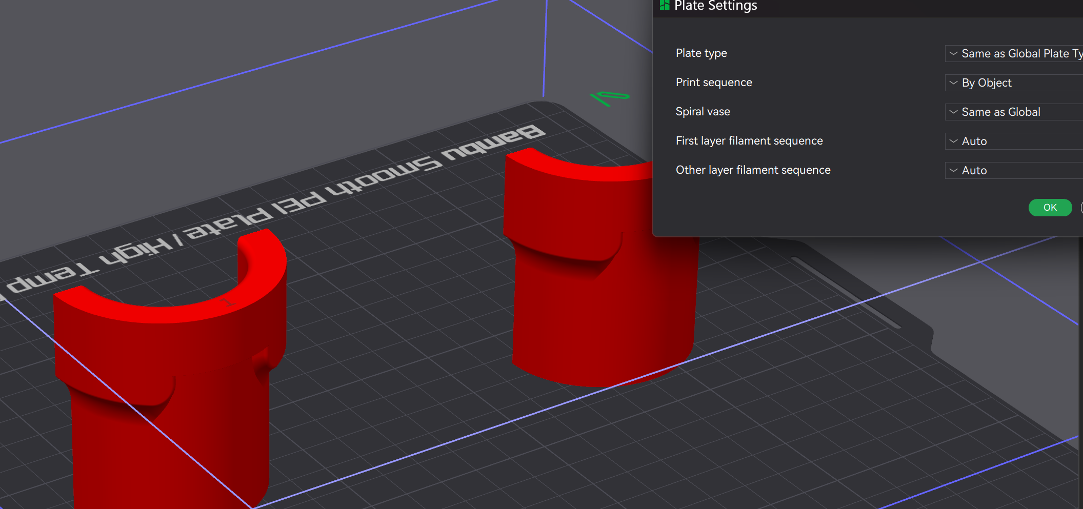

Using multiple files in one plate, use the print sequence by object.
I also find it useful to mark the prints to remember which matches a specific test, e.g., use BS text to add a number, a marker at the end, or a label.
