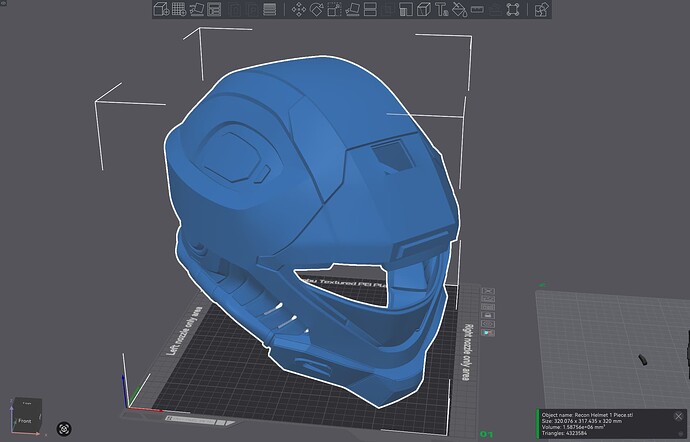

Here is a screenshot showing the helmet pre-slice, with Bambu studio not giving any warnings that the model is over the right nozzle only area.

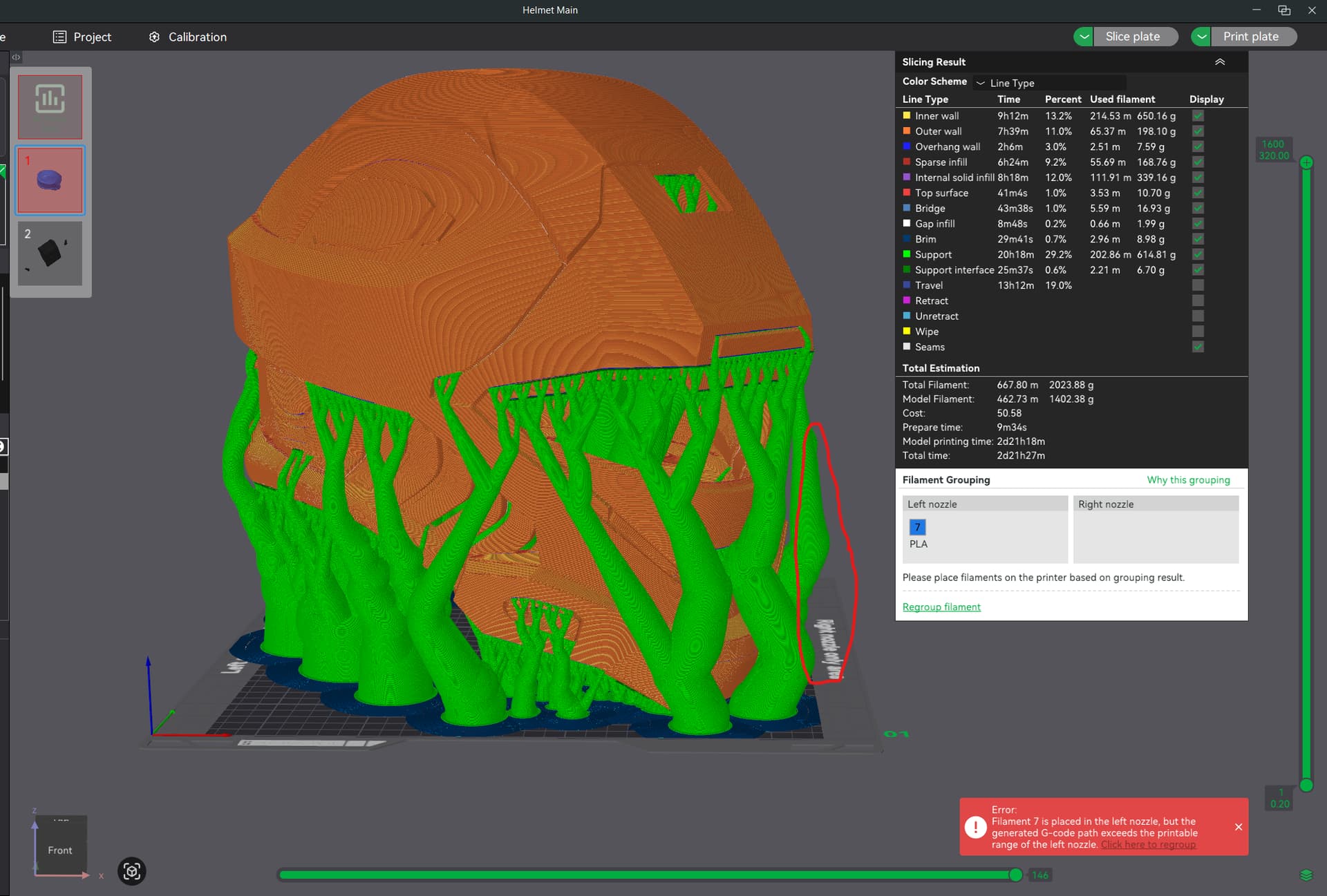

Here is after slicing, you can see it is generating support in the right nozzle only area, it seems like there is more than enough space for it to keep the support within the left nozzle area if prevented that from happening.
