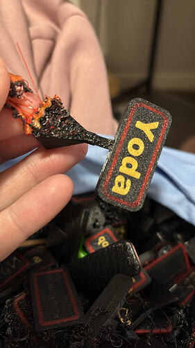

A few weeks ago I was printing custom multi-color PETG coral name tags on my Bambu A1 with a 0.4mm nozzle, and the text quality was fantastic. The lettering was crisp, the borders were clean, and the overall finish was exactly what I wanted.
The attached Yoda tag photo is an example of the quality I used to get.

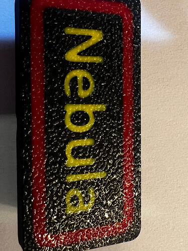

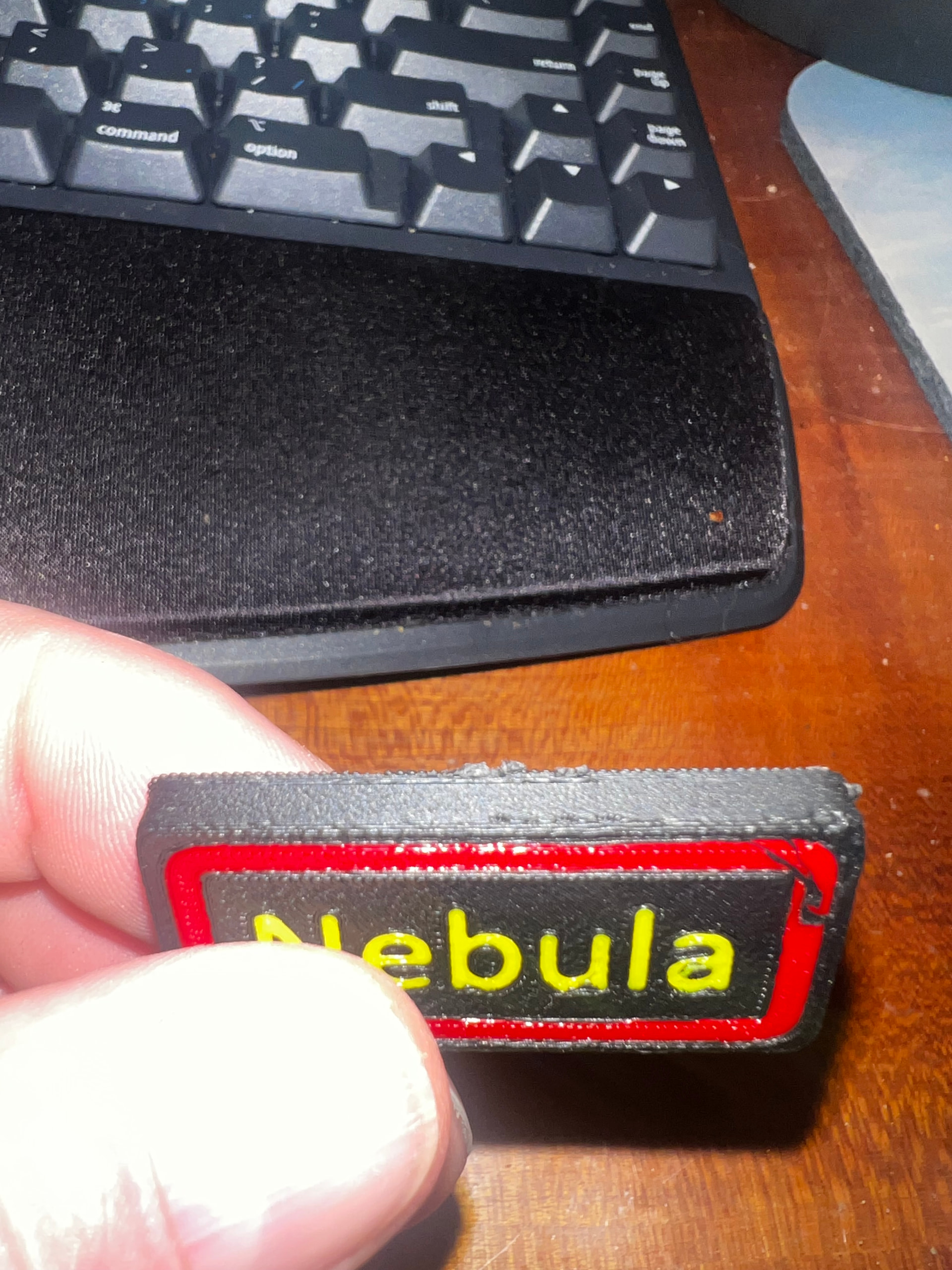

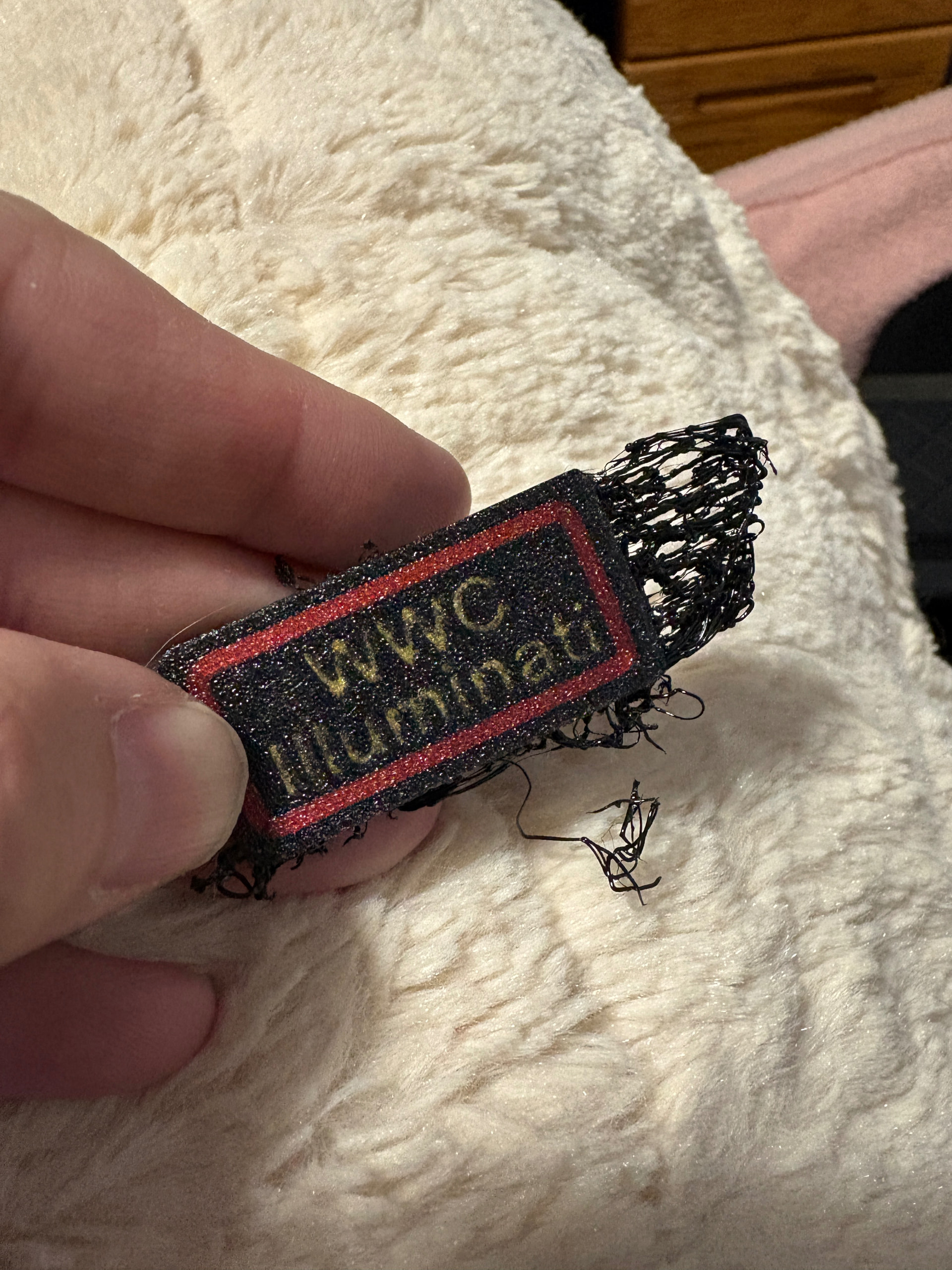

At this point I’m attaching:
  • Photos of the original prints
  • Photos of current prints
  • The 3MF file (below the pictures)
Please take a look and tell me if you see something obvious that I’m missing.
I know these tags are capable of printing beautifully because I’ve already done it. I just can’t figure out what setting or combination of settings I’ve lost.

Why is your line width at 0.25mm? Put it back to normal as its most likely the cause of the problem with the text.
I literally just tried that tonight until then it was normal
I saw a YouTube video today and thought id give that a shot cause nothing else iv tried workes

It looks like you have also changed fonts which will have a huge impact on the text quality.
I did and I think I switched back but I don’t know I have tried everything I can think of I really need someone to take the file and look at it and tell me what fix cause at this point I have no clue which way is up

I’m a broken record on moisture in filament but whenever something used to print properly and now doesn’t, it frequently can be water. With printing in PETG, it’s even more likely since it’s a water magnet it seems.
Have you dried your filament? How do you dry your filament? How do you store it after drying?
Not all symptoms are exactly the same since much depends on the model, ambient temperature and humidity, etc.
Moisture may not be the issue but trying to parse what you said in the OP, it sounds like it might be an issue especially since it sounds like you’ve eliminated a lot of other possible causes.
Spoiler - this person’s issue looks like it was water.

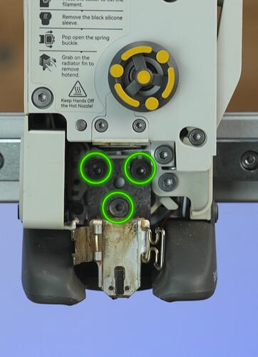

Idk about all of it but this
looks like it was printed with the nozzle way too close to the bed and smushed the black to death, many possibilities of why:
  1. selected textured plate when it was a satin/smooth, internally the slicer applies z-0.04
  2. preheat the bed for a few more minutes before starting the print, helps the heat expansion even out
  3. the A1 has a well known set of screws in the hotend that get loose and will foul your Z offset autocalibration, check this and see if you’re tight, ESPECIALLY if youve never checked before.
remove those 3, gently fold down the plate [mind the wires], get the smaller hex driver and tighten these 4
So I know all those screw are good and tight cause I tightened them the other day but how do I heat the bed a little longer? Also it sounds like you’re saying do somehow put all the settings back to default but I don’t know how to do that either….
While you’re in the slicer setting things up, hop to the device tab, type in 75 hit enter
And in a few mins when you’re ready to send print, it’ll have the bed really well and evenly heated

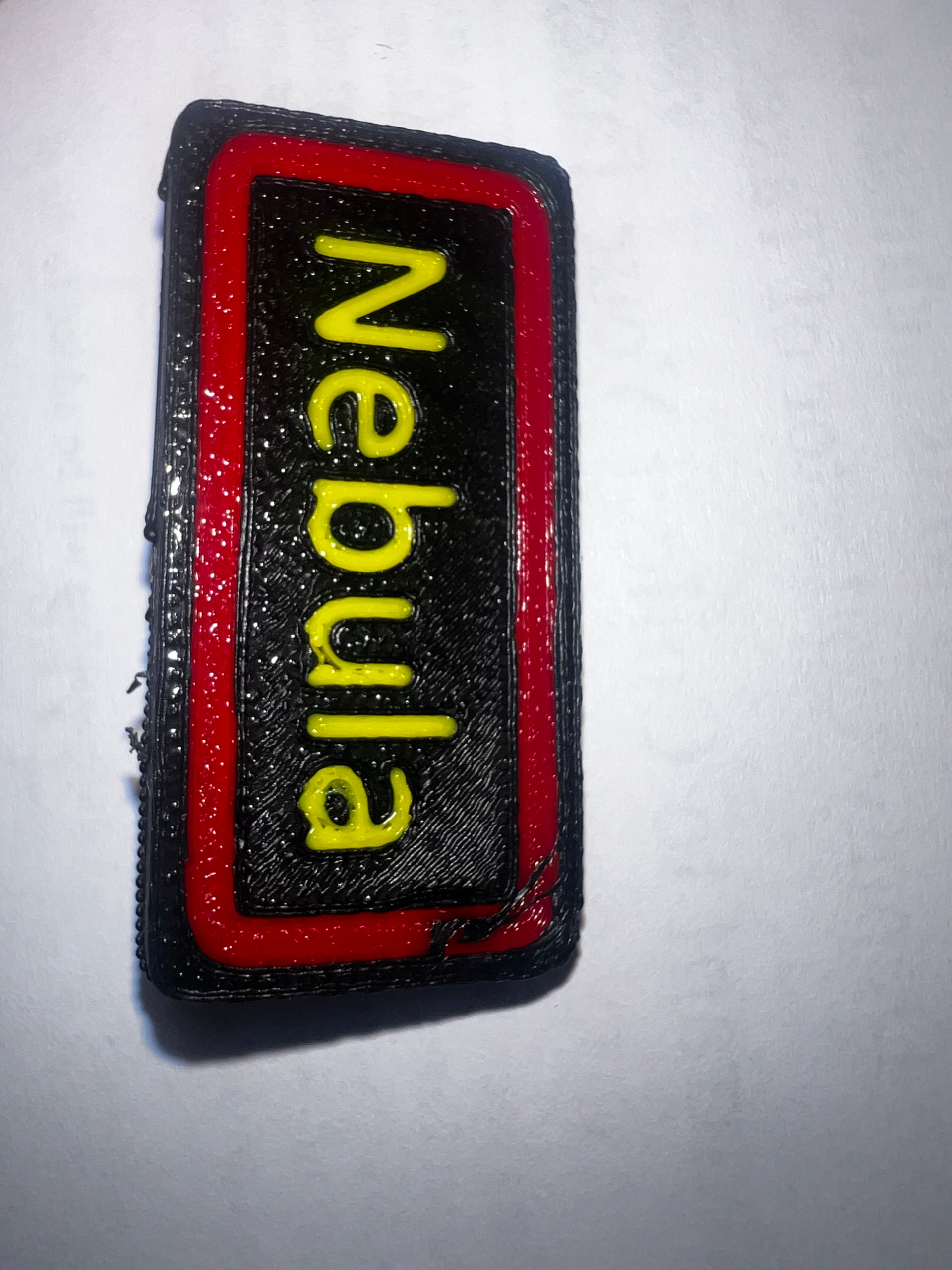

I printed this on my H2C using PLA (since I don’t have the colors in PETG). I did this two ways: importing your file into an existing blank profile and select to just import the geometry only and the second to open your 3MF file as a project. See the attached photos, the version where I imported the geometry printed perfectly (see attached) whereas the one printed from your profile had print artifacts on the edges and the lettering.
So, you may want to try what I did. Create a new project, add a simple primitive (this forces the import to prompt how you want to import the file) and then import the 3mf.
The Above is the version where I imported the geometry only. The lower two is opening the 3mf as a project file
