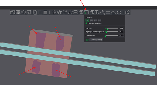

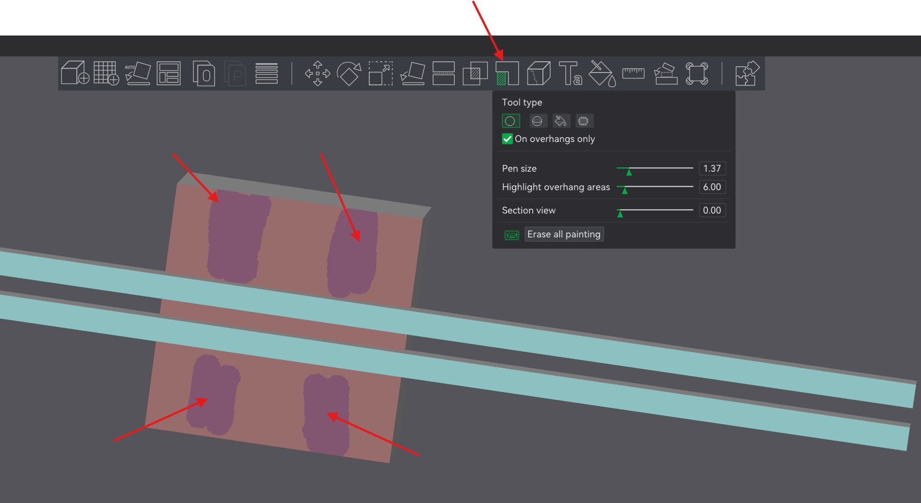

To control support and avoid expansion, set type to manual and style to snug:
The snug style doesn’t expand to all overhang areas:
Snug Support
And the manual type allows you to define (“paint”) where to place the support:
Which hopefully can lead to your intended print support:
