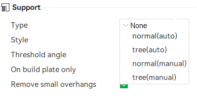

In order to enable support I need to click the check box labeled “Enable support” and then I have to choose support type in a separate drop down box. If I want to use any Type other than normal(auto), choosing support is a minimum of 3 mouse clicks.
It would be much simpler if the “Enable support” check box was removed and in its place, the Type field changed to the following options, in order from top to bottom:
None
Normal(auto)
Tree(auto)
Normal(manual)
Tree(manual)
This change takes the process of enabling and selecting support Type from 3 clicks to 1.

Now, it is only one click if you want Normal (auto), which often works pretty well.
It is only three if you want a different type.
With your proposed change, it is always two clicks, one to see the drop-down list and another to select the type.
Good point! Here is an option for a single click for all…
