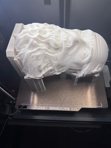

I’ve got a largish print that has now failed twice in a similar way after a couple of hours. Specifically, tree supports are losing adhesion, breaking off, and the rest of the print isn’t doable.
My print bed has been thoroughly cleaned. In the video, the brim on one support starts to curl and then gets knocked over and a second one then follows.
Some searches suggest that I can’t set the brims to be bigger. Would increasing the bed temp 5 degrees be an appropriate option? Other suggestions?
Basic elegoo pla which I’ve had no other adhesion issues and which has been dried. Humidity in my AMS is appropriately low.
Thanks for any help!
P1S, 21.5 hour print. Failed after ~7.
Using gyroid infill, don’t think that matters here.

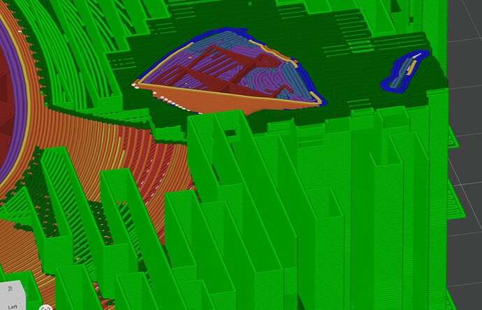

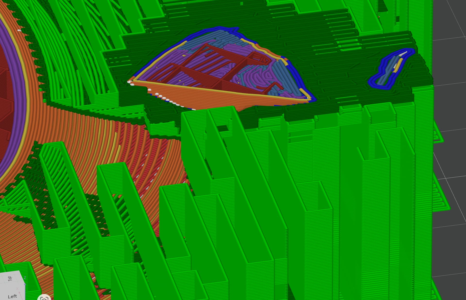

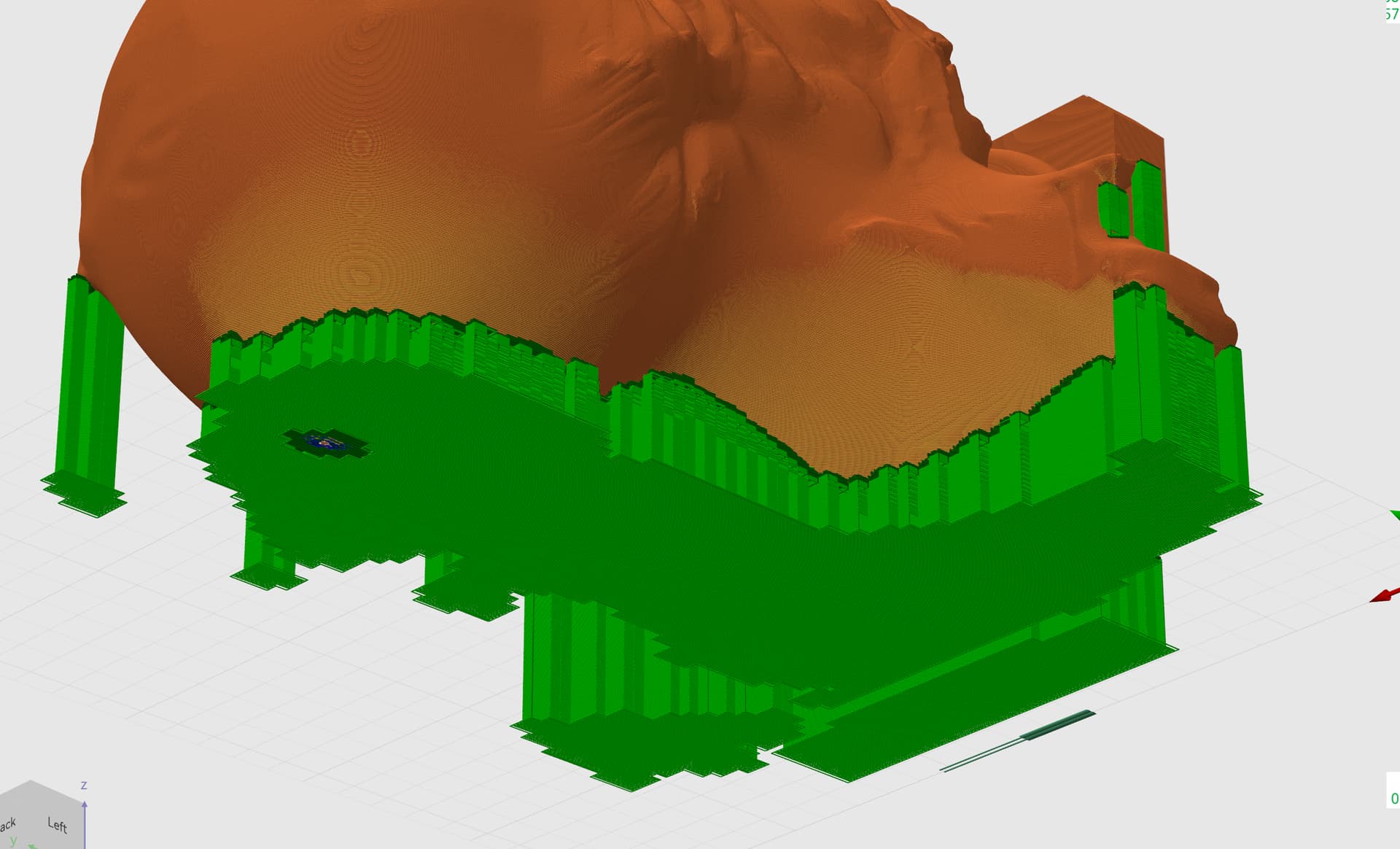

I’m printing this at 240cm height. The failure is at a support under the beard.
I’ve played with some different orientations but they’ve all required more supports.
Okay, at least I can see why it’s problematic. The support doesn’t fit properly under the beard.
With such extremely narrow and winding support, it would probably be better to switch to normal. Of course, it takes more work to remove the support, but it ensures that the beard will be printed.

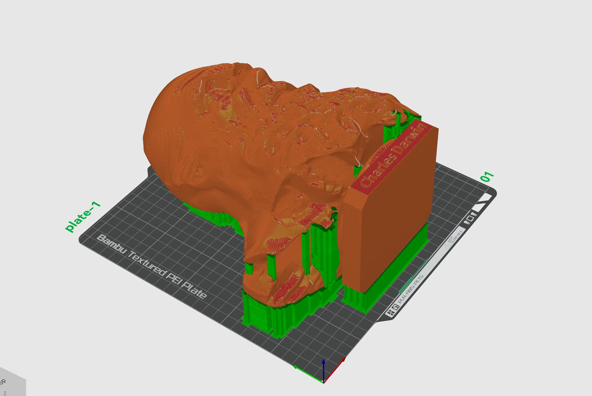

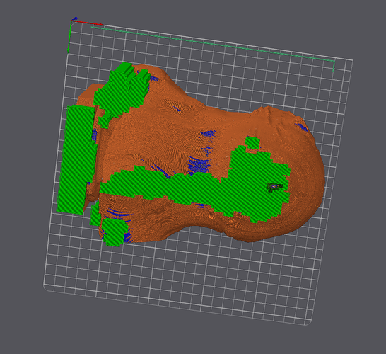

If you ask me, I would do it completely differently: Put the head on the back, i.e., turn it 90°. Then use the normal support, not tree. Then you have all the ugly spots on the back, but the front and face are perfect.
Just look at how much support there is - it can’t possibly fail. Sure, as I said, you may have to do a little reworking on the back, but the front doesn’t need any support at all.

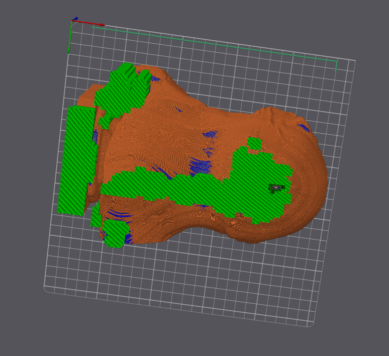

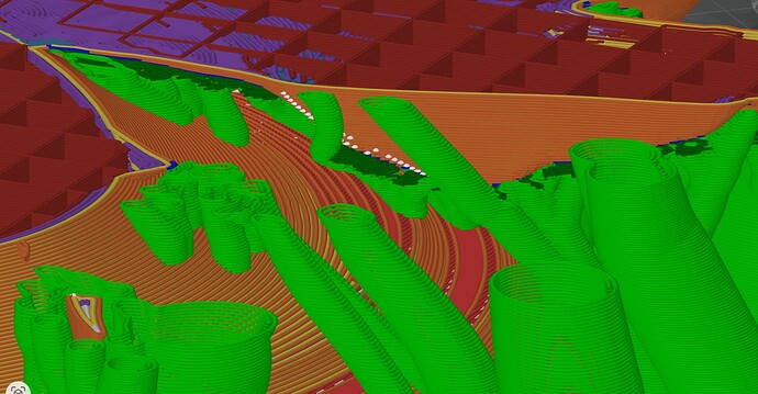

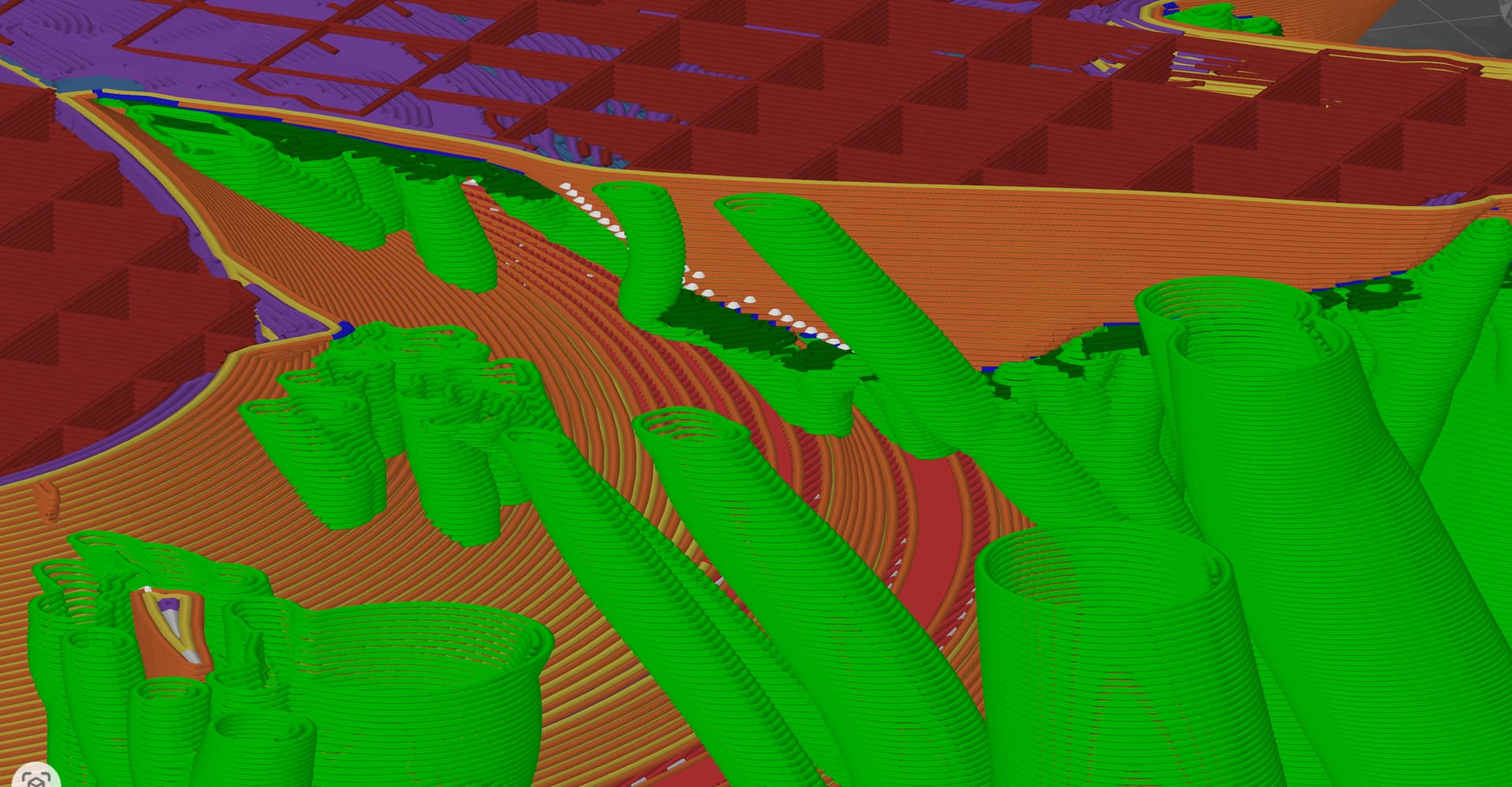

Switching to the orientation you recommend, I’m still getting a much different support pattern:
I did cut off part of a shoulder to reduce the model a bit but that wasn’t in a place that should matter here.

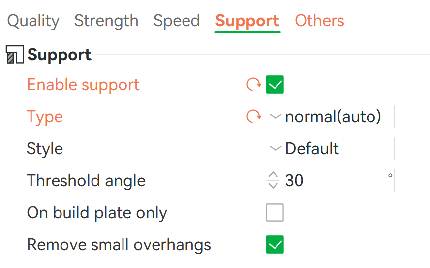

I used those settings, maybe that will help.
Yep, that was it. It was set at 15 degrees–which I’m pretty sure I didn’t do.

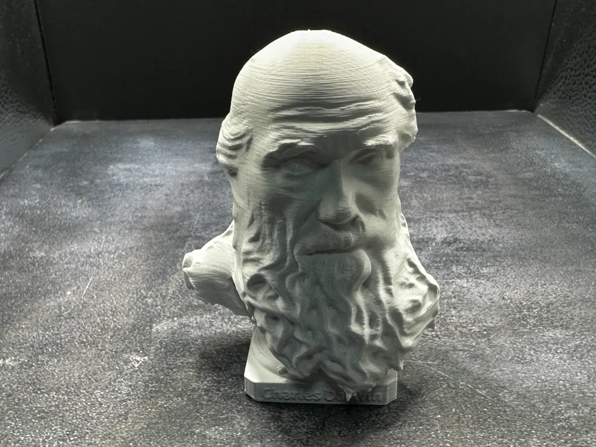

Well, the reorientation worked. Have to wait until tomorrow to start clean up but I’ve at least got a print to clean. Thanks again.
