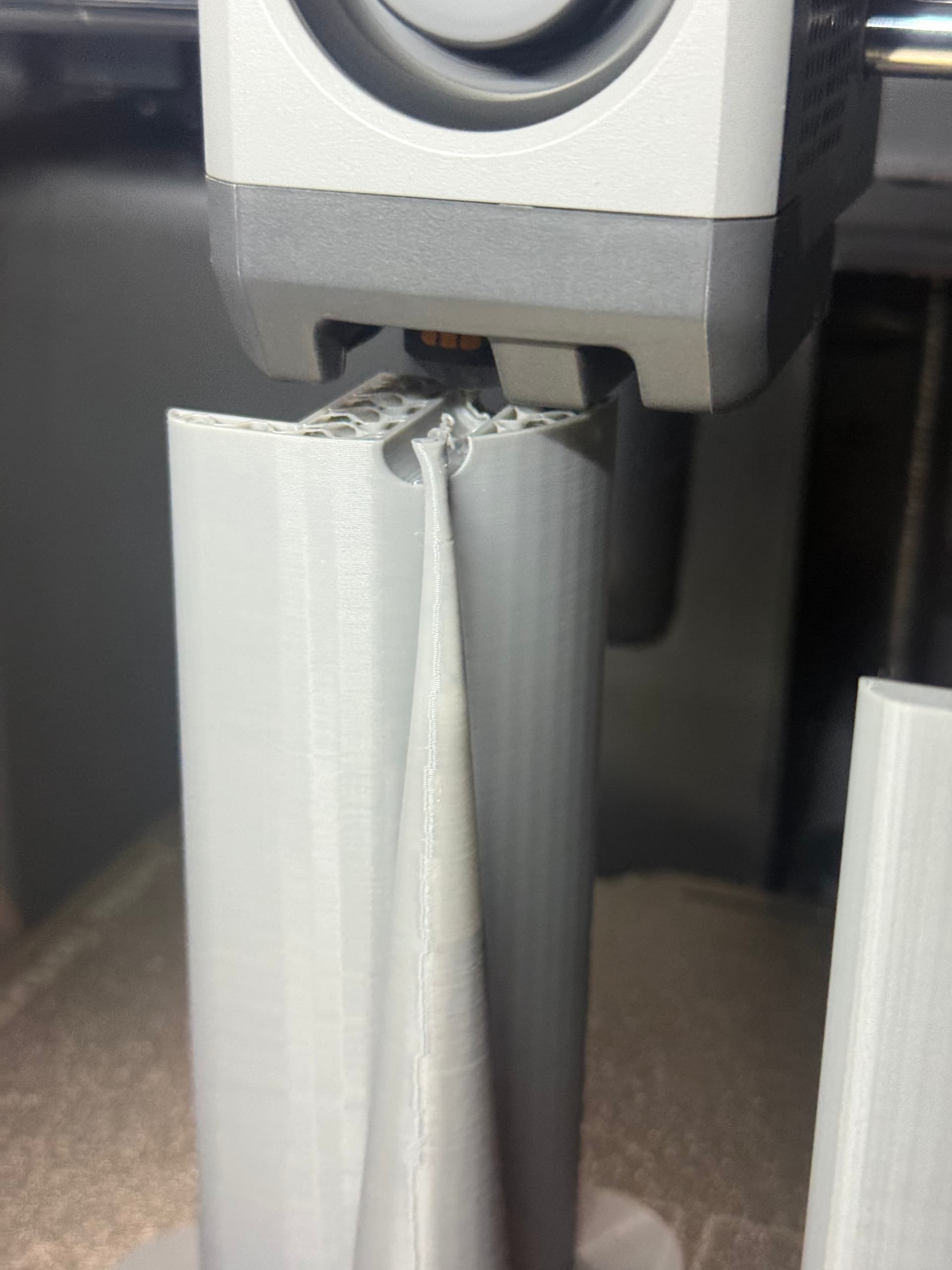

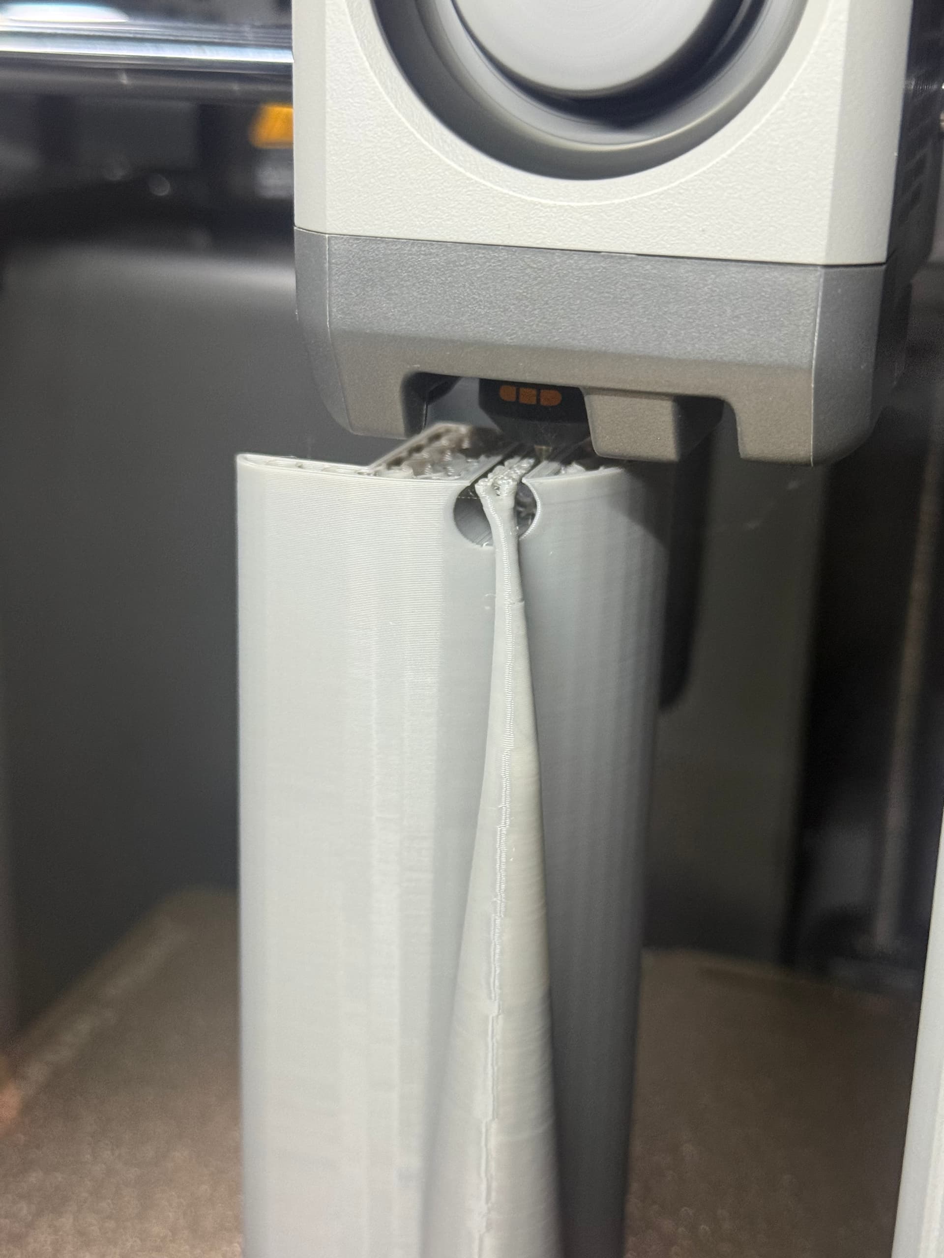

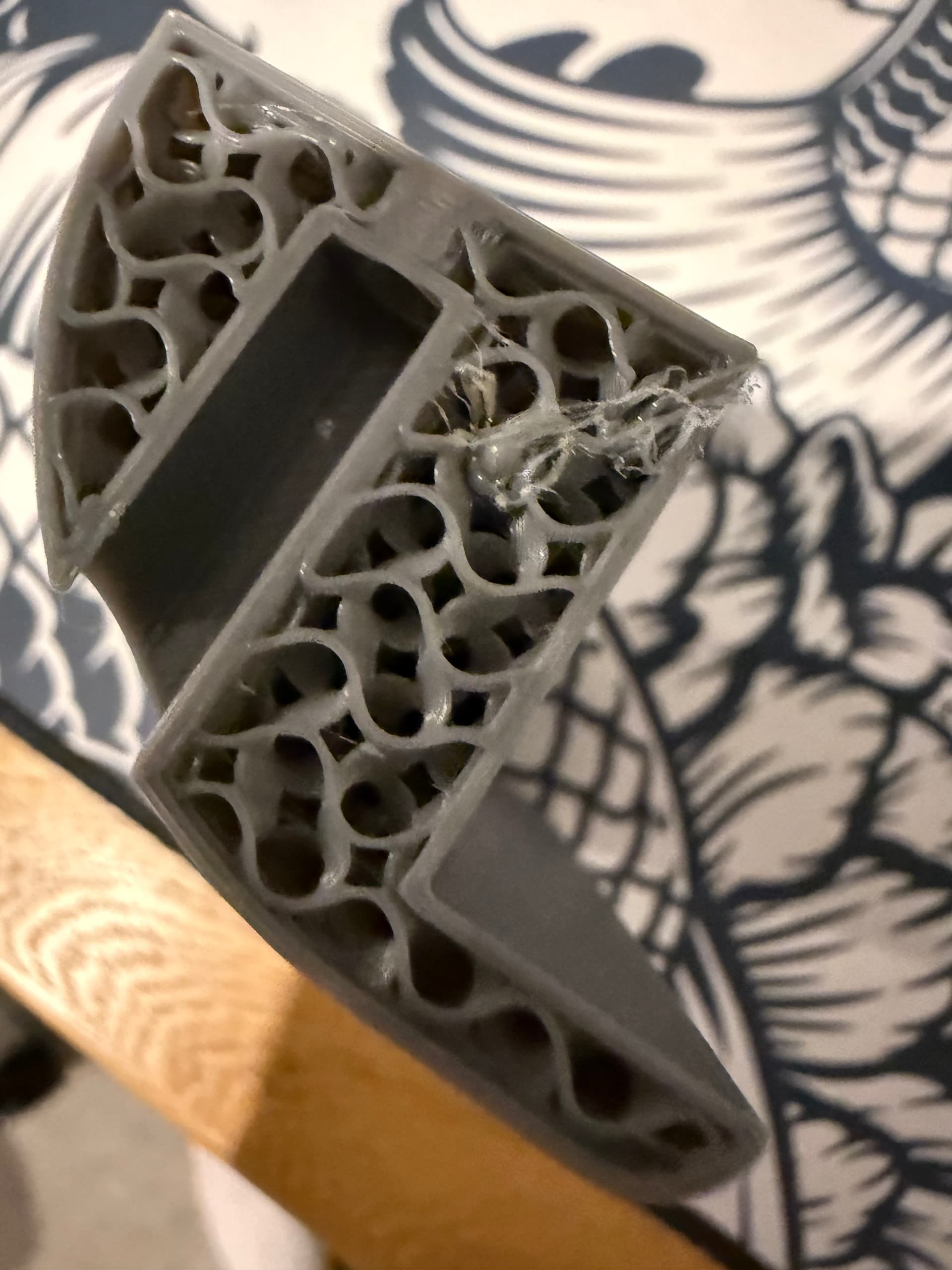

So short story is had a p2s a few months still very beginner but understanding basics, but I’m trying to print taller prints with screw holes, the slicer auto generates tress supports but it’s getting up to that layer and not generating enough due to being small screw holes and becoming lose causing it to clog and pull the print off the plate. Does this sort of print need support given its circular or can I just change support type or a setting to fix this? Any help appreciated

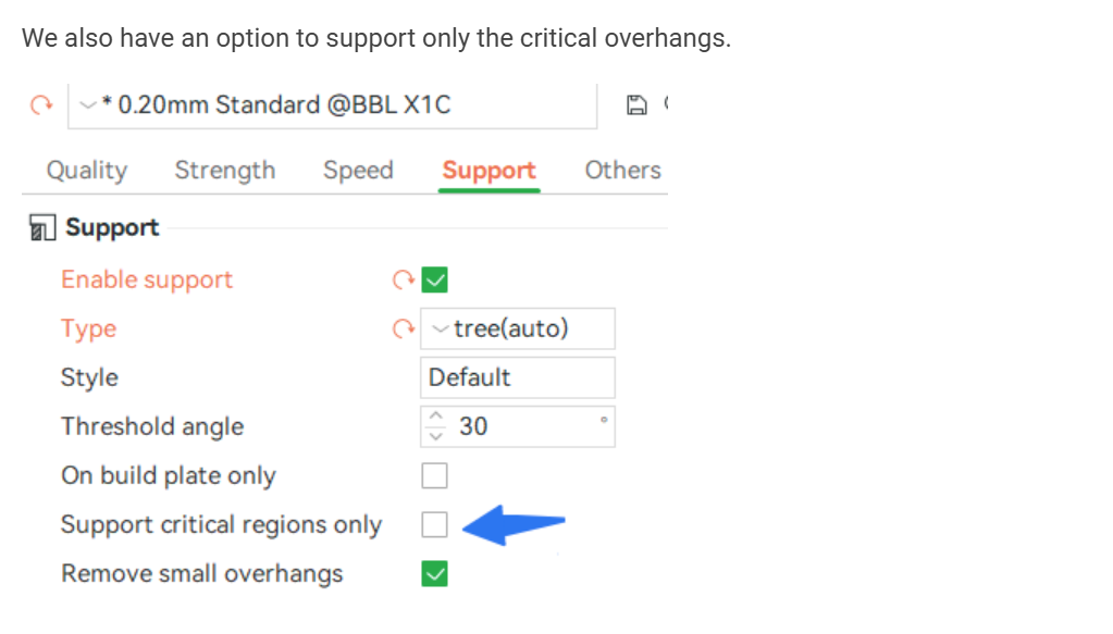

You can try changing the “critical region” setting.
If the support goes away you probably don’t absolutely need it for the print to complete. Finish quality may suffer though (and possibly strength). :thinking:
