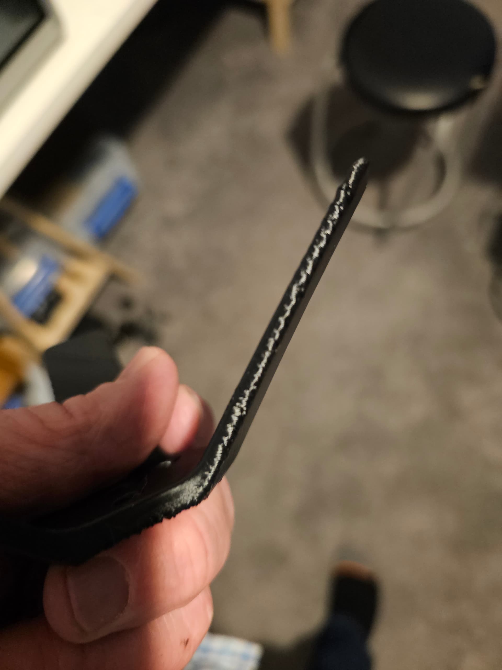

Surface issues on 45 degree angled print, using Amidex PA6-66 on x1c
Need a little help narrowing down a problem I’m having printing with 3DXTech’s Amidex PA-6 66 while I wait for them to get back to me with an x1c profile.
Want to start off by saying that overall, I’m extremely happy and impressed with the results I’ve been having so far. Most of the parts I’ve printed for my HMC have come out superb, but these are all relatively simple (straps, clamps, gears, knobs, etc). The issue I’m having is surface problems on one particular part that is printed at a 45 degree angle, and all the tangs on the part are also 45 degree.
I’ve eliminated moisture already (dried 12 hrs at 70c in a Sunlu S2 then an additional 12 in the AMS at 65). I live in a very dry environment (desert southwest, USA) which normally is in the 7 -15% humidity, my AMS shows between 1-3% (the hygrometer is always stuck at 10).

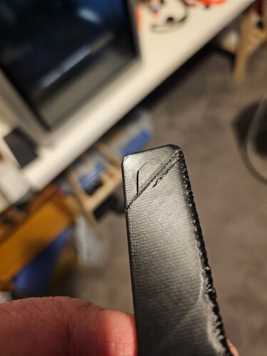

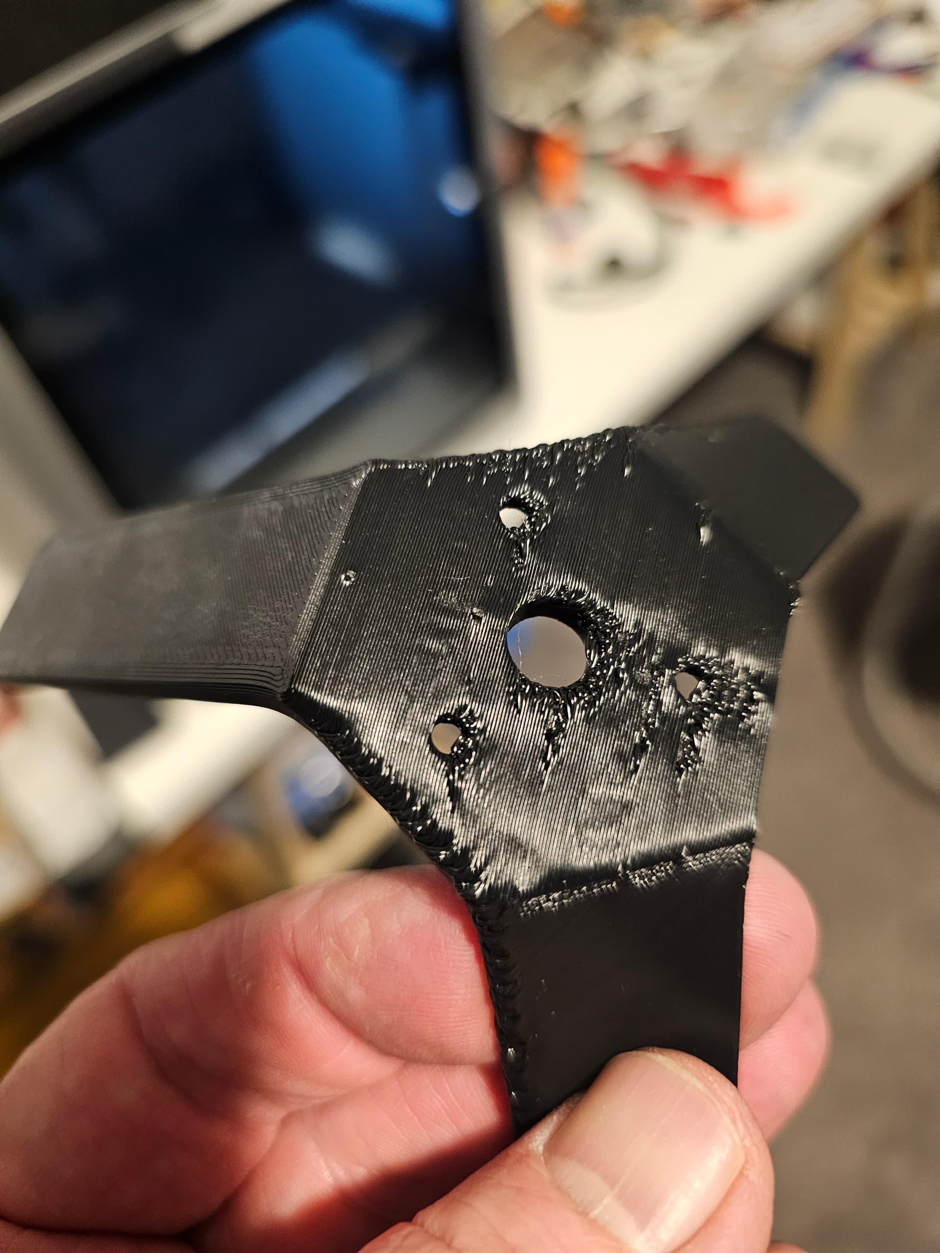

Printing with their PA12 profile modified for the temperature’s recommended for this material (in this case, bed at 70, extruder at 265 and also tested at 270). Here are the images of what I’m getting

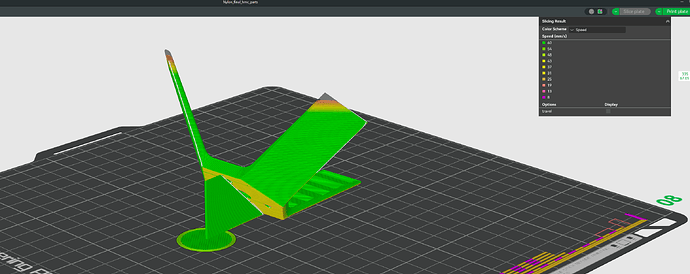

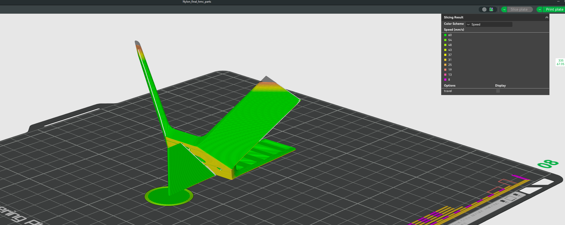

this is the part in the slicer for clarity from yesterday’s testing
In this image from yesterday, I did notice that the areas that are having the problem are where the slicer was slowing it down (I had left the overhang speeds default, here those areas are printed at around 37). The images above are from today’s test, where everything was set to 60, and frankly, no change (maybe even a little worse). Usually, my experience has been that surface issues like this are caused when speed is faster, not slower, so I’m scratching my head a little.
I’ve printed this same part in other materials, like PC, PLA and ASA, with no issues at all at default x1c speeds (at even steeper angles, like 37).
Is this just a matter of speed? I hesitate to slow it down even further (as the areas from yesterday’s test were slower) or do I need to look at something else?

I have not printed that particular material so only a few (maybe even useful :wink:) observations.
It looks like the speed changes are caused by “slow down for overhangs”. So it may also be a case of excessive overhang angle for the filament.
You could consider increasing the angle at which supports are generated, try to slow down even more on overhangs (say 10mm/s) and/or decrease the layer height. The latter may be the most promising one if done deftly but carries the risk of nozzle clogging (especially if the material is fibre loaded).
The underside indicates that the support distance is a bit high. Always a tricky trade-off between quality and ability to remove. I am not sure what material would be suitable as a dissimilar material support interface but it would produce quite a bit of waste on an X1 a well.
While your drying is extensive, it may still not be enough. When I use high performance material and without a high temp drier, I usually leave them for up to 60h in 70°C.

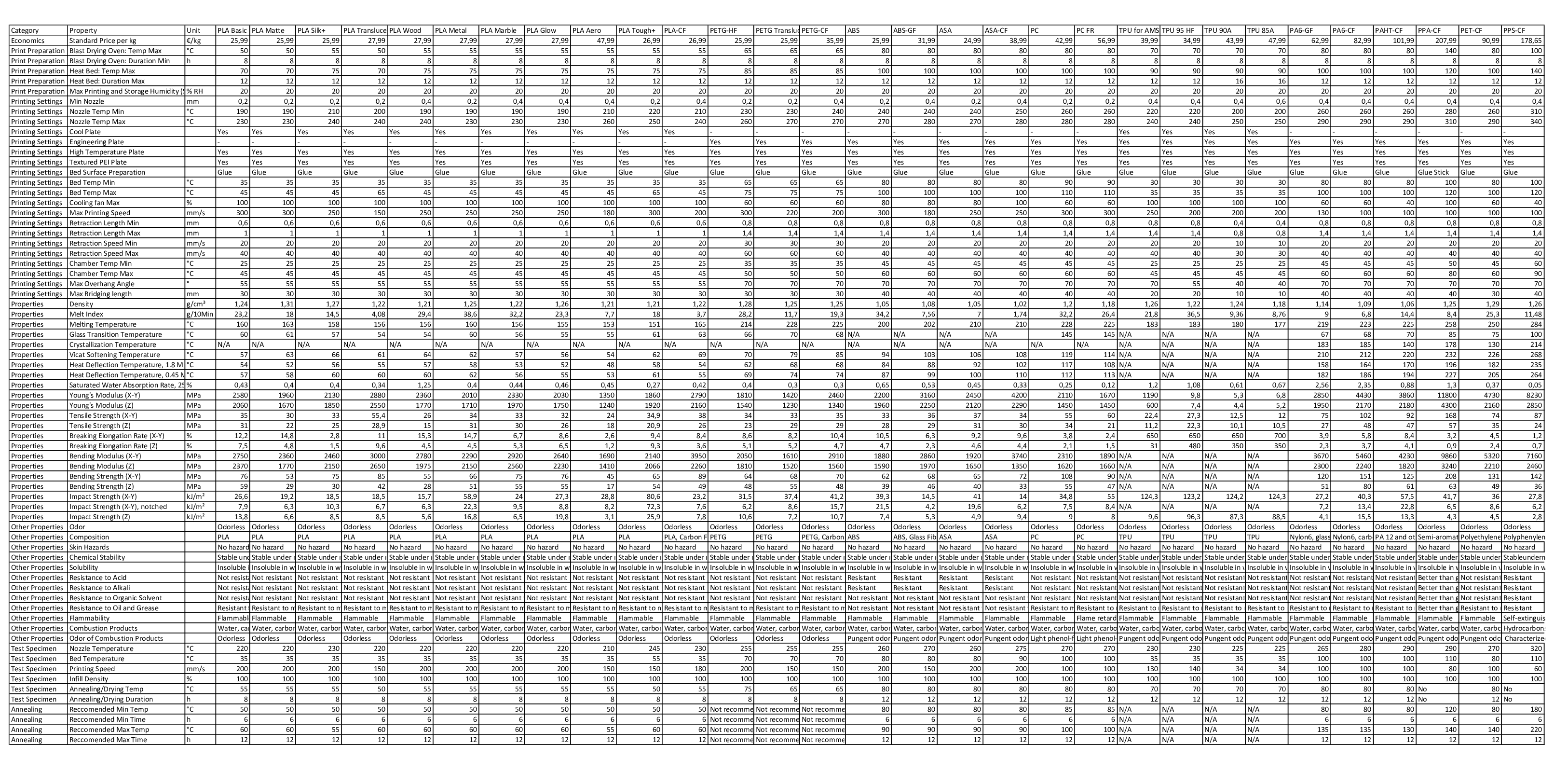

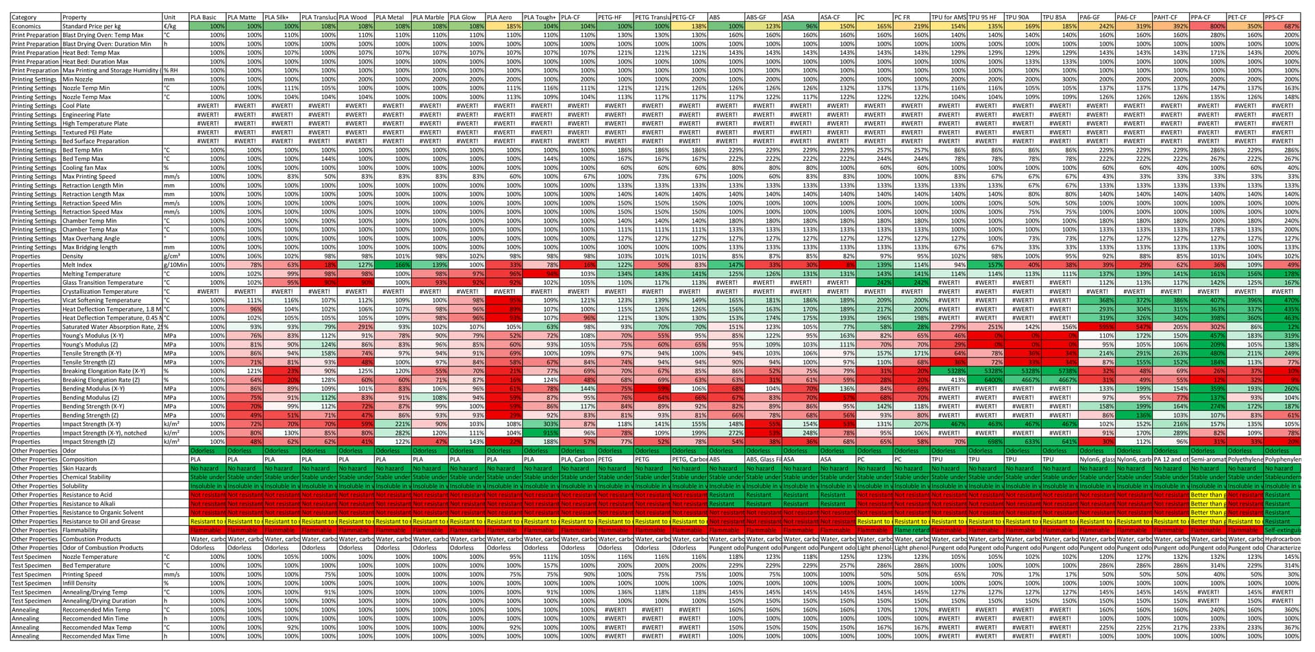

I think you may also find an overview of Bambu filament properties interesting and helpful. That may give you an opportunity to review your material choice. I have a slightly dated dataset which I’ll post once back on the laptop. Sadly pics only atm. Some surprises in there…
Step 1: Raw data. Unfortunately, I can not upload pdf, xls, etc formats. Only png/jpg.
Note that the data is from last year, i.e. still the original PETG Basic.
Step 2: Comparison to PLA Basic.
Some interesting findings in there…

In this profile, they raised both the bed and nozzle temps (100 for bed, 280 for nozzle) and hardcoded pressure advance in the filament start g-code. @EnoTheThracian they also brought down the speeds in those areas down to 10, while keeping everything else standard and no supports
There are probably other settings, but I’ll investigate further and report back. They showed me pictures of a part similar to mine, and it looked great.. so fingers crossed!
I won’t be back home until this evening, but even now I can tell the difference, looks like this will work great
