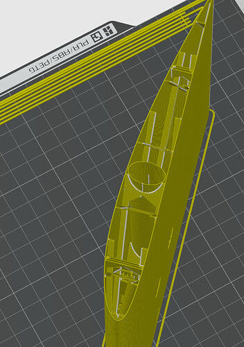

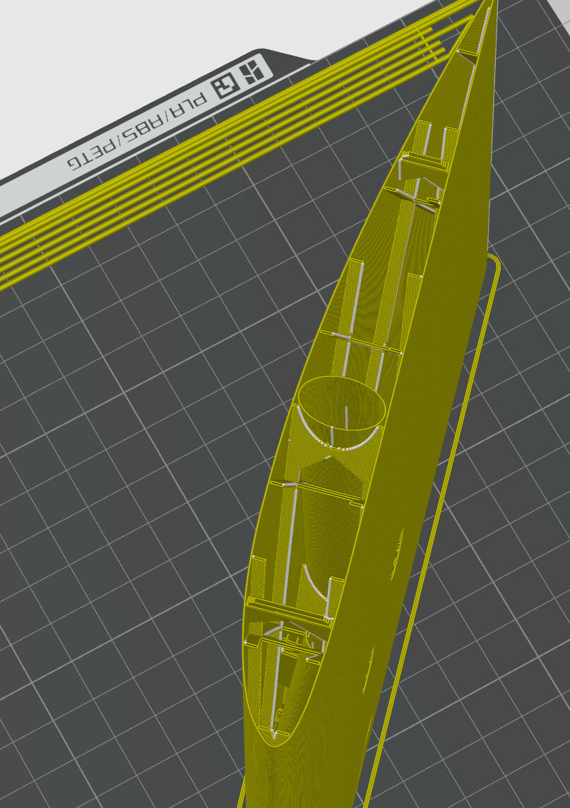

Its solved for me thank you
slicer: Even-odd
strength: detect thin wall
Infill %0
Top 0 (depends of rc plane part )
Slice gap closing radius : 0.023
