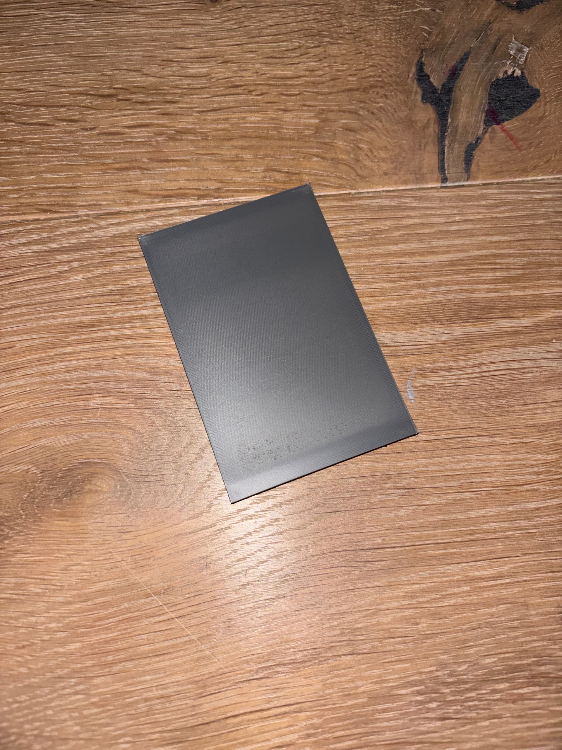

Would you say this looks like wet filament, incorrect ironing settings, or something to do with flow calibration, extruder, etc.?
The two most important questions first:
  • Did you perform a Flow Rate Calibration?
  • Did you perform a Ironing Calibration?
One of them “No”? Then there’s no need to give tips yet; you need to get the basics right first. For ironing, it is absolutely necessary to calibrate; you cannot use the settings from others.
I already did everything. Still have this problem.
But then the problem should already occur during the ironing test, right?
Do you still have the Ironing Test? Can you post a photo of it? Did you perform the ironing test specifically for the filament you are currently using?
It’s about taking it step by step. :+1:
That is the problem i dont understand because. Here you can see nothing of the problems.
Post the 3mf so we can see settings, otherwise it looks like ironing isn’t dialed in. Large flat surfaces behave differently than small ones, annoyingly, so you will just have to experiment. If you have a pic of the ironing test swatch you can see the progression and see which direction you need to move settings to get less ragged
Edit: ok based on that swatch and the result, I would start at 25%/20mm and hold speed constant and increase flow by more if needed

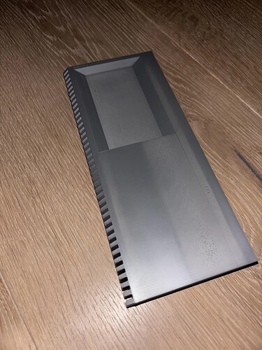

Here is the 3mf hope you can help and if you already here i had some problems with layer lines and now switched the settings that its slower and it prints the outer line first do you think thats good.

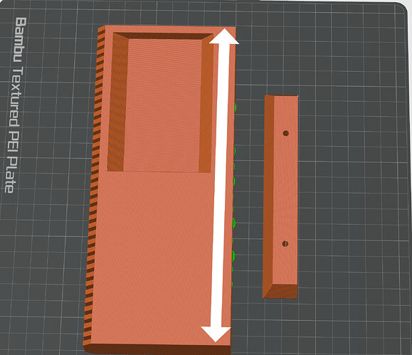

But I would rotate your object by 90°! Your ironing path is extremely long! I’ll show you with pictures:
Your ironing:
Rotated 90°

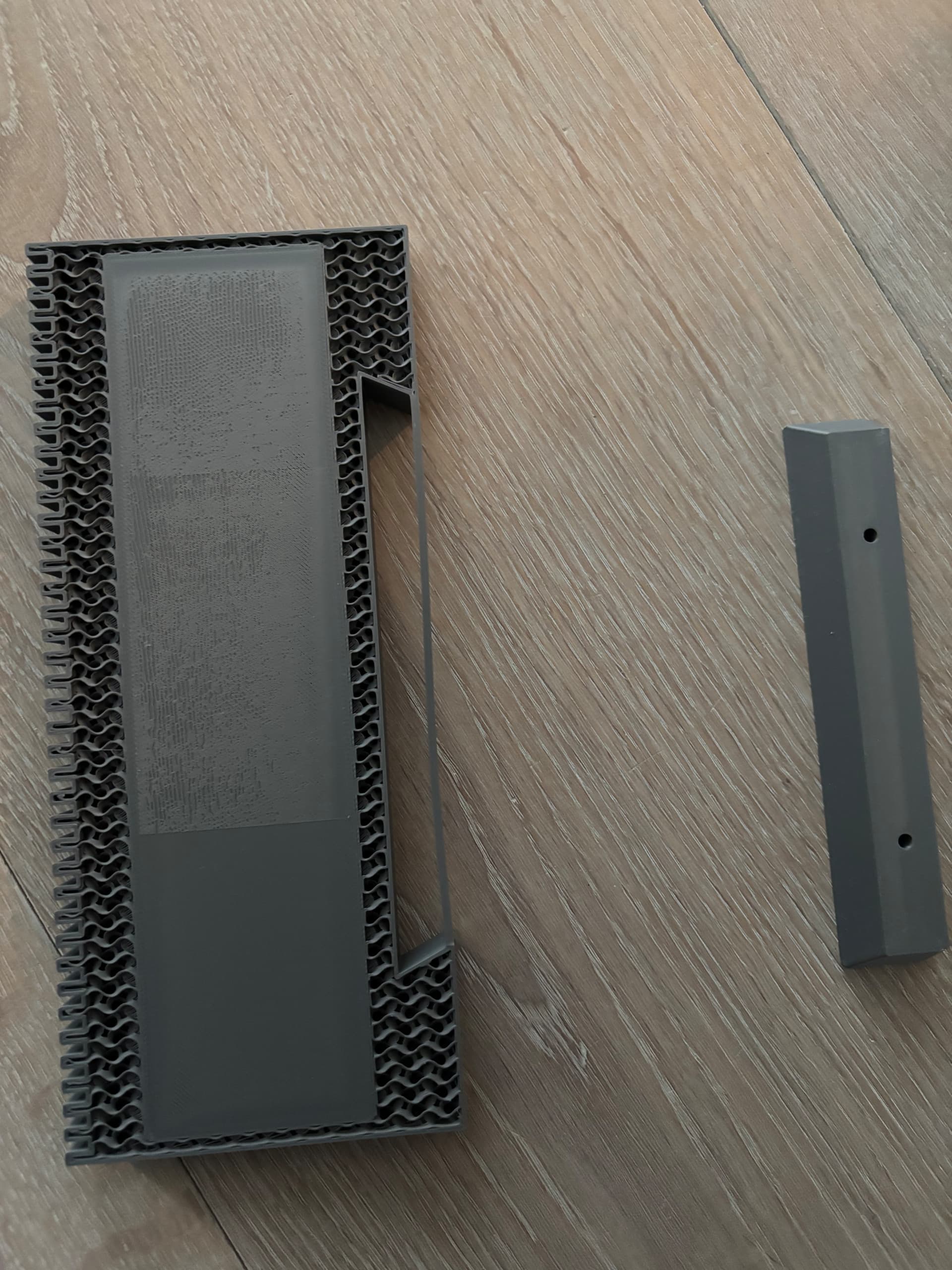

I don’t know what I am Doing wrong. Look I switched all settings so the Print was better because I Slowed the outher Lines down but I had to stop the Print because of This ironing unbelivable bad. And in the ironing progress the ams Wasnt moving or so Slow that I couldnt see it. I have a Video of that but I can’t Upload them here. btw. i edited the model a little bit.

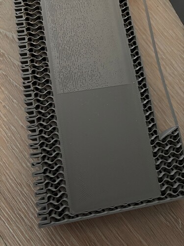

I also Printed a Flat Plate now to Look at the ironing. So ironing is Not so good but ok with same settings. But the colar is sometimes more brighter and sometimes darker.
Ironing is not easy to get right. It’s asking the printer to do extremely low flow for extremely long periods of time and not everything complies nicely.
That being said, we do have 3 pieces of data
The 3mf you shared has 25% flow | 20mm/s, and the print you shared of it exhibits surface raggedness. If you look at the swatch test you shared, raggedness in this filament appears to be cured definitely as you move down, and gets worse as you move right. So to make your print better, I would move flow 2 steps and hold still on speed. So maybe try 35% flow | 20mm/s

so i now changed to 32 and it looks wy way better just some fine tuning and it will look really good. But i have one question. I have this layer line problem and it starts when the overhang on the outerline beginns to print (marked in red). I hope you understand what i mean.
