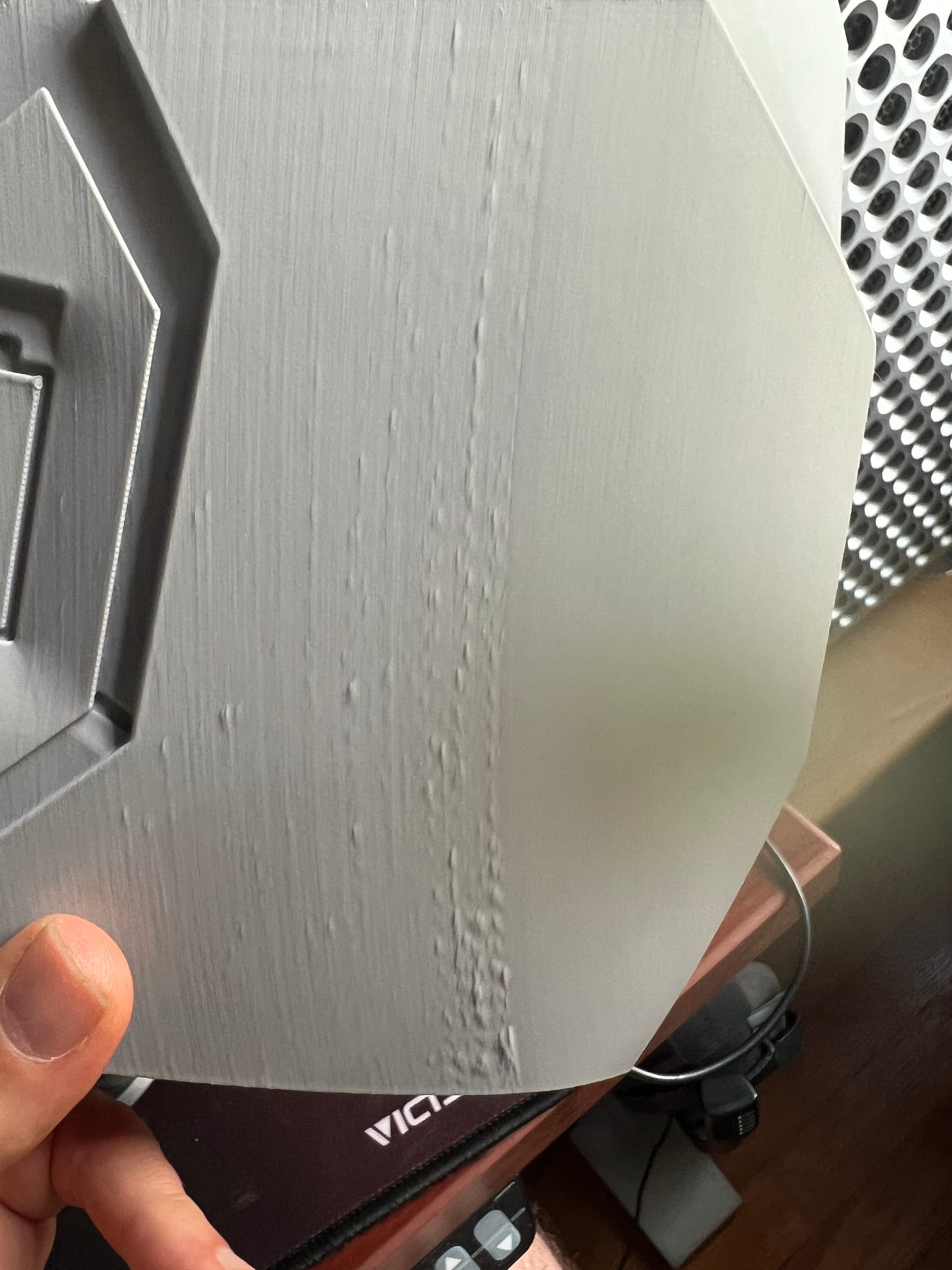

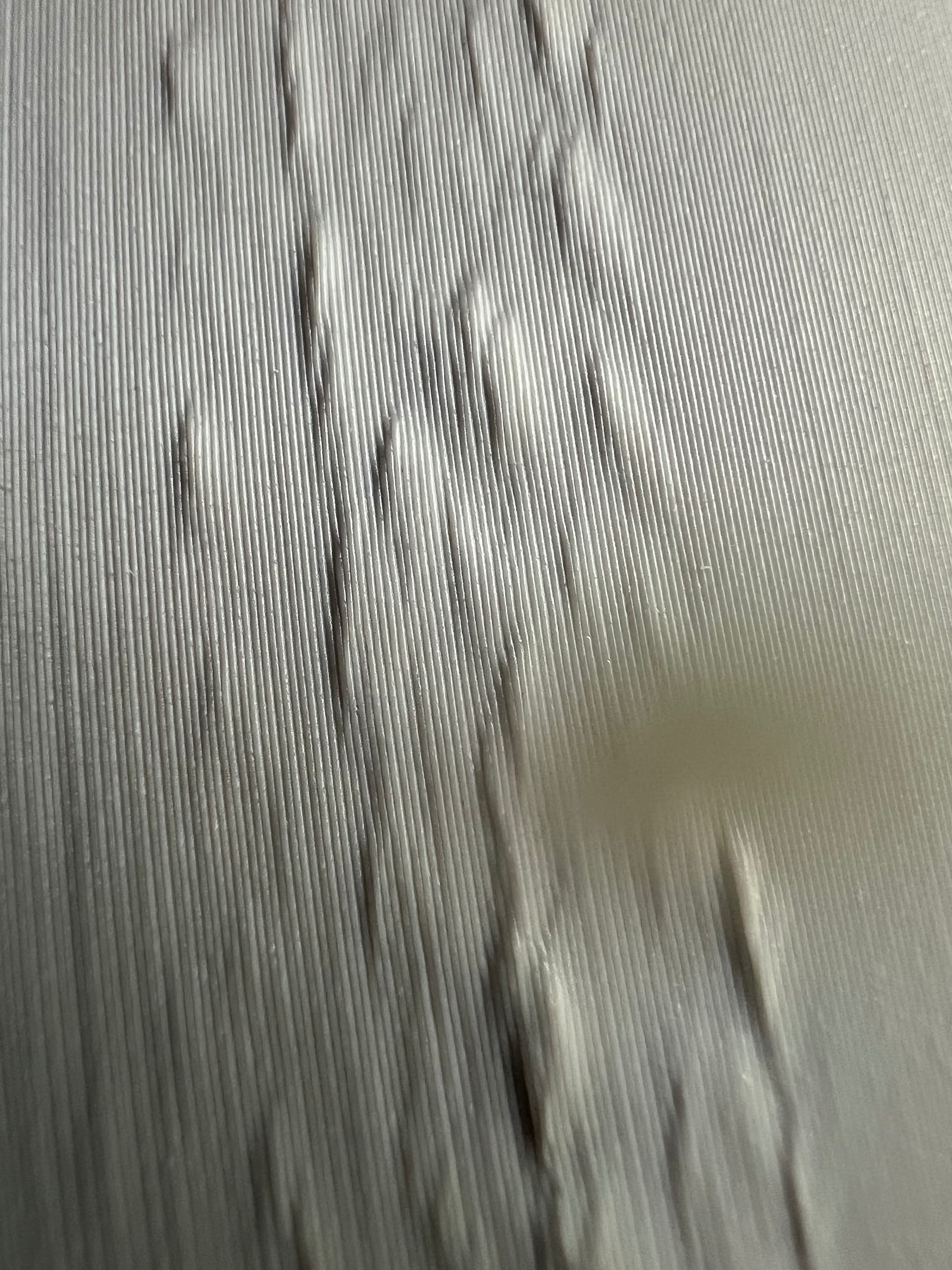

Decided to try printing the Mandalorian armor. On the chest piece I got this strange surface defect. The two should pauldrons also had this but much smaller area and more subtle. I haven’t encountered this before these pieces. It’s somewhere between waves and bubbles? I don’t know that to call it which makes searching for information difficult.

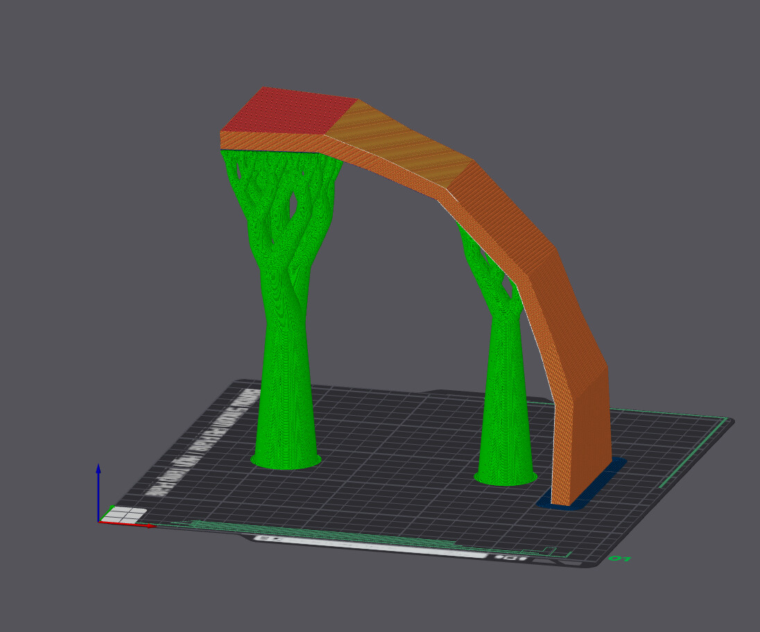

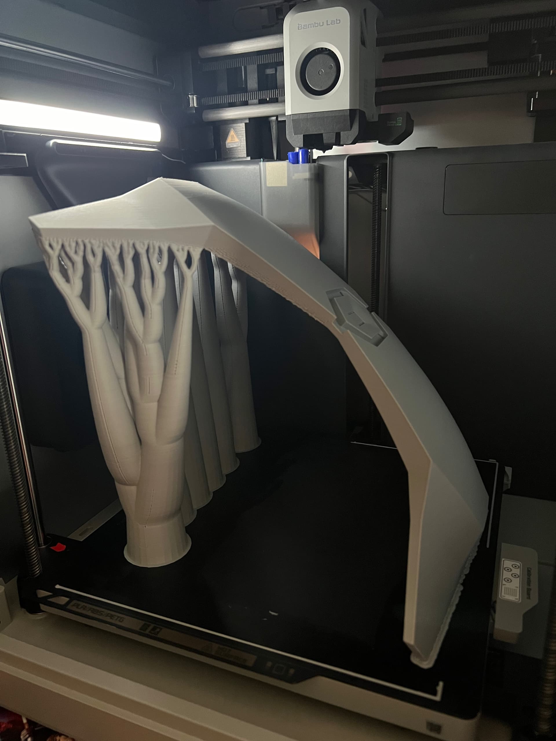

I have attached picture of the defect as well as how it was positioned while printing. It was tough to fit so I had to angle it. As it sat in the printer this was toward the top.
Looks like over extrusion to me, what temp are you printing at?
It’s the built-in Generic PLA setting of 220.
Try running a flow rate calibration
This is clearly NOT over extrusion, as evidenced by the many near perfect layers beyond the problem area. It could be something similar though in that the part may be moving due to internal stressed as the filament cools, thus bring each successive layer closer to the nozzle than expected. Hard to say for sure, of course, but the overall shape and size of the model does lend itself to this type of issue — especially seeing as the shape make a fairly radical change as it transitions to / from that logo looking piece.

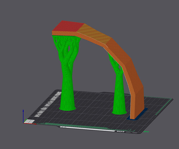

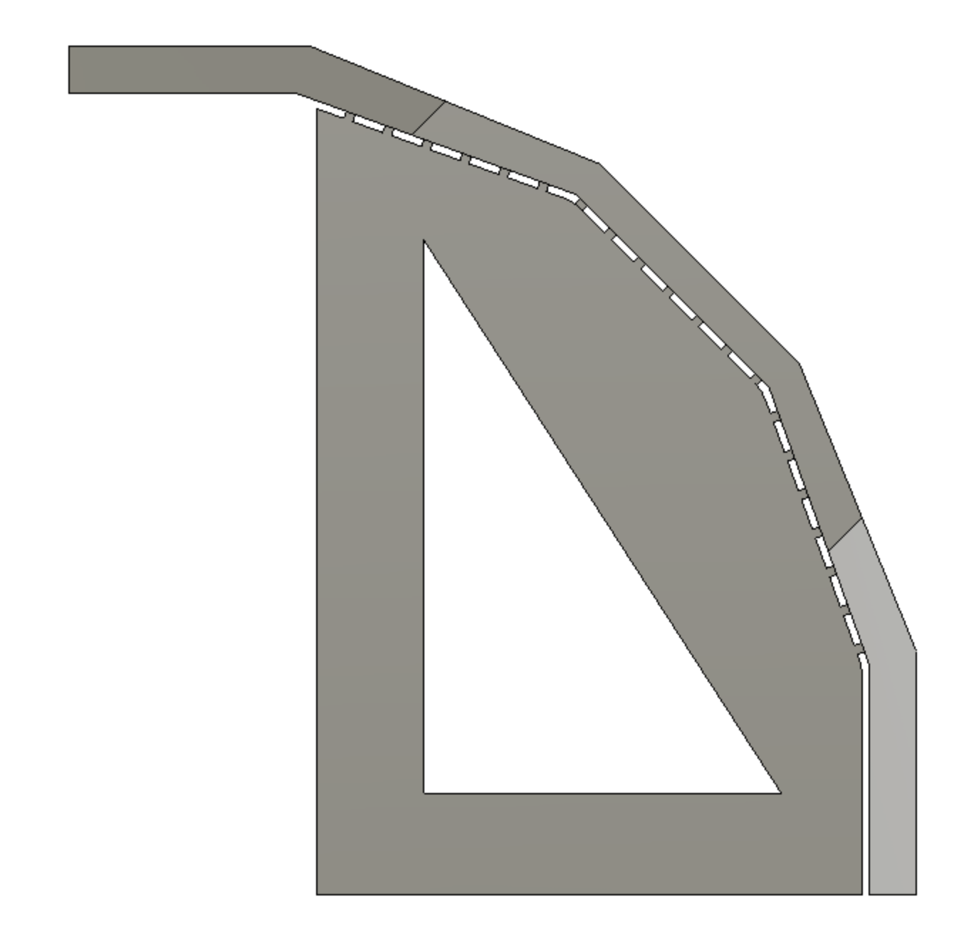

If this is the case, I can see a couple potential solutions. One would be to model in a thin wall support under the entirety of the overhang, such that it holds the shape in place. You wouldn’t want auto-supports for this but rather a designed in structure with a small gap (say 0.4mm) and a series of little say 3mm wide tabs spaced about 5mm apart for easy removal after print completion.

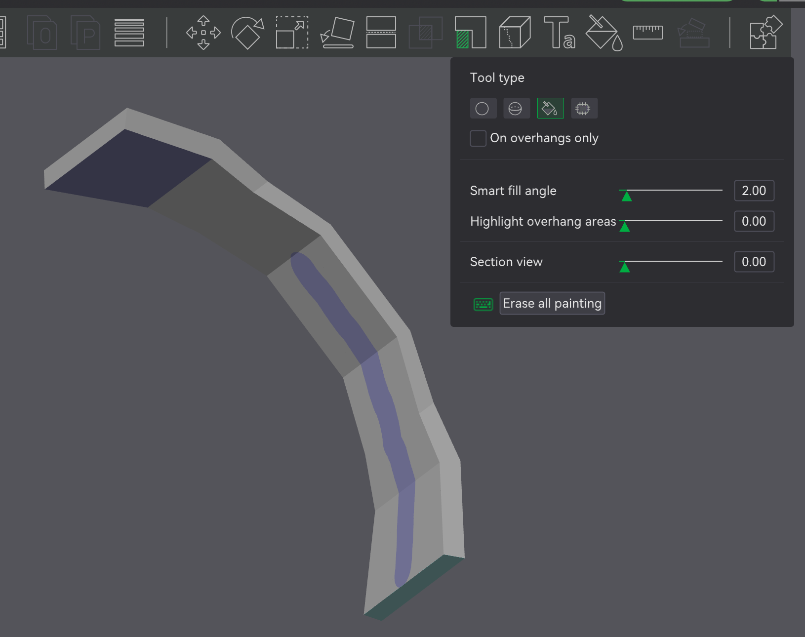

If you’re not concerned about support structure anomalies on the bottom surface, then you can use paint-on support to run a strip up the middle of the underside. It will surely help a bunch. I would do this rather than merely changing the auto support threshold angle because that will create a massive amount of unneeded support in this case. Just pain on a line about 10mm wide.

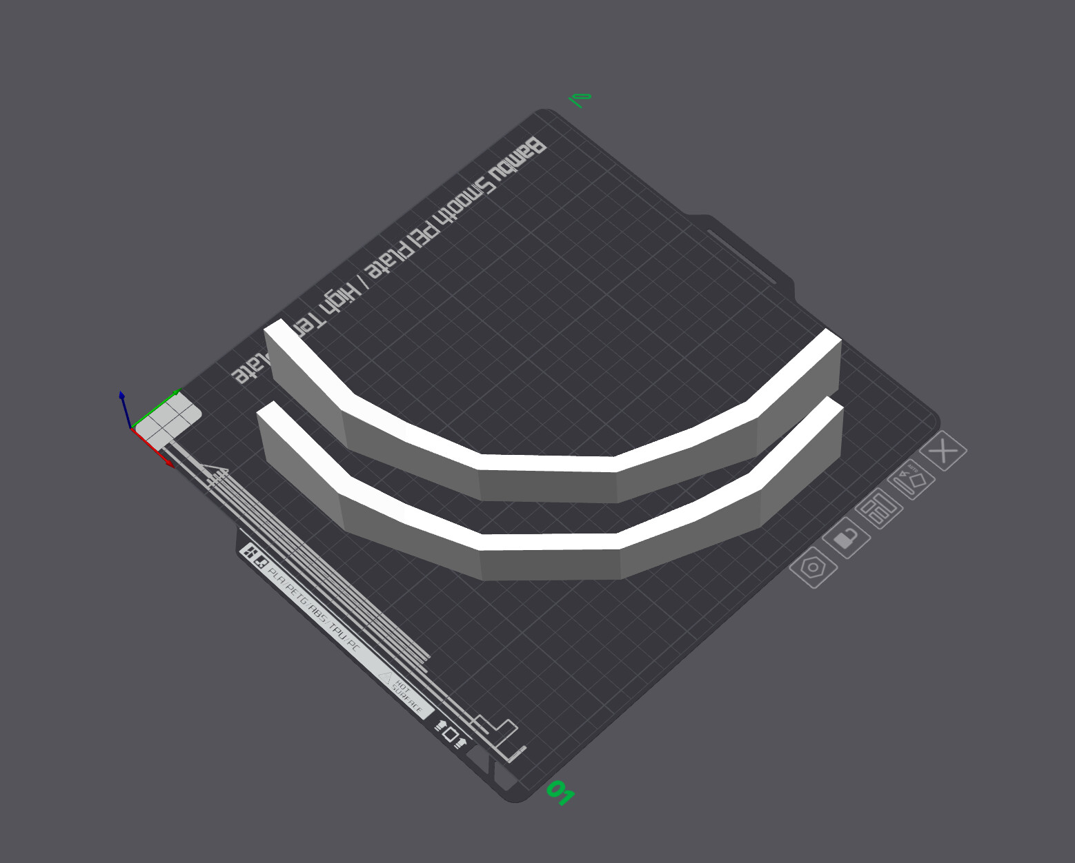

Another option would be to slice the part in half down its length and print each half horizontally, flat on the bed (if it will fit). Then glue the two halves together after printing. This will remove the overhang situation during print entirely.
Painted supports might go something like this (Tree / manual) …
Or splitting the model into two parts, something like this …
A modelled in support structure could look something like this …

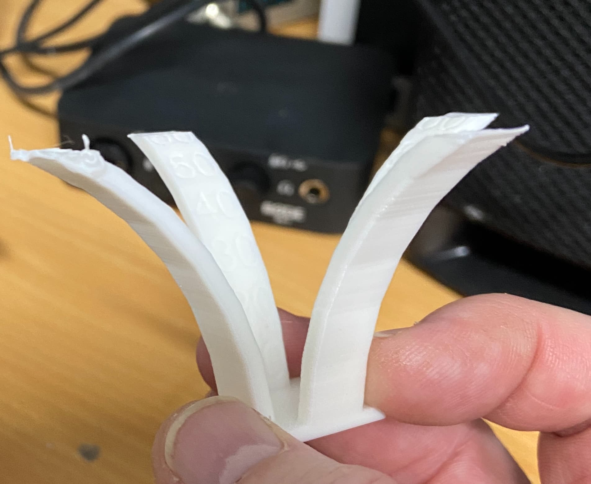

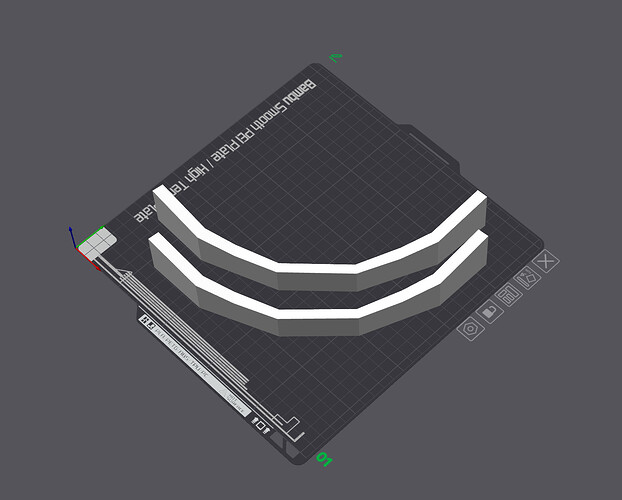

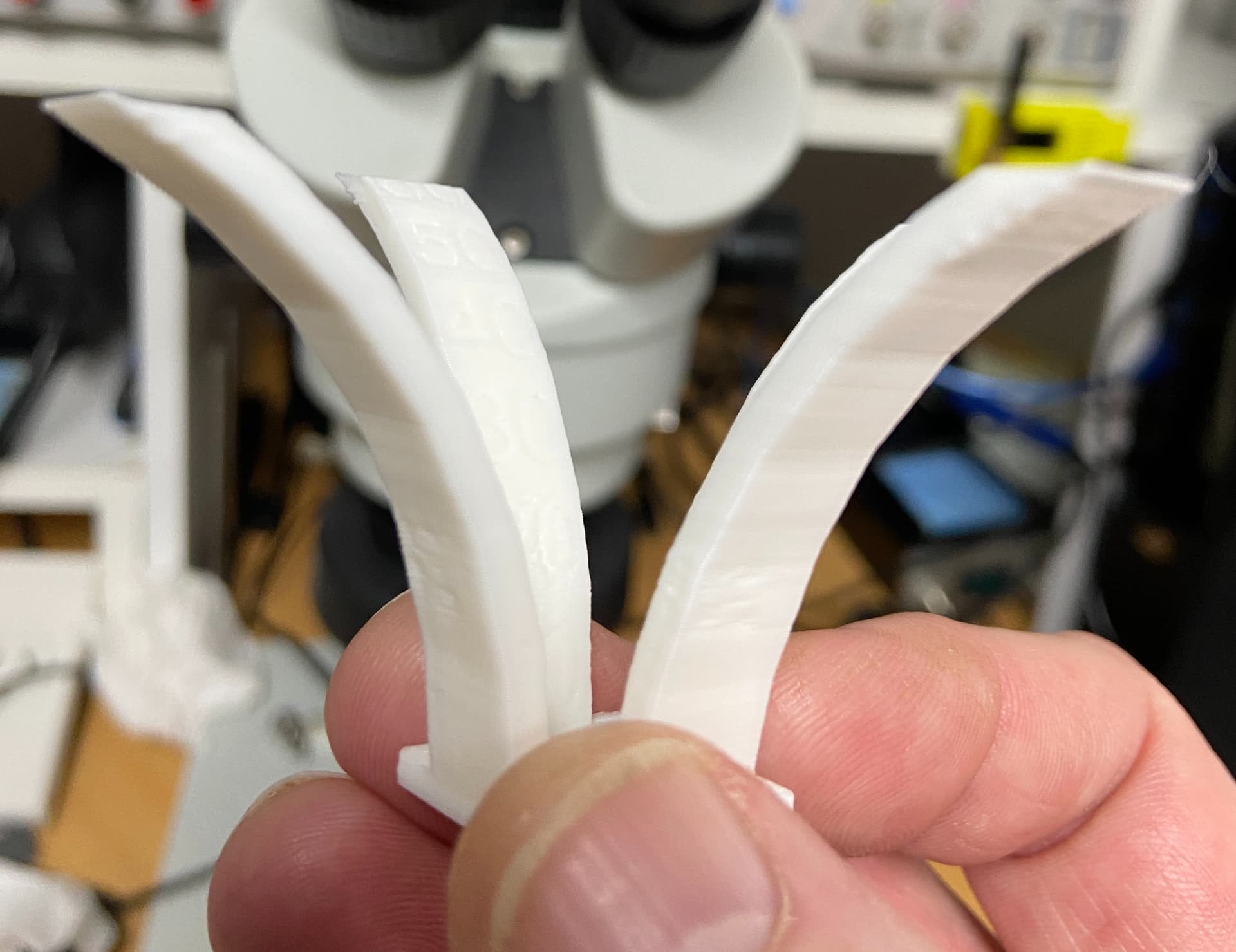

I decided to try printing a simple overhang test model and it was disastrous. The overhangs started curling so badly that the print head started hitting the model with a clicking sound. Eventually it got bad enough that the print head shattered the arm off the print.
This was with the aux fan on it’s default 70%:
It seemed worse for the sides closest to the aux fan, so I ran it again with the aux fan turned off, but it didn’t make any difference, still started hitting around 40 and snapped the front arm off again:

Firstly, that model is expected to fail beyond about 50º on most printers. It’s a “print until failure” type torture test. However, it’s not that simple. For instance, BambuLab’s PLA basic Jade White print of that model manages to fully complete on my X1C — if I use the PEI smooth build plate. The textured plate, has a harder time holding onto the part as it starts getting knocked around, not that getting knocked around at all is what we want.

For reference, here’s a print I just did of a similar model on my X1C using BambuLab PLA Basic Jade White on a PEI smooth plate, using all standard settings, including a bed temp of 55ºC. I usually change that to 65ºC for better adhesion but forgot this time. (I never use glue on PEI surfaces, unless I need LESS stick, like for large footprint TPU prints.)
This was printed a “Normal” speed, in the center of the bed and seems to have completed the 60º section before getting knocked off. Had I done something to hold it down better, it likely would have completed — not that such would prove anything. The overhang quality up to 60º is notable however, it looks like a physically much smaller print than yours and thus has much less opportunity to build up over-extrusion artefacts.
I would be happy to print the same overhang test as yours for comparison’s sake, if you like. Just point me to it. Maybe even more data could find a way to be actually useful? (I’m aware my post is very long and probably not all that helpful. My apologies!)
Here’s another one, this time with 10% additional flow rate (0.98 to 1.078) …
Here’s one printed at 20% over extrusion – flow rate 1.176 …
Each ten percent increase has resulted in the print reaching a few layers less in height before curling and being knocked from the bed.
You can also see from this that over-extrusion alone does not cause some of the other artefacts your are experiencing — which is the real reason I wanted to produce these three prints to show — remembering that this “proof” is only valid for this specific filament, with this specific overhang model.

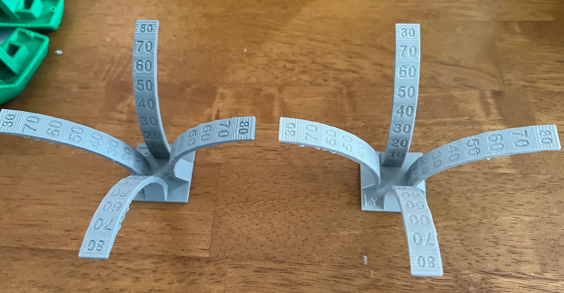

I tried printing this model using Bambu PLA Matte (grey) using the 0.2mm Standard profile and it printed the entire thing successfully.
I then tried using the Polylite cosPLA using the built-in Polylite filament settings and it failed around 60. So I then tried the cosPLA using the Bambu PLA Matte settings and it worked! Something about the built-in PolyLite filament settings was causing the failure.
Here are the two successful prints side by side (Bambu PLA on left, cosPLA on right)
