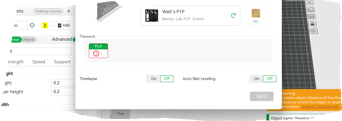

this problem shows up when ready to print. When i open the Print page the filament section shows PLA ! see below.
The SEND button is not active and if I open the PLA ! i get this window.
If I select the only option, EXT it will allow me to print but of course thhe filament data is incorrect.

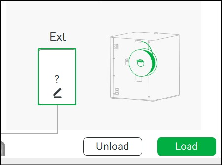

I do not have an AMS on my P1P printer.
With no AMS, there is no syncing of filament. The AMS all have an internal RFID reader to detect Bambu Lab filament.
With no AMS you have to manually configure the external spool hanger for your filament.
Over the last few months BL has been updating not only the printer firmware, but the also the AMS devices and BL Studio’s configuration.
Follow this guide and it should get filament to the extruder.
LOADING Filament
Then, on the Device tab in Bambu Studio, select the external filament picture and click on the pencil icon.
Fill in the blanks.
