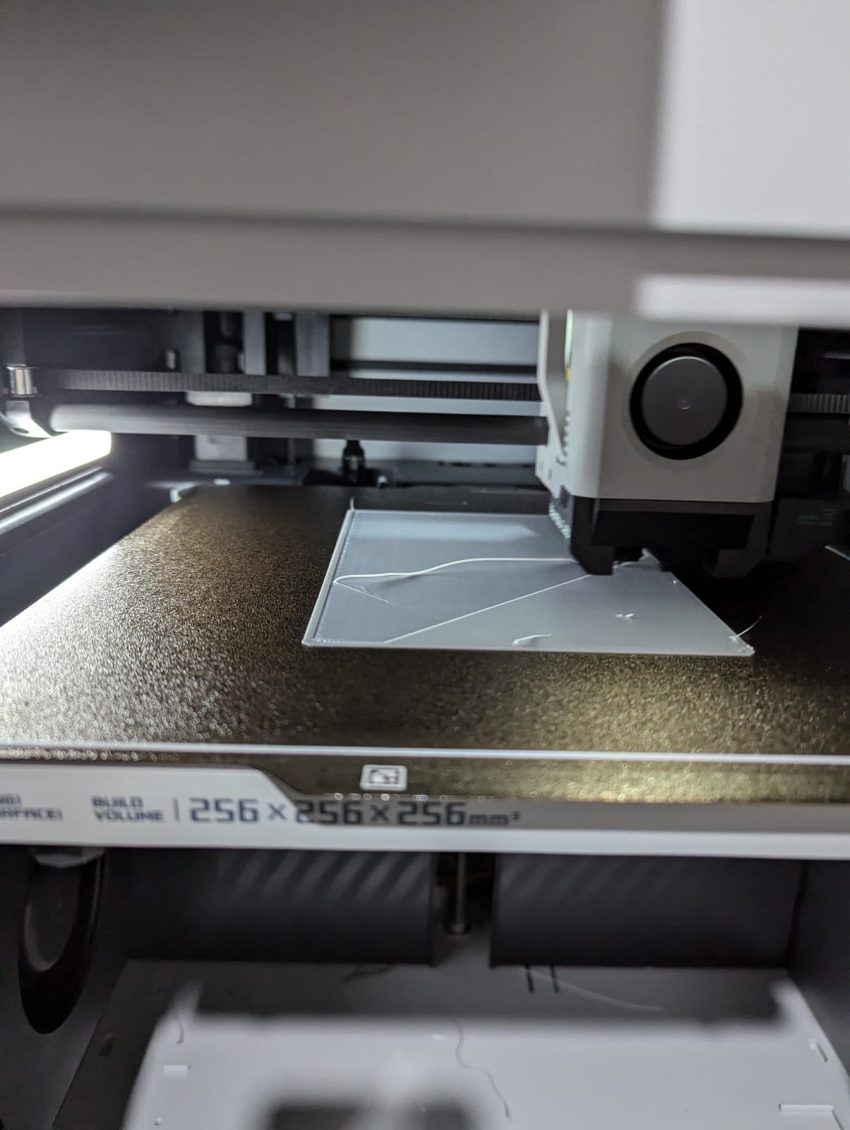

Printing the diffuser in PLA on textured bed with bambu glue applied. I am getting an 8cm extruded tail which I noticed about half way through the first layer (tail had stuck to the side of the print head and was moving back and forth with it). I paused the printing and it wiped it off. When it restarts the print, when it moves back into position there’s another one stuck to it (did it three times). Sorry if the terminology is incorrect but am very new to 3d printing. I have had the x1-c for about 3 weeks and haven’t had any other problems with it.
In the photo the lumps in the foreground are where one of the tails had been overprinted and I paused and cut it from the print. When I resumed the print you can see the new tail it produced and which got stuck to the print and had to be cut off (that one I did it while the printer was running to avoid getting yet another tail).
The filament is being printed from the AMS with three full cages of dessicant, the AMS status says the moisture level is “1”. The filament is Bambu PLA and is being printed with all standard settings in the slicer.
Can you tell me what is causing this and how to stop it?

Are you certain these tails are not a leftover that got stuck during the purging ?
Try to ramp the print temp up to 230 degrees and see if this makes a big difference.
If so print a temp tower or all in one test model to hone in on the best temp for the filament.
After that do the flow ratio calibration and K-factor.
If the print then still fails we have to get creative here.

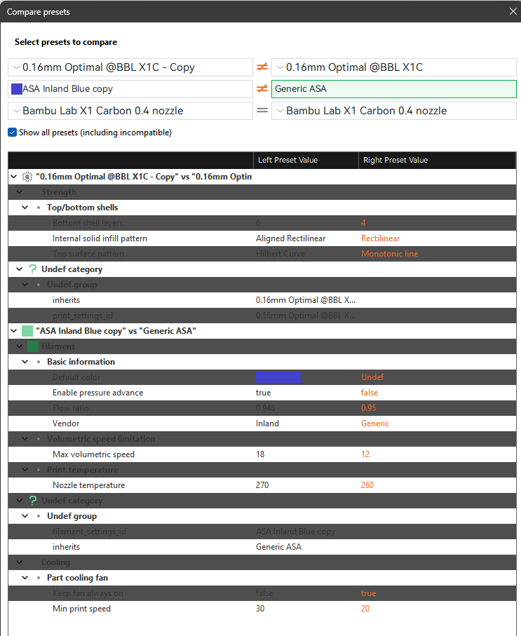

Some users will post multiple screenshots showing all of the many possible settings. It can be rather tedious to review and compare to settings that work for me. (I usually skip over those posts entirely.)
I prefer to use the Compare Presets option in Studio:
This shows only the differences between presets. This makes it easier to compare presets to default settings, or to try similar settings on my own printer - no need to verify every possible setting.
A sample, with some random changes:
If your modifications are unique to this project it will be necessary to save changes as a “Preset within a project” before making the comparison.
I’ve suggested this method of showing settings before, but I’ve not seen anyone else doing it, so your results may vary.
That IS a helpful way to provide data…
I tried running the same print again (same settings, same model, same filament), but I didn’t get any tails. Thinking back, I believe I’ve had this happen once before about two weeks ago, so maybe it’s an environmental problem? Either way, without being able to reproduce the problem again (was hoping to catch it on camera to show exactly what happens), it doesn’t seem like testing changes will help.
I’m going to just keep an eye on it for now and wait to see if I can catch it in the act again. Thank you for your help.
