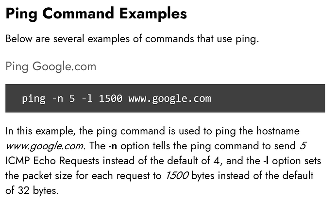

I don’t know what operating system you have, but every one has a tool for sending a ping.
