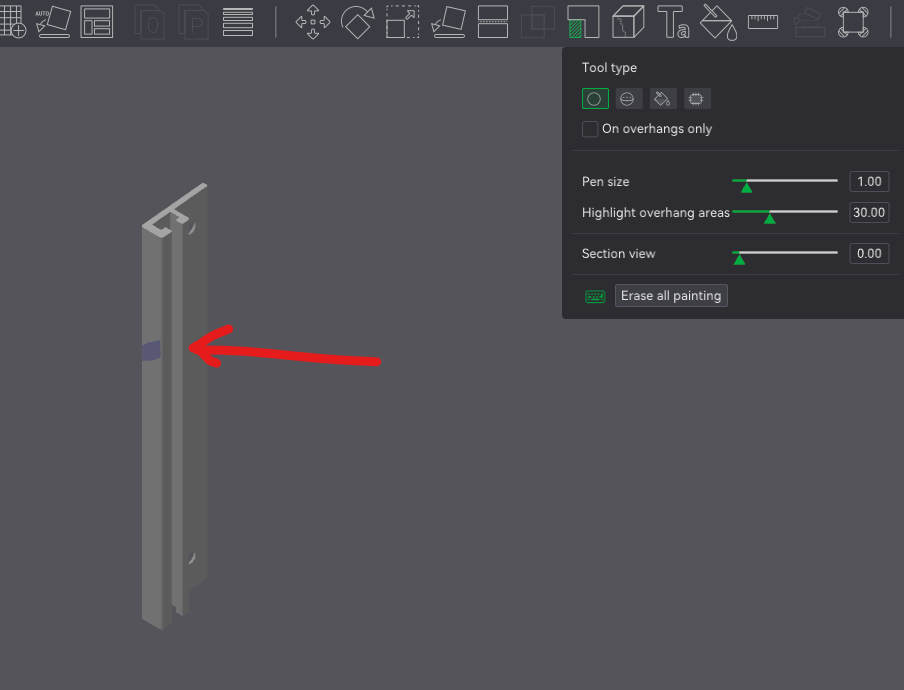

I tried to add a vertical support line in bambulab and nothing is added once sliced, that I don’t understand why.

  • You can add vertical support by painting the area you want it to generate at. Be sure enable it.

I tried the adding vertical supports and nothing appeared last time.

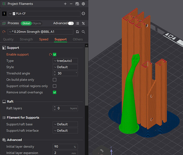

Is this support enough?
Don’t paint a seam along the wall - use just small areas.
3 or 4 spread along the wall will do fine.
But judging by the shape I would probably try it flat on the bed.
With the supports set to snug there should be enough gap in those rails to clean out the supports quite easy.

Ps the support weren’t adhered to the print.
