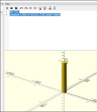

Printing a birdhouse and the exterior perch I want have an interference fit to avoid glue, hence the taper.
I have found myself using Merge/Mesh Boolean a bunch to do things like cut square holes in round pegs.
In this instance I made the very slightly tapered shaft in OpenSCAD, added the Disk primitive via Merge–>Mesh Boolean–>Union, then cut the square hole via Cube primitive—>Z-Move -.5–>Merge–>Mesh Boolean–>Subtraction.
Did “Center” on the square hole, disk, shaft to align everything. Fillets in Fusion.
$fn = 64;
cylinder(h = 100, r1 = 8.2, r2 = 7.95, center = false);
