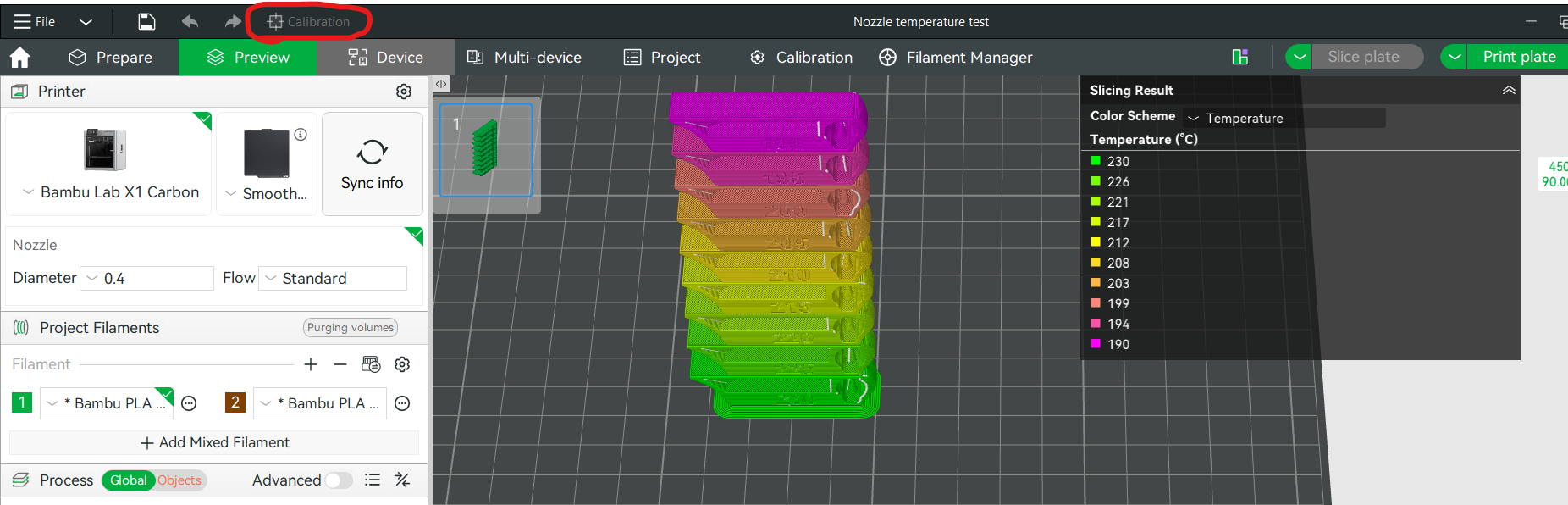

Let me present my issue. I am having issues with some filaments and I am trying to print a temp tower to dial in a little tighter tolerance. I just want that little bit more. I went to maker world, because the calibration menu on my PS1 and Bambu Studio does not have temp tower option, I found a file, downloaded it and printed it. It printed in one temperature.
I researches, learned how to change temp at layer hieght, set all my manila codes at the needed layers, resliced and checked the temperature map. All the same temperature. More research. Tried fake printer slicing, tried m104, m019, plain .STL and other formats, same result. More research. Looked for software overrides that would prevent the slicer from allowing the manual code entries. No joy.
I even went down the Orca Slicer trail, mostly knowing it won’t talk without a lot of questionable tactics that I don’t want to argue about at this point. Again, no joy.

Just to check:
  • You did use this to make the temp tower?
  • And made no changes after the temp preview before printing?
