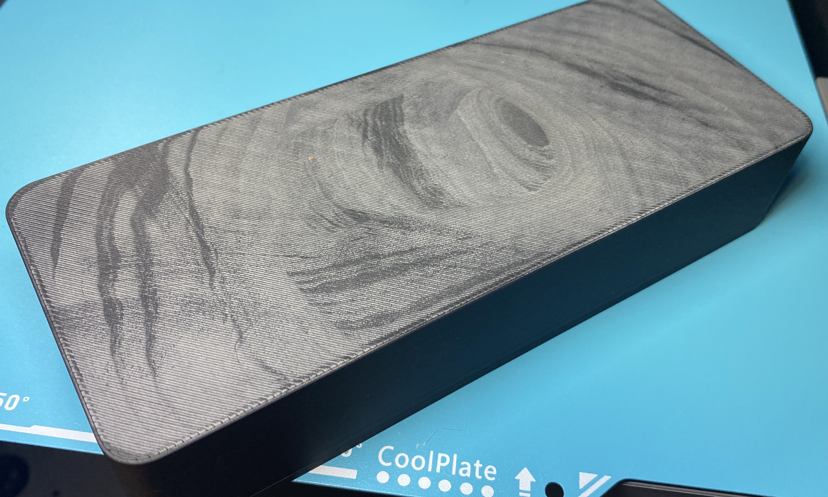

Out of curiosity, I ordered a cool super tack plate (a Glacier copy) from Temu. It cost 15€ so I thought I’d give it a go.
Result: it STICKS! Holy crap did it stick. I almost had to fold it in half to get the PLA prints off of it. But it seems they sprayed it with some funky glue because the print looked horrible. Full of some residue. Might have to give it a good scrub and try a print again.
The freezer is your friend. It takes less than 10 minutes. Then you can easily remove it without damaging the plate. :+1:
These are stress marks, often happens when pulling parts off before the plate is allowed to cool down. These newer plates seem to hold even after cooling down.
@RetroSharky’s suggestion of putting it a freezer works. I usually lower the bed temp to help with this as well. You can use a heat gun on the surface pf the part with the stress marks and that will remove them.
I gave it a good soap wash with luke warm water and the worst stickiness disappeared. Now it’s almost as good as Bambu’s original Cool Plate. And it has a very small texture on it so I kinda like it so far.
Time will tell how it works after a 100 prints.
If those are stress marks, and it looks like they are, they will go away if you pass a jet lighter over the print quickly.
