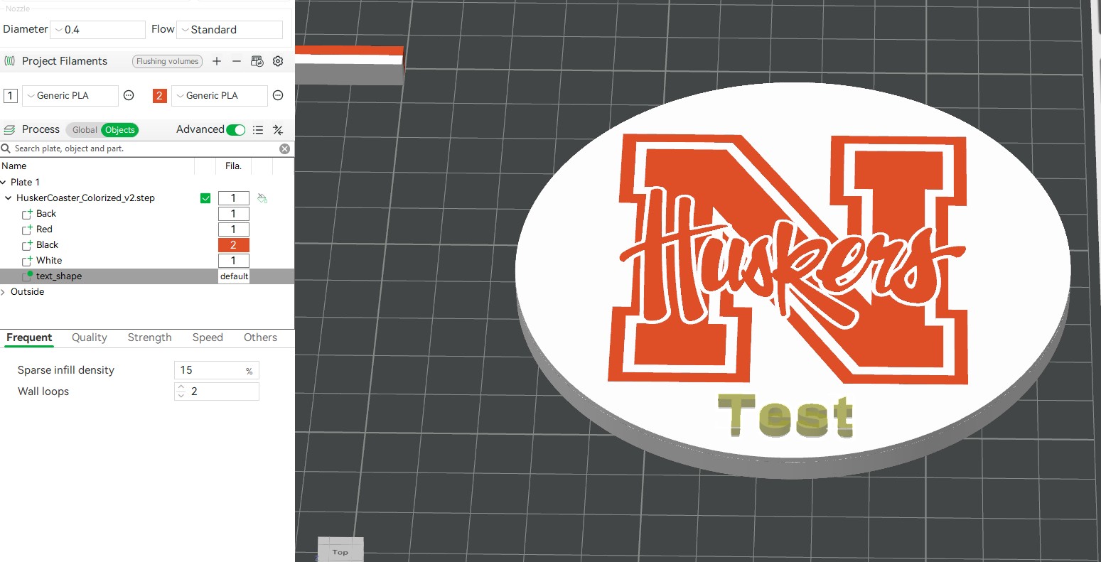

I’m brand new to 3D printing and have been trying to customize some existing files I’ve found in Bambu Studio. All I’m trying to do is add a name to the bottom of a coaster and I can’t seem to get it to show up.
I’ve added the text, changed it to an object (and adjusted the filament color) as well as changed the depth to 3.0. But when I splice it, the text is covered up another layer. I’ve tried flipping the image, I’ve tried altering the depth, changing the type to embedded… nothing I’ve tried will put the text on the topmost layer.

Right click on “text_shape” in the object tree. The pop-up contains “Change filament”.
Then, you need to move the modifier downwards into the part using the move tool at the top of the screen. 0.4mm should be enough against a white background. The common volume of the modifier and the overlapping object will have the filament change applied.

What I have done:
  • I removed the unnecessary top layer that was complicating things
  • I removed the painting you did; this complicates things
  • I set the layer you painted with a single solid colour, which gave back what the removal of the painting took
  • I tweaked the thickness so things line up
  • I changed the layer height to 0.2mm from 0.24mm, which was complicating things
  • I fixed your text layer.
  • I added an editable text layer you can edit as much as you want without any need to convert it to an object.
I set the text values as shown in the screenshot, taking note of the thickness and embedded depth values.
  • Delete your original text layer. I left it in so you could see it.
  • Then, change the font, text, and style as you wish.
  • Move it to where you need
