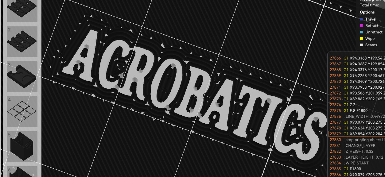

I took this file, did nothing, and sliced it. On a 0.4mm nozzle, A1.
Based on this, I agree that some of the very small minutiae of text will be unreadable or get a little mangled.
If you reslice with a 0.2mm nozzle, however…. the outline looks much more possible but there’s also just a lot of chaff being produced in those text reliefs…
Zooming in, the model itself has some odd artifacts within the text that I am sure are making the slicer get really desperate

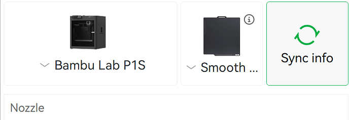

Just checking, are you using a smooth plate as recommended by the designer? That black printer plate? Or are you using the bronze-colored textured plate? The extremely small font is quite demanding for the printing plate in terms of adhesion.
By the way, you can also upload pictures here once you have completed the short tutorial in the forum and confirmed the rules, which takes less than 5 minutes.
I am sorry, I totally forgot printer info. Still quite new to this hobby… I have a P1S with the 0,4 nozzle. And no, I don’t have tried the smooth plate, didn’t see that recommendation (where?), but I did try my new Panda Frostbite Plate with the “Cold Plate/PLA Plate” setting (don’t know if this is the correct one?). Didn’t help it though…

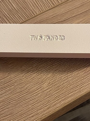

I took another close look at the model, and the main problem is that the font is completely unsuitable for 3D printing. The good reviews don’t refer to all parts either; many people have only printed the dice / chips tray, for example.
You can see it quite clearly here: the A, B, and R only have tiny little filament blobs in the middle. It may look big in my photo, but when printed out, it’s just a tiny blob that barely sticks. The font should be much larger, and I mean significantly larger, as well as optimized for 3D printing and, above all, for a 0.4 nozzle.
Here is a comparison of a test print showing how the 0.4 nozzle reaches its limits when printing text.
Of course, other factors can also play a role, such as settings, whether the filament is dry, etc. But I think that since this is the first model the creator has uploaded, he simply doesn’t have much experience yet in optimizing text for 3D printing.
If you can customize the font, then drag it over the entire object. There’s no reason to make it so tiny. I would also use a font that is more suitable for 3D printing. You have a large area, use it. This is not a competition to see how small you can make the font. :grin: :+1:
