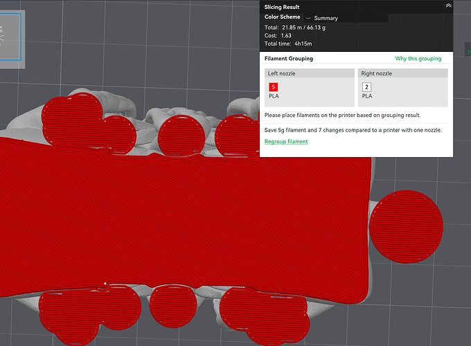

Hey!
I was having the exact same issue today. In where I was adding text on the bottom, painting either the text, or painting the bottom, but leaving the text the same color as the object (so the text ‘pops’). Then when I went to slice, the entire bottom was gone, without text. However, I’m not using a dual nozzle machine. I’m using the Carbon X1C.
In any case,
  • I added the text on the bottom of my print. I made it to be a “part” (not negative part). I kept the depth at 0 but it would auto go to 0.10 and embed to 0. But do play around with it.
  • Made either a group, or Mesh Booleen’ed the object and text.
  • Click on the object and go to “Paint”
  • On paint, make sure “edge detection” is on!!! I had it on connected same color
  • Slice
To recap, I tried playing with my print within the paint settings by turning on “connected same color,” - didn’t work, then turn on “edge detection.” and I was able to make it work once I slice.
Note* I did follow blchandl2’s instructions and it did work! but it was recessed ever so slightly, and the bottom color sort of bled into the text. But it was a quick fix.
