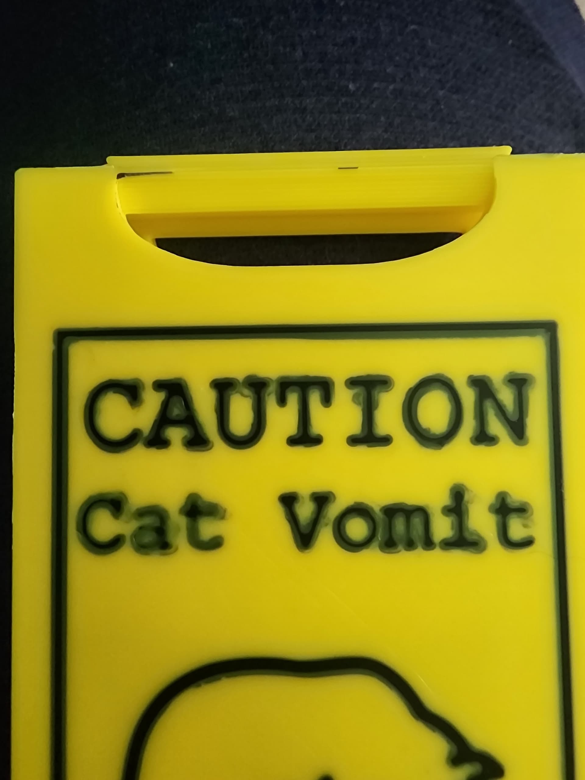

Using the Bambu A1 for about 8 months now, everything has been great. I have this desk sign I’ve been printing and it wastes a lot of filament. So I’m now trying to print it upside down, flat on the bed. It comes out pretty good, but the text is not clear. Any tips or advice?
I’m adding text right in Bambu studio Courier New, 8.5 mm, 0.5 thickness. Set to Modifier and Surround Surface.
Eventuell mal die Druckreihenfolge der Filamente ändern. Erst Gelb und dann Schwarz. Gegebenenfalls noch das Reinigungsvolumen etwas erhöhen von Schwarz auf Gelb
Thank you! Printing the black first helps a lot!
I just figured this out! You can change filament order… Click the settings icon(nut) next to the plate in studio… Customize "filament sequence and select Black as the first color… So black can be printed first. If that doesn’t work you may just need bigger font or just change to a 0.2mm nozzle.
