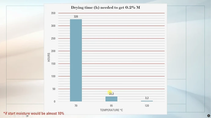

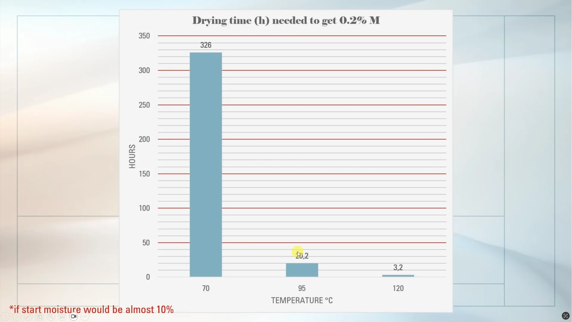

I recently saw a relevant video to this topic, from a PhD mechanical engineer at MATE University in Budapest. He both did the math and ran the experiments:

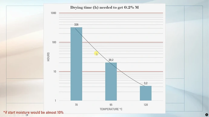

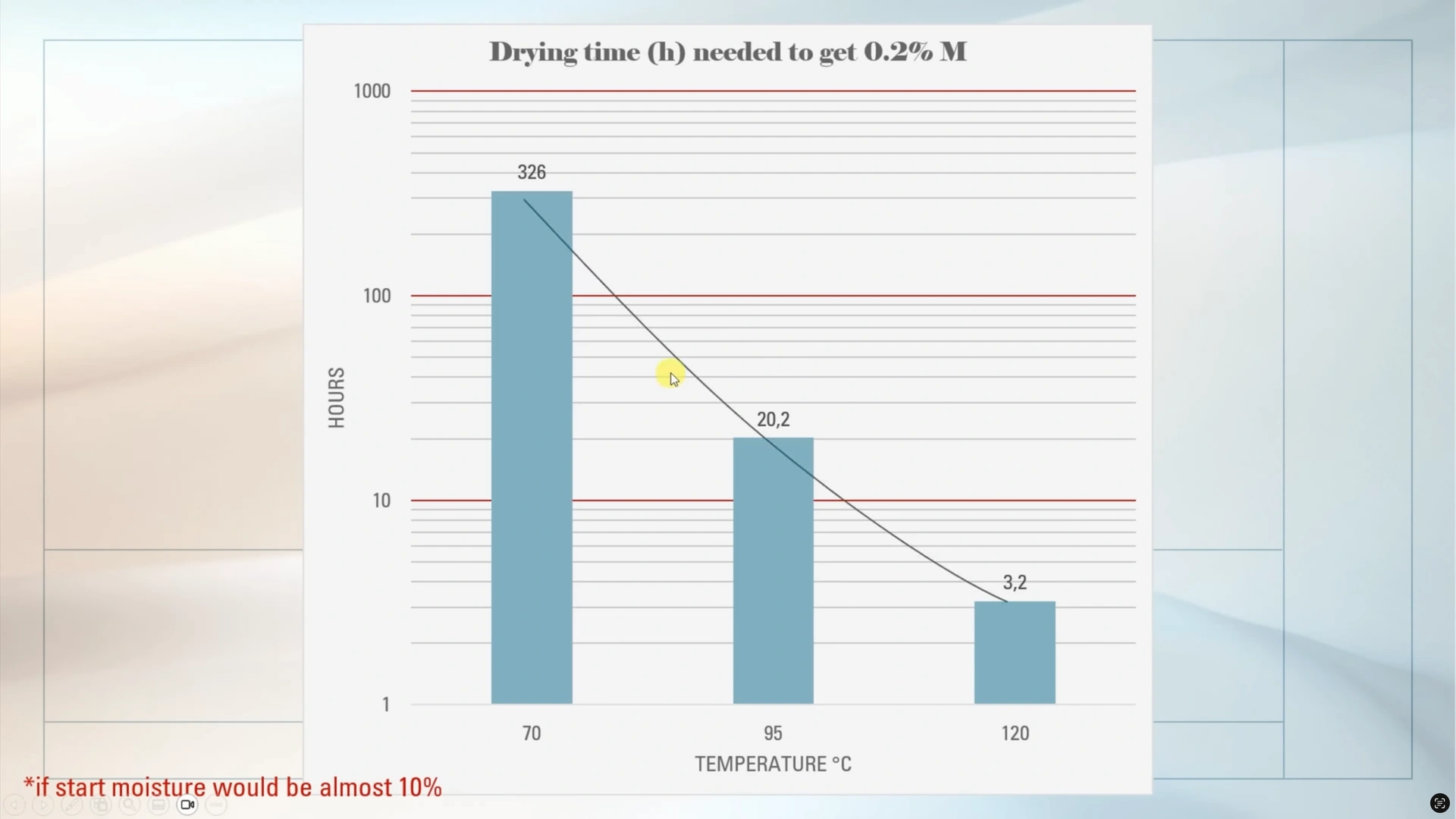

I’ll give you the spoiler: Temperature is key, not RH. Drying speed vs temperature follows a logarithmic curve. Getting a little bit hotter doesn’t remove moister a little bit faster. It removes it a lot faster:
That’s the kind of curve that makes me go holy !@#$%. Literally. Every 25º of heat you can bring to the party drops drying time by a factor of ten.
Same data, on a log scale, which makes it really easy to project drying time vs temperatures… but remember the essence here is weeks vs days vs hours!
(He also is asking manufacturers to crank up the heat as well as dealing with moisture and rotation the heat. A few years ago, driers only went to 50ºC, now they’re up to 70ºC… but hotter still would be far, far better, for the filaments that can tolerate it. Of course for PLA and PETG, 90ºC driers would be overkill. But the goal is to go as hot as you can without crossing the filament’s glass transition point.)
OK, let me come back to the AMS HT and your garage! I suspect you are hitting the absolute limits of the HT’s heater. Lower ambient humidity would definitely help, but I think you may just need to give it more time. A lot more time.

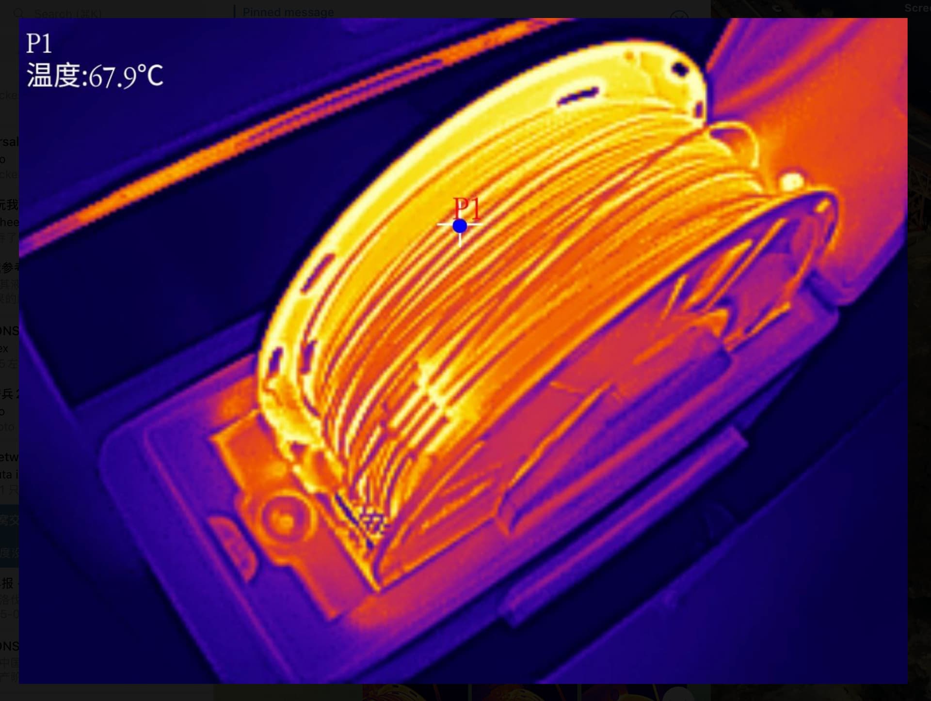

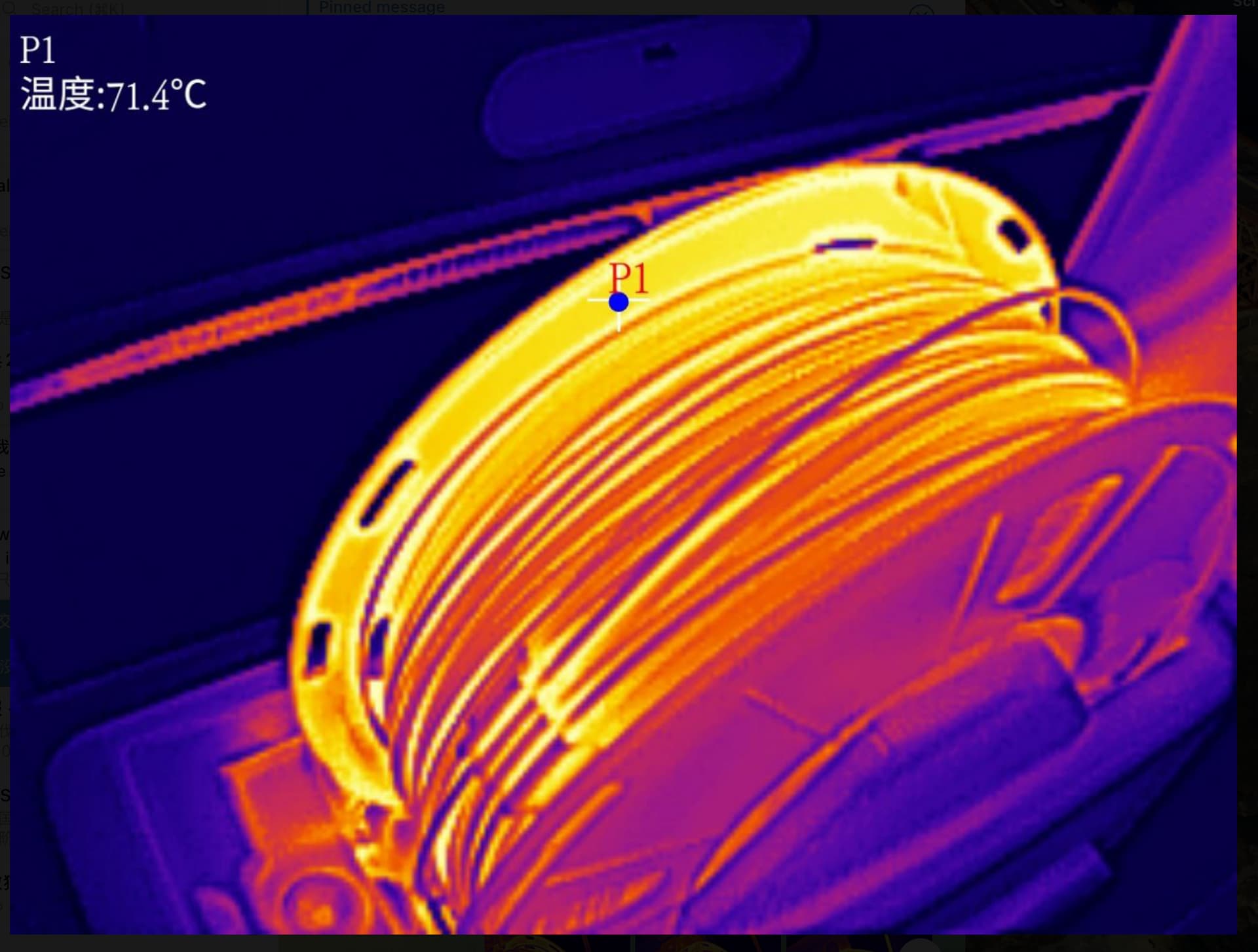

Check my post here,temps measured with both thermocouple and infrared

I think I see now what the fatal flaw might be: if the spool only rotates intermittently, and if any given portion of the spool is exposed to the proper drying temperature, say, 1/5 of the time, then it will take 5x longer to dry than if the entire spool were at the proper uniform temperature the entire time. Actually, longer than that, since it will loose time coming up to temperature again, and maybe only the outer band of filament ever gets to temperature and the inner core either seldom or never does.
I’m not really motivated to do a thorough investigation, but I may rig a quick and dirty test jig for measuring the outer rim temperature to see how it varies over time.
I have tested it previously and it’s pretty bad… you’d be lucky if you can get 75c near the spool anywhere other than the blowing spot, when you’re set to 85C.
