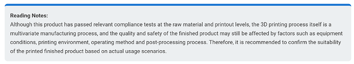

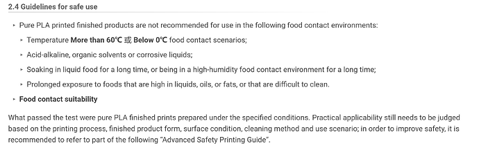

I guess this is a thing now:
https://3druck.com/en/3d-printing-materials-2/bambu-lab-pla-pure-filament-with-food-contact-approval-presented-28157224/
That is going to mix very well with the carbon fiber residue in my nozzle.
That’s pretty cool. But if this is specifically “food safe” then the other PLA may not be.
Still, the issue with tiny holes and crevices being bacteria breeding grounds remains no matter how safe the filament itself.
But for single-use things it could be ok.
Original source / Translated automatically; errors may occur.
If I’m interpreting this correctly, this isn’t about whether it’s ‘food safe’ as most people would define it, but rather whether it is suitable for coming into contact with food. They call that ‘food contact suitability’.
So typical uses include: a scoop for dry dog food. A bowl for fruit. However, it doesn’t apply to a coffee mug that’s meant to hold liquids.
Looks like it would be good for toys, or at least better for toys.
