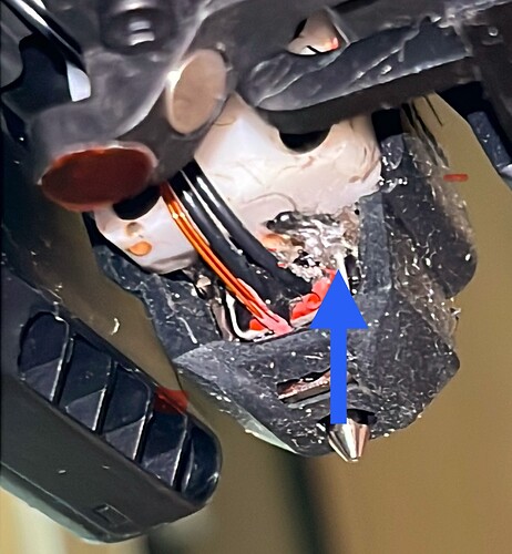

Is this because I removed something in the heating parts during removing BLOB?
I removed this parts. Does it matter?

It’s an educated guess, but it seems you’ll need to purchase this spare part:
Yes, the part you removed can definitely be the cause of that error. From the picture, it looks like you removed the heat insulation sheet from the side of the heater block when clearing the blob.
That insulation sheet is important because it both thermally insulates the heater block and slightly affects the shape/position that the nozzle offset calibration sensor detects. Without it, the calibration can see a “significant deviation” because the measured geometry has changed. It can also change the heat distribution, which may cause a tiny nozzle height shift.
In short:
Yes, it matters.
You’ll need to replace the missing insulation sheet (or get the correct spare part from Bambu Lab) for the calibration to pass.
Without it, the error will likely keep appearing.

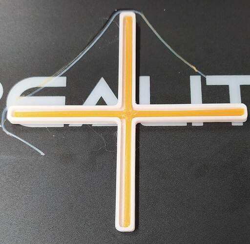

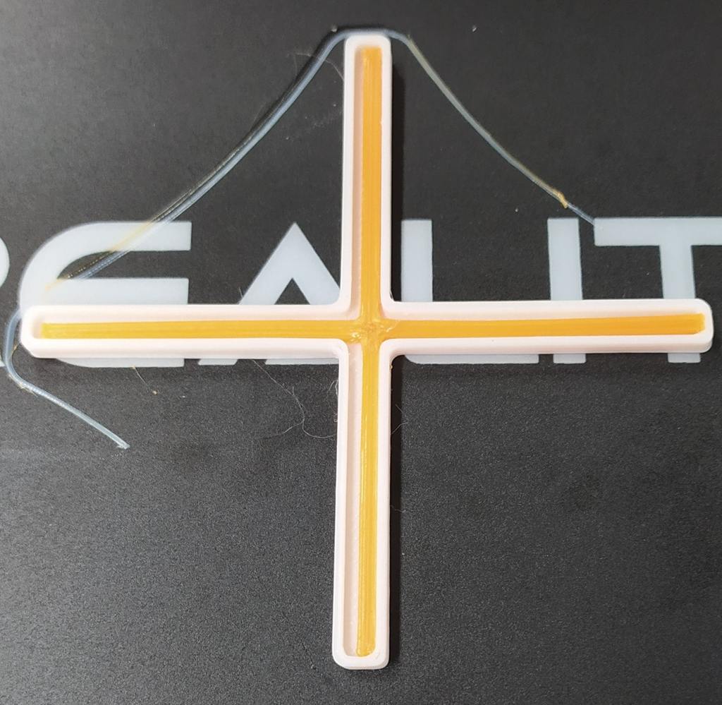

Try printing something like this and check the result. I would definitely replace the broken part, as the missing component is causing an error.
