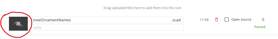

You can edit some of the parameters of the script, by clicking in the generator preview during the upload (or editing) process. The generator will popup and you can modify the parameters by selecting the plate:
