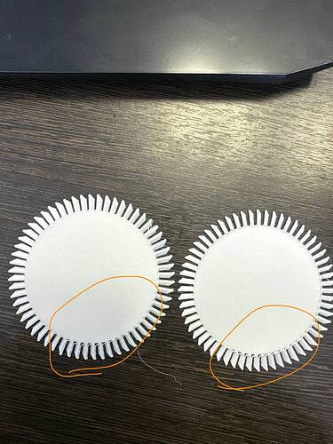

Help me with the print! I’m printing in vase mode with 5 solid layers on the bottom. But I always get holes when printing in the same place. I’ve tried printing on different printers (A1, X1CC). I’ve set the print power to 50%, but it doesn’t work. Please help me set up printing for a high-quality print!
Try to increase the extrusion width or use a bigger nozzle. This seems to be a kind of overhang problem. Have a look in the slicer preview if the layers are printing "in the air
Layers are not printed in the air, and I don’t have a nozzle with a larger diameter. Can you tell me how much to increase the extrusion width?
Two questions what type of filament are you using and have you calibrated it?
