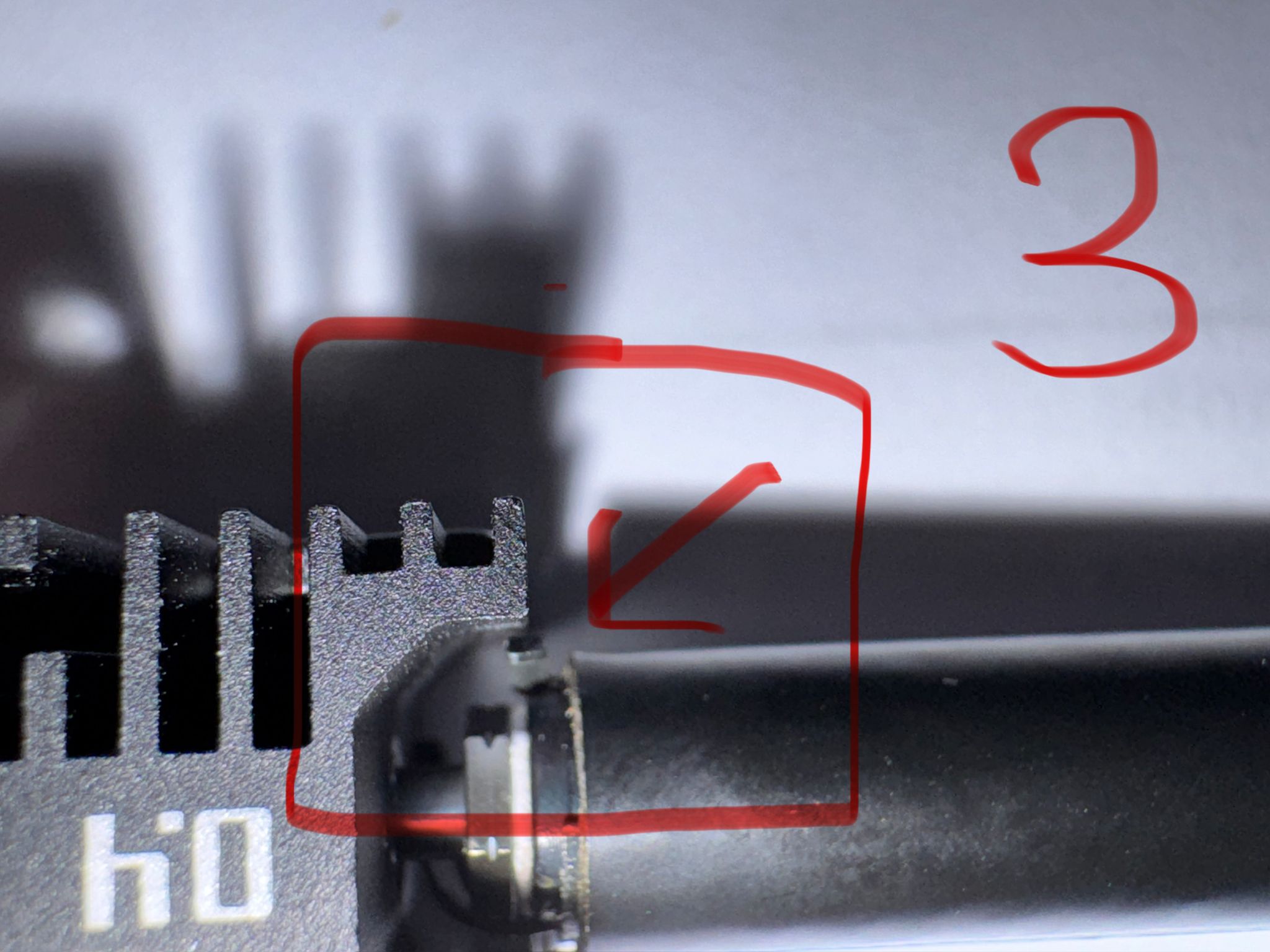

The Small Notches on H2C İnduction Hotends Appear To Be Positioned Differently

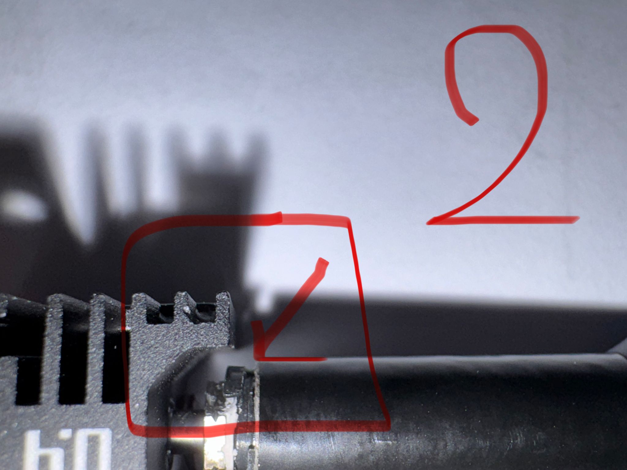

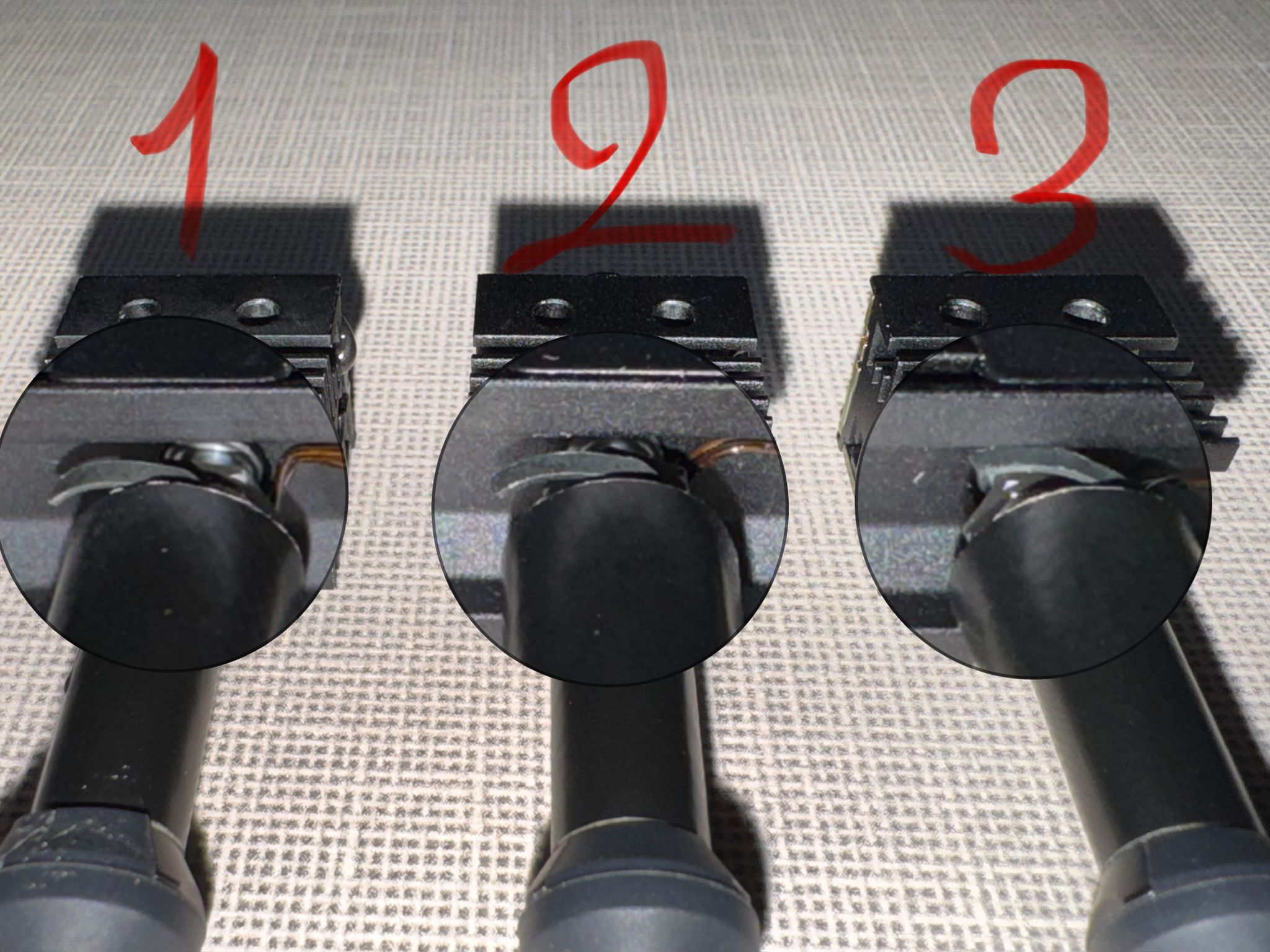

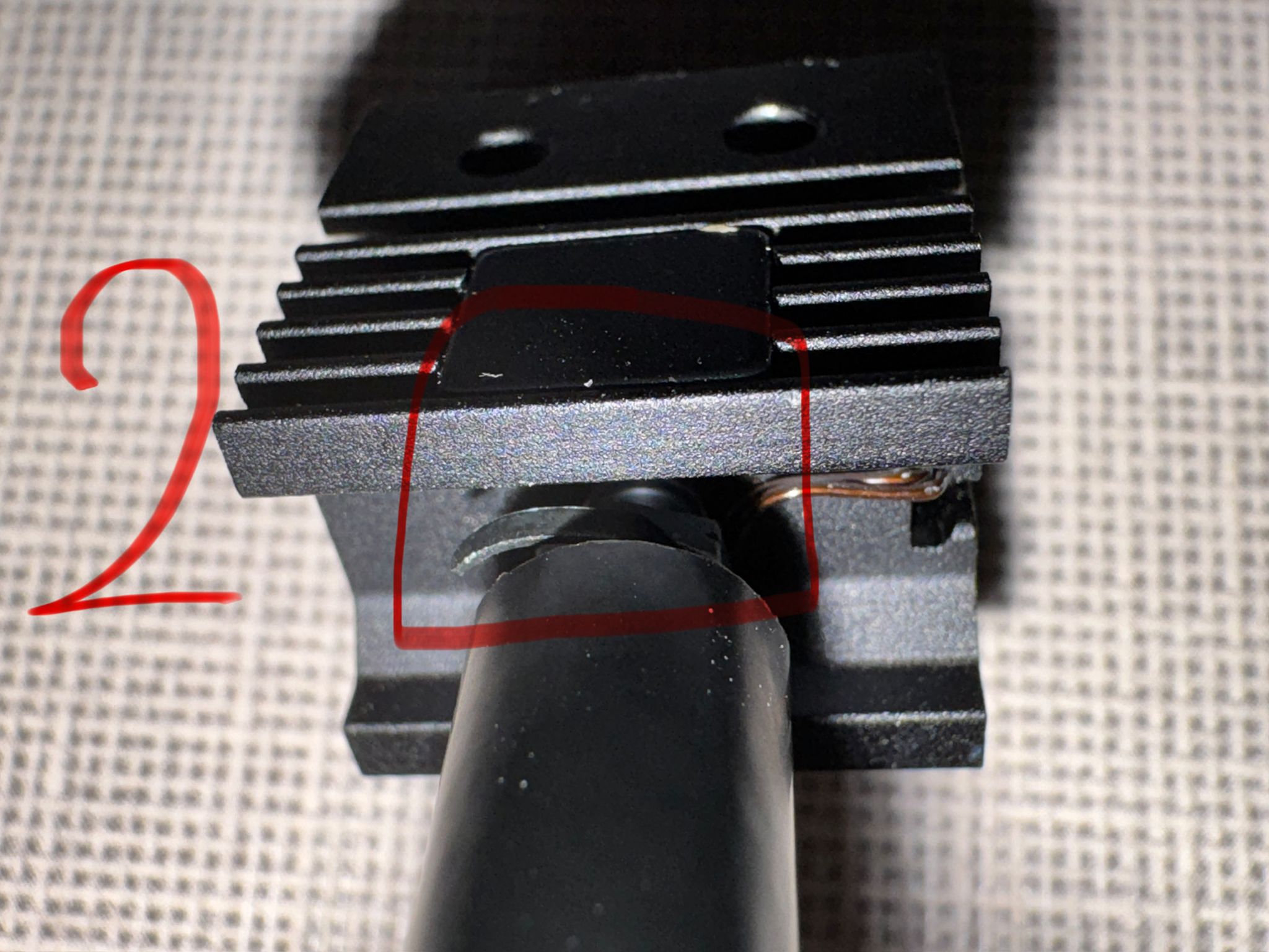

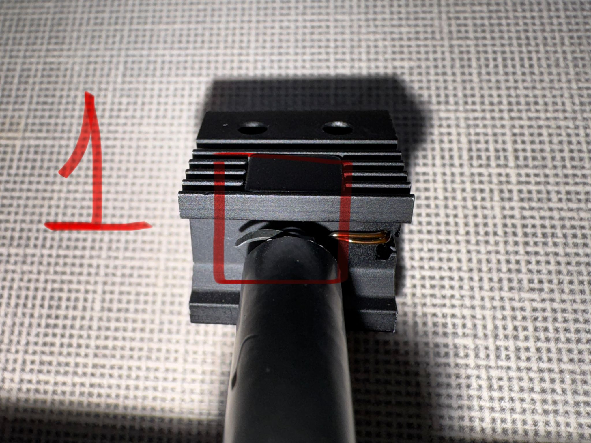

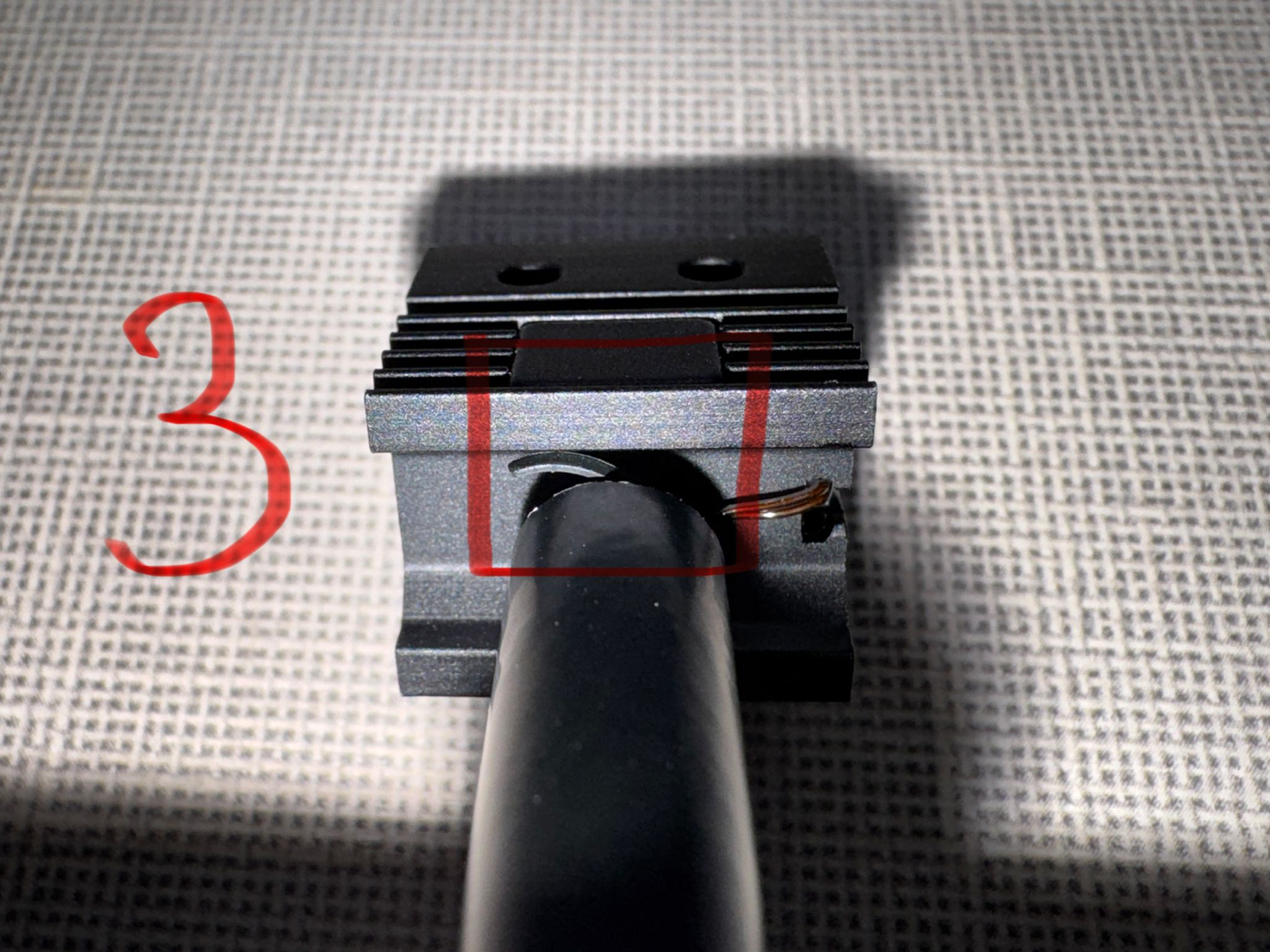

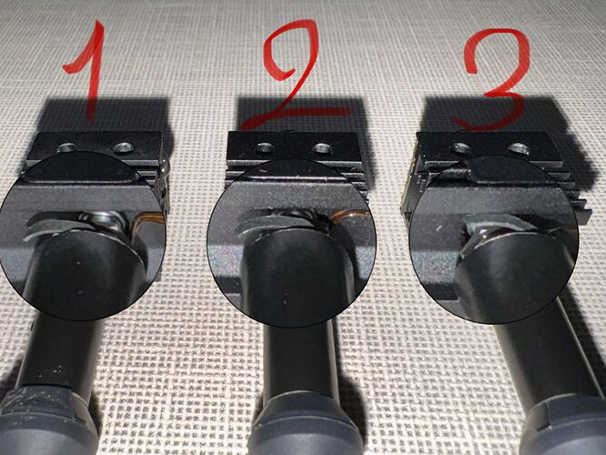

I’m not entirely sure, but I might have identified the issue regarding the hotend clogs. Could the hotends be defective? In the images below, two of the 0.4 mm induction hotends that I numbered look strange compared to the others. The notch in the areas I marked is located much lower and appears to have a different diameter than the rest.
Additionally, the notch on the hotend in image number 3 is very close to the cooling section, although it doesn’t quite touch it. If this is indeed a defect, could it be playing a role in the nozzle clogging?"
Ah that was the tab I was talking about way back a few threads ago where you first showed your tortured nozzle… :slight_smile:
So on 11 out of my 13 hotends that notch/leaf is touching the heatsink like in your 3rd sample. Some maybe a bit more/tighter than others… On one there was a small but noticeable gap (under mag. glass), and on the other it was further away… maybe a couple mm, almost like in your pics 1 and 2.
I’ve printed with both those, though not sure how much or what. The large gap one was a .4 and the smaller gap was a .6, both regular flow. I can probably trace the serial numbers… lol, but not sure which came from where/when. I bent those tabs out.

PS. Oh, the hole notches… I can’t swear mine are all exactly even… pretty close. I think as long as the nozzle gets picked up by the head OK, that’s probably fine, since they’re just to attach to the rack.
How do you think these bent parts could affect clogging? Could you please explain how this is related? I would love to listen.

To me, that metal “tongue” appears to be part of the mechanical system that holds the hot-end/heat-break and the heatsink together. They’re bent down to exert a clamping force on the inner metal tube when assembled.
There’s probably a fairly wide range of degree-of-bend that are effective, so there’s a fair amount of variability in the finished parts. If I had to guess, looking at the examples, it’s a manual operation with a hand tool. Which makes it susceptible to a wider range of variation.
I don’t see how this could contribute to nozzle clogs. Assuming I’m right about the purpose, if the nozzle isn’t obviously loose, the tabs are bent enough. And the amount of metal in contact with other metal we’re talking about here, the degree of bend shouldn’t have any meaningful effect on heating. Too small. Too limited/irregular a contact patch. This isn’t a “heat sink” of some sort.
I think this observation is unrelated to the problem. Correlation not Causation.

Looks to me like a retaining clip or something as they assemble the hotend. IIRC that induction heater receptor is just a sleeve, so this crimps it on? Unless it’s physically interfering with fitment I dont think it could cause a clog.

Thanks to your contributions, I understand that these notches have nothing to do with hotend congestion, so thank you all.
