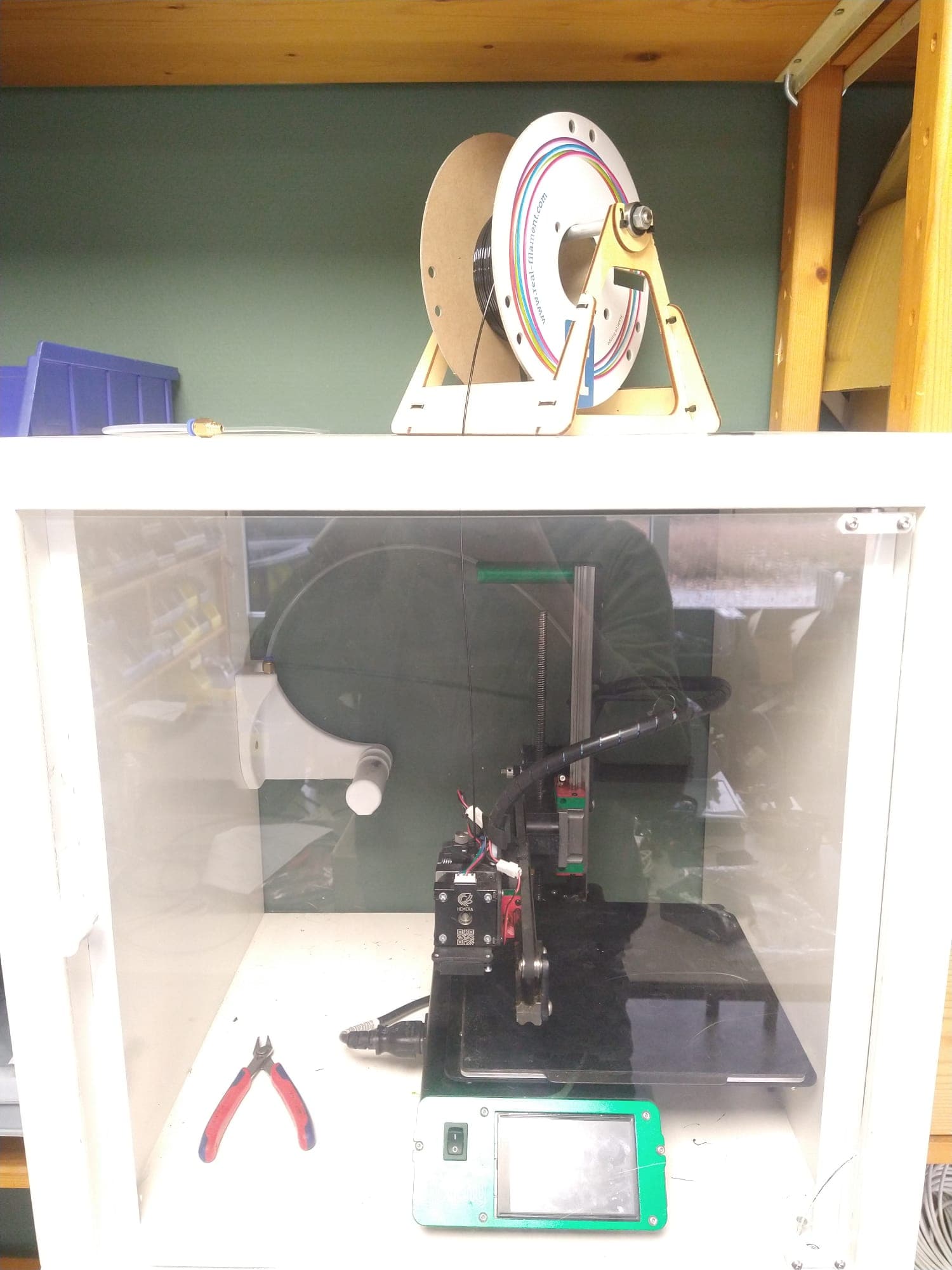

I always feed TPU straight from the top at work from a holder on bearings:

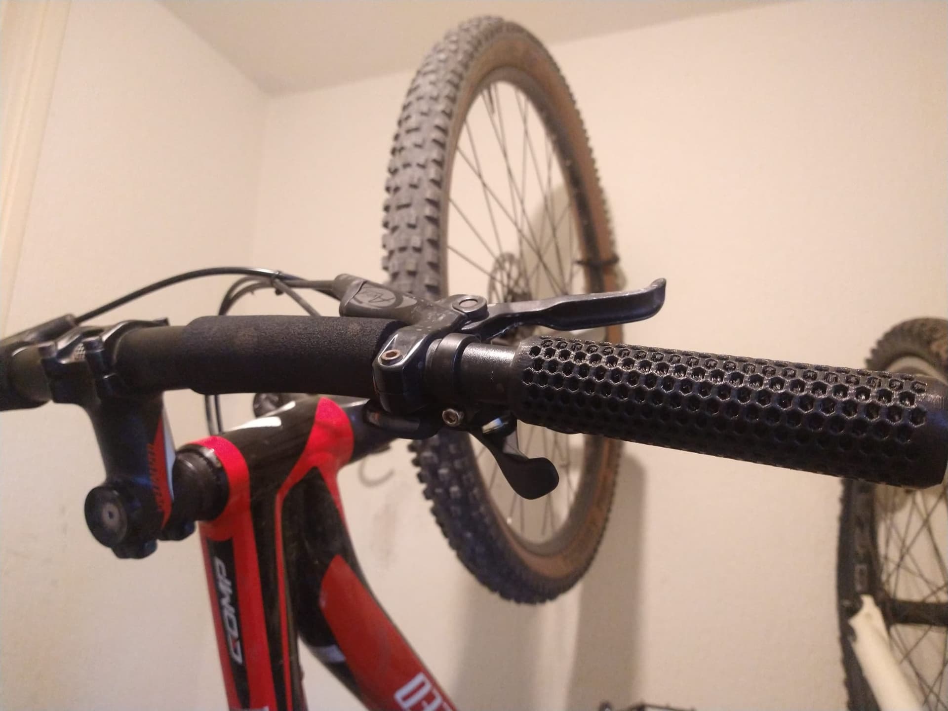

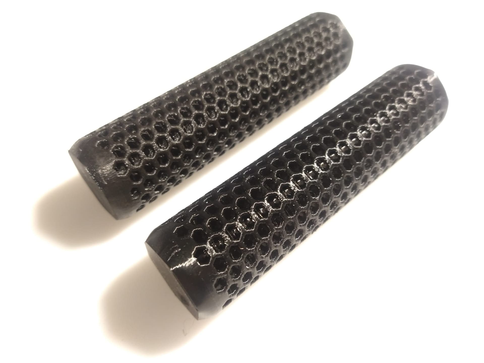

This is my HexGrips that I designed 6 years ago for my mountainbike. I will be uploading this design in the coming weeks onto MakerWorld so if you are interested please follow me over there:
https://makerworld.com/en/@Rossero/upload
But back on topic, it is these grips:

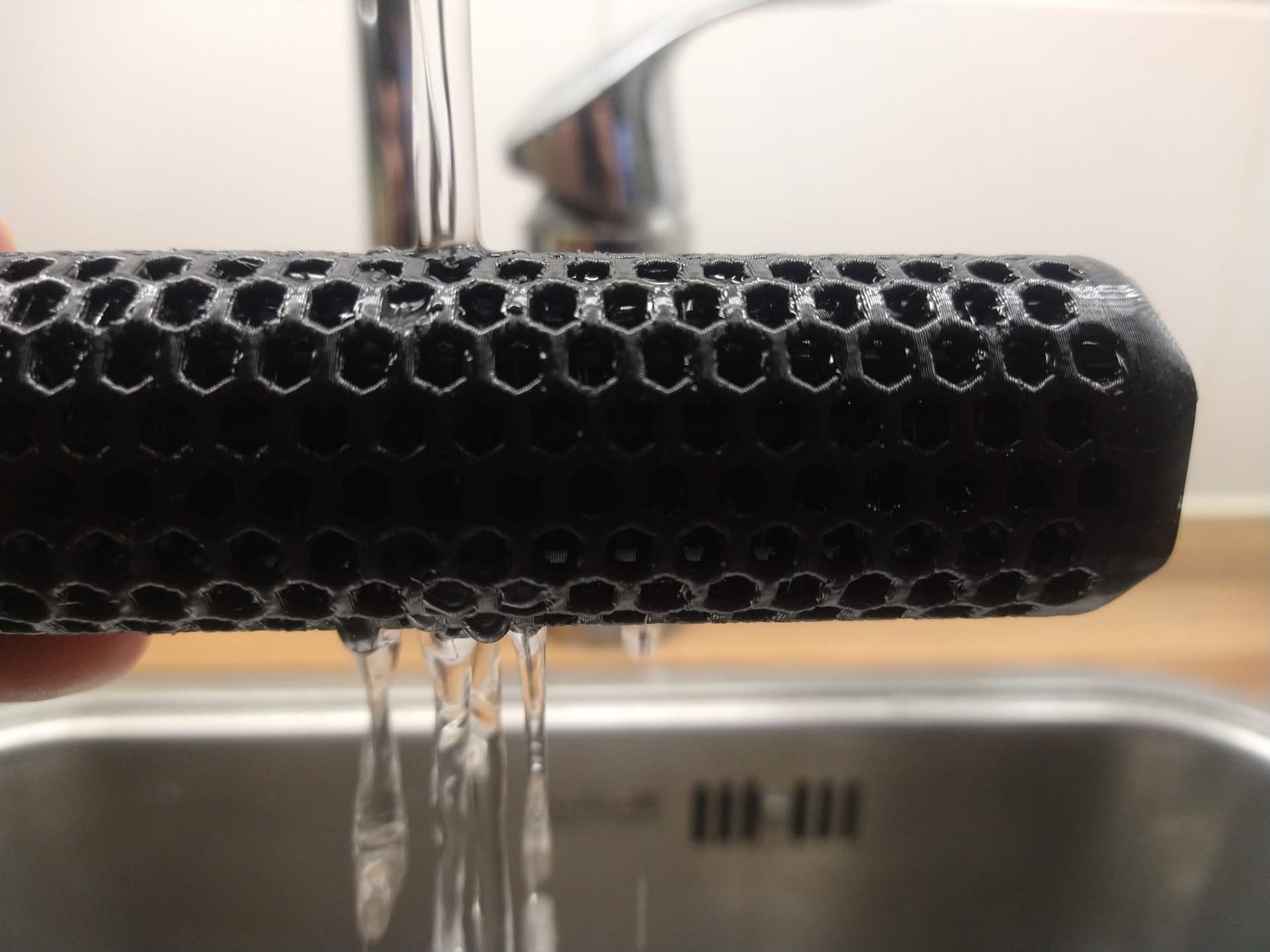

They are printed from NinjaFlex as far as I can remember and they are still going strong after all these years! Yay for TPU in general. The idea is that I get clammy hands when mountainbiking, which gets worse with gloves. So I designed grips that are “vented”, so it cools my hands and expels moisture through the internal structure (the wonders of 3D printing), here a demo with running water:

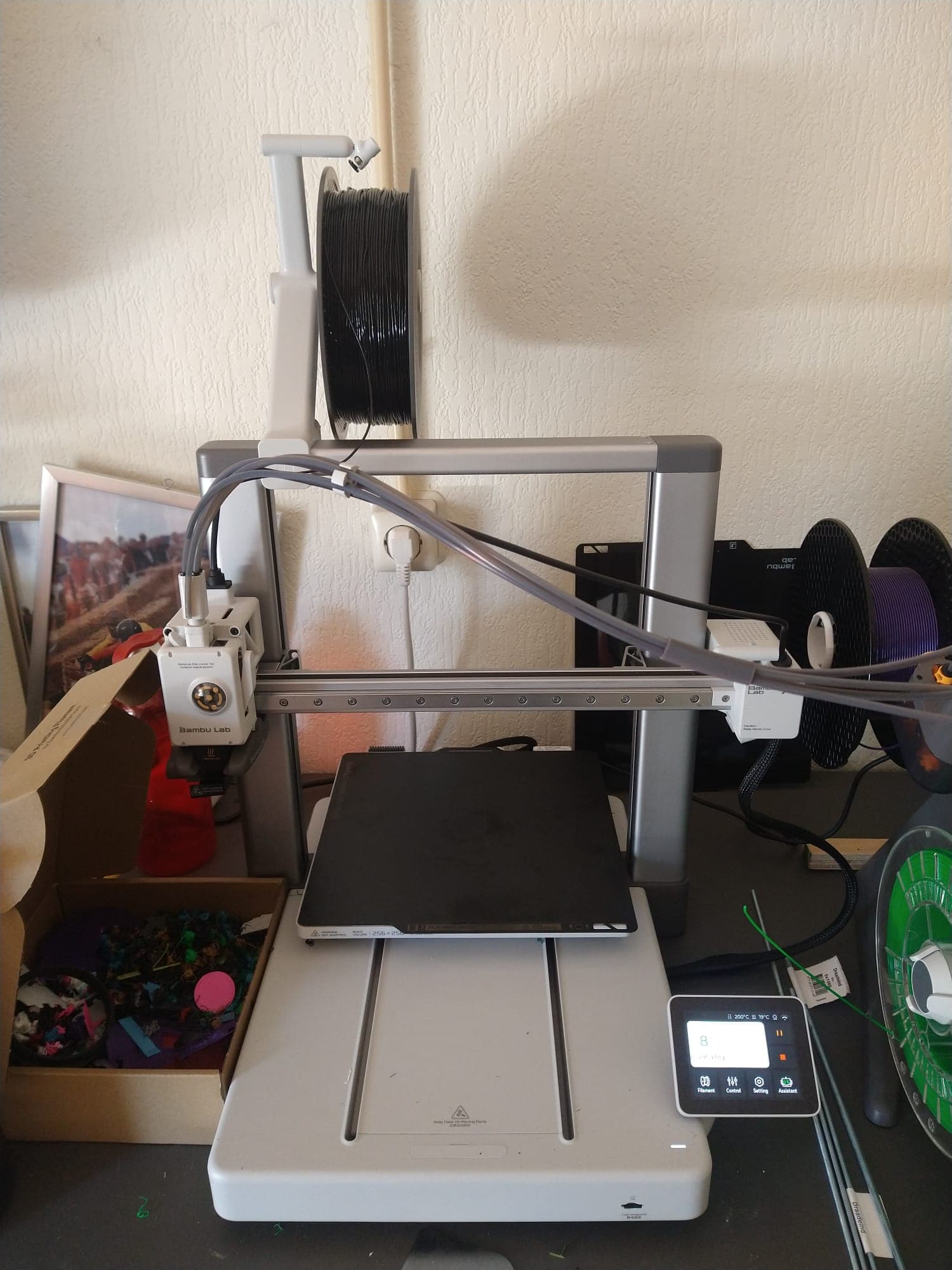

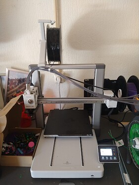

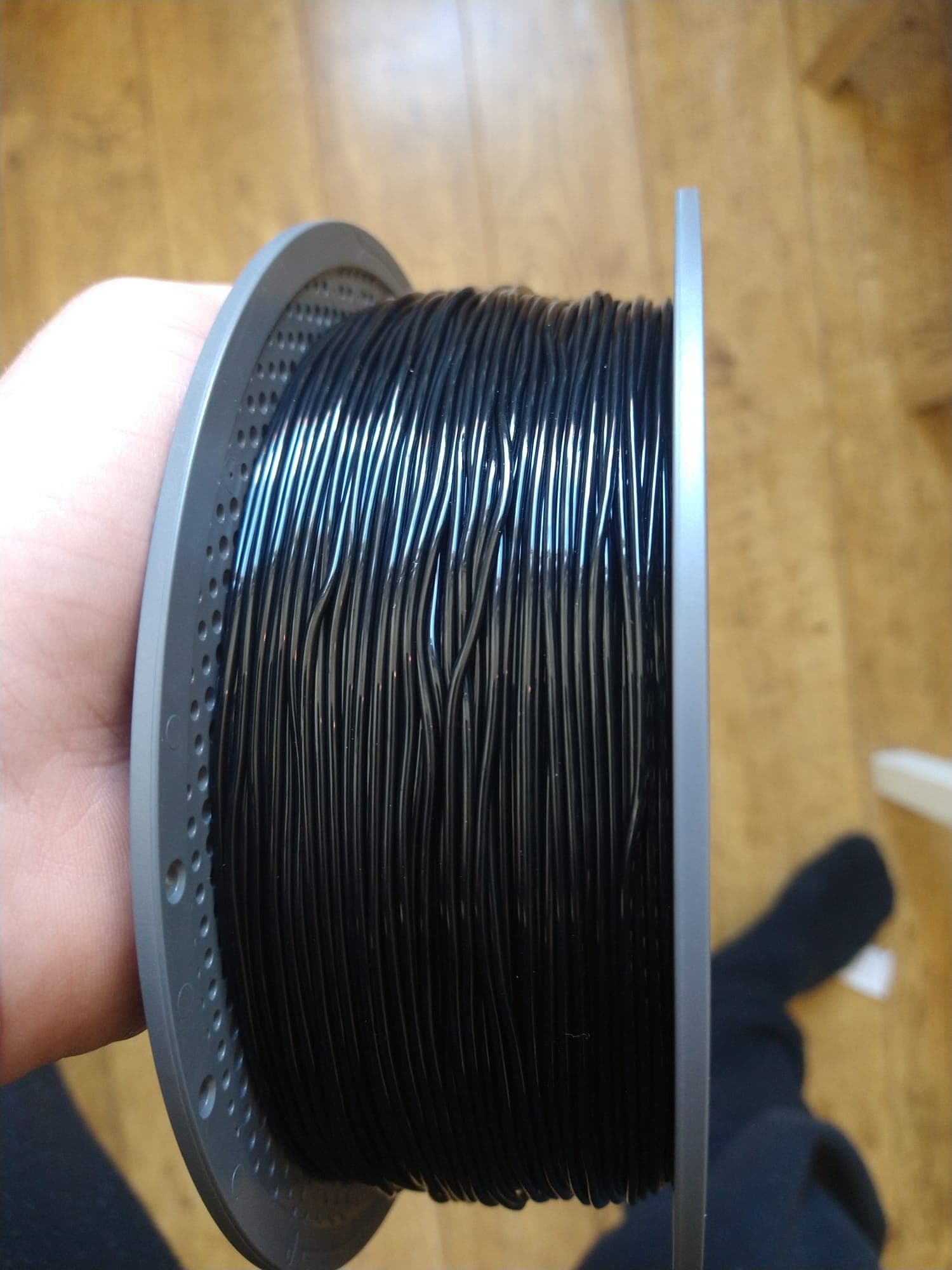

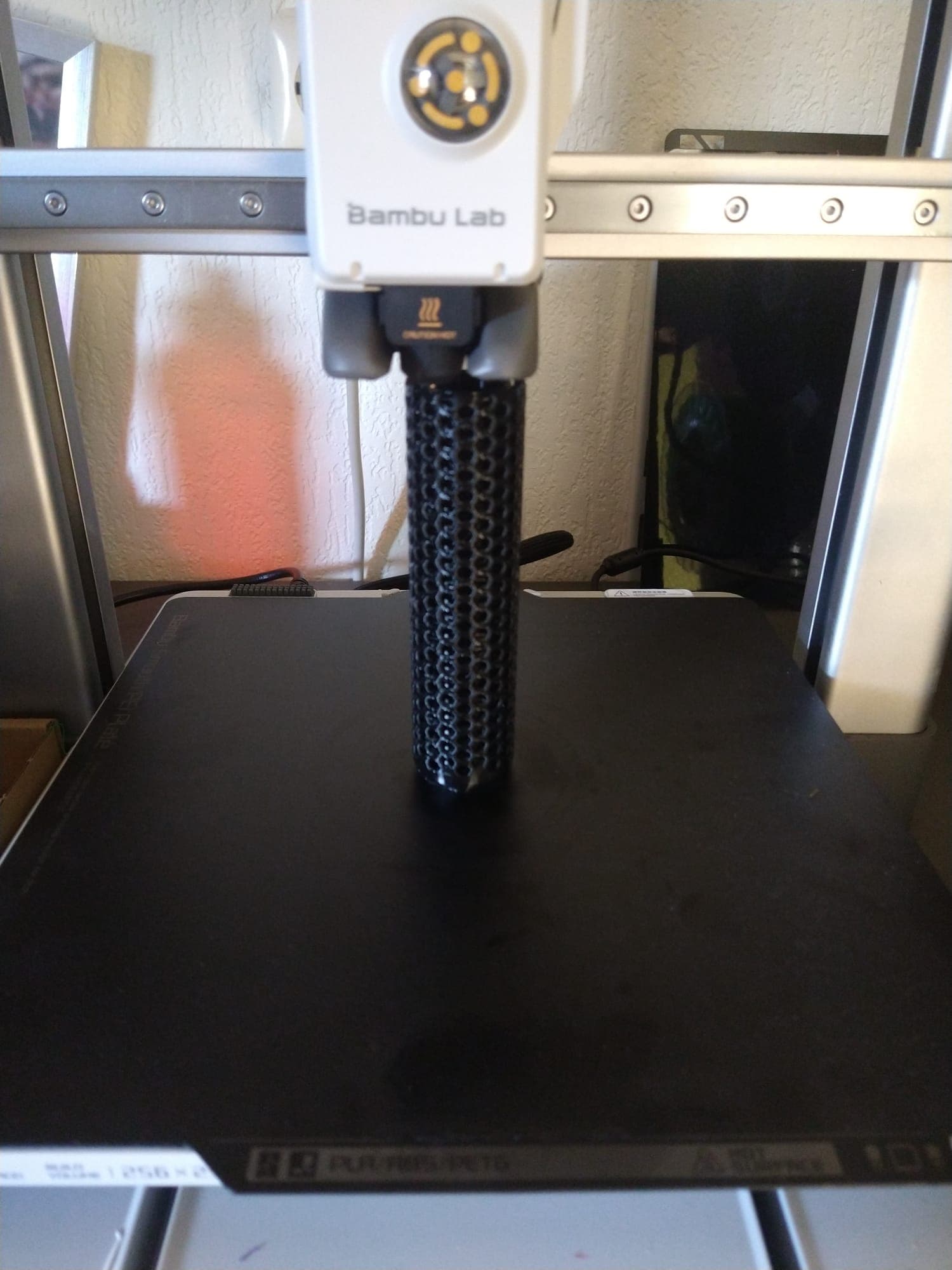

So I got to try the new TPU and I chose the 90A because at that time I only had the A1 which supposedly doesn’t print 85A. Here it is on the spool, quite roughly wound like wet noodles but it didn’t give me any issues yet:
Loaded from the top:

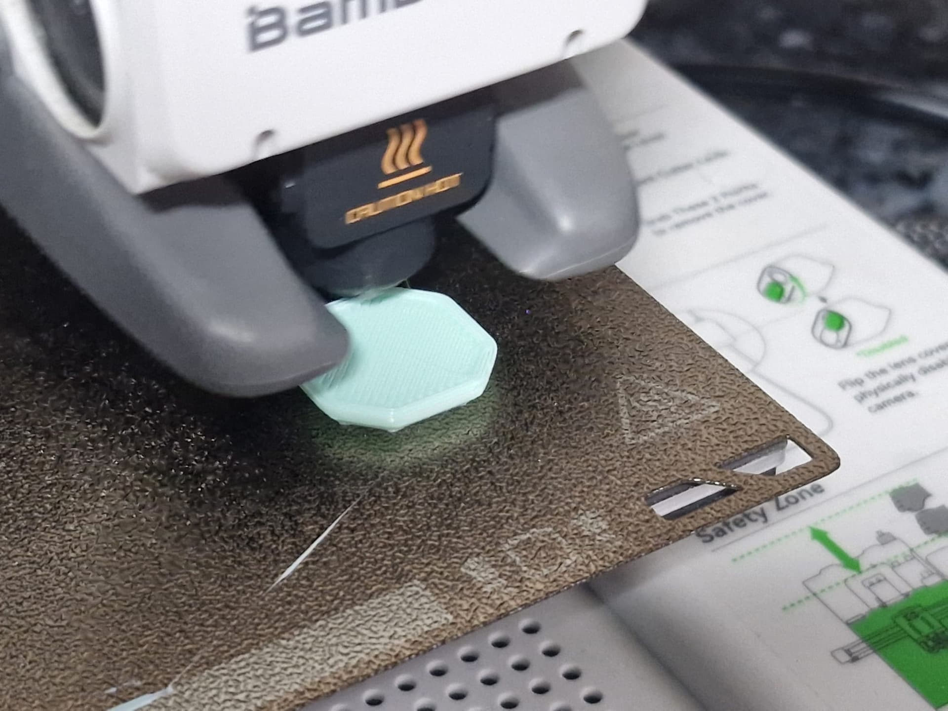

And here during printing. I had to really contain myself to not squeeze the grips during printing :joy:

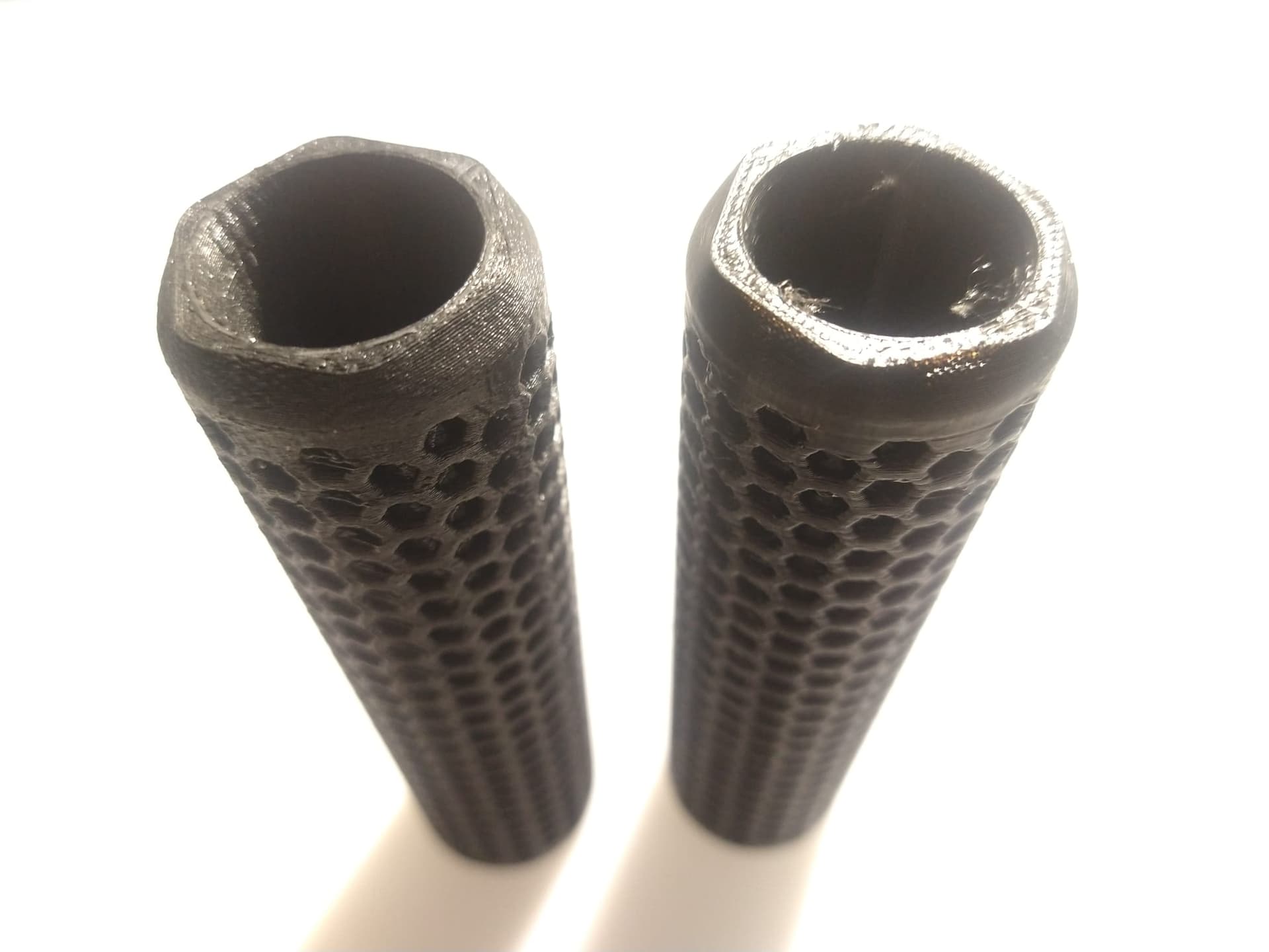

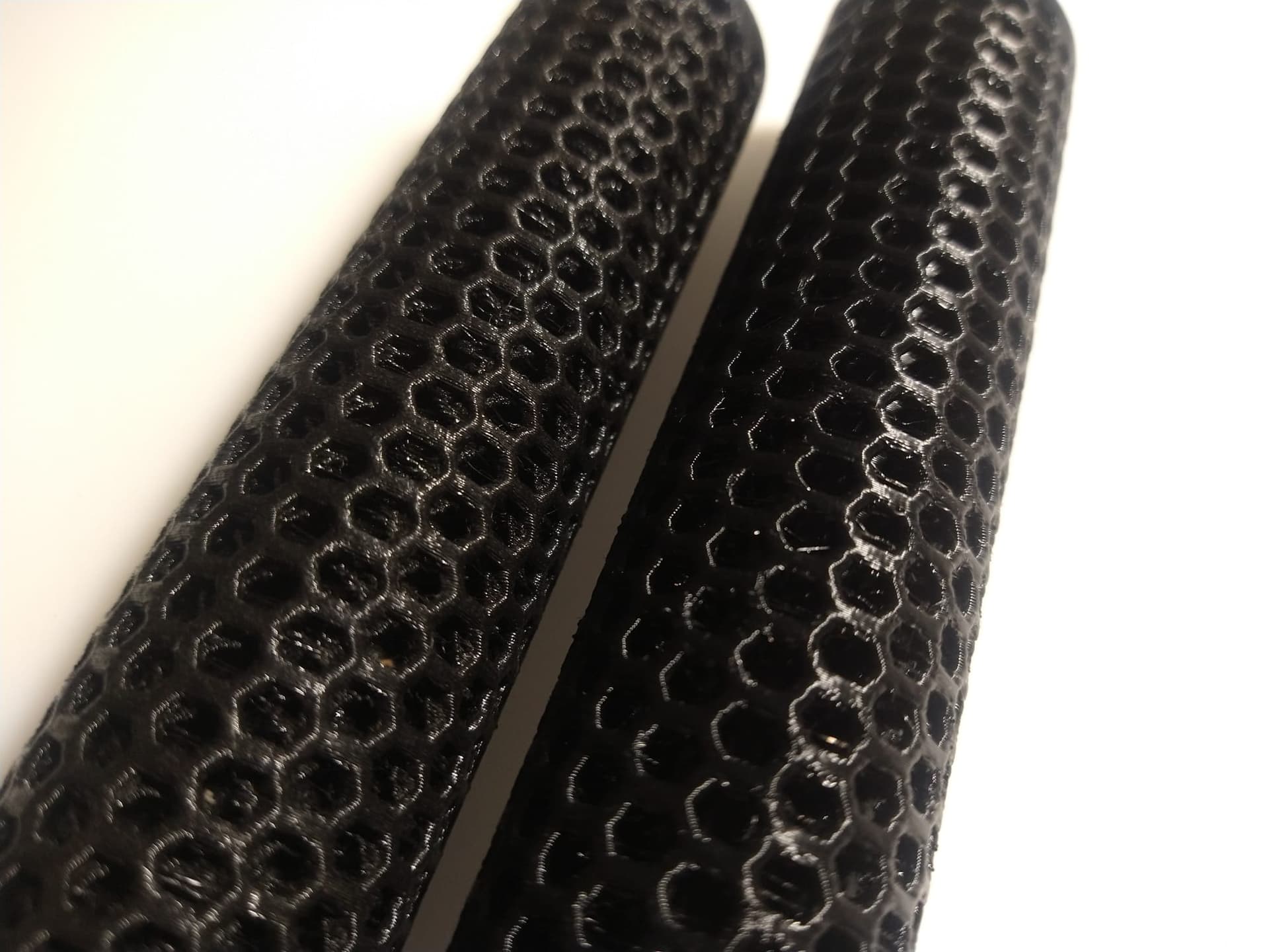

I have to emphasize that I did not dry the filament beforehand. I was explicitly told that it had to be dried but I did not have the means to accomplish that easily and I have never dried filament in my life. Some TPU’s have given me great issues and bubblefests and some have not (like NinjaFlex which seems to stay printable). Luckily, this one seems to print really cleanly without any tweaking or advanced setup. Left is the NinjaFlex one and on the right is the Bambu 90A:
The NinjaFlex seems to have more stringing inside the hexagons but the Bambu one seems to have more stringing and roughness on the inside. I think this is largely due to the travel settings in the slicer.

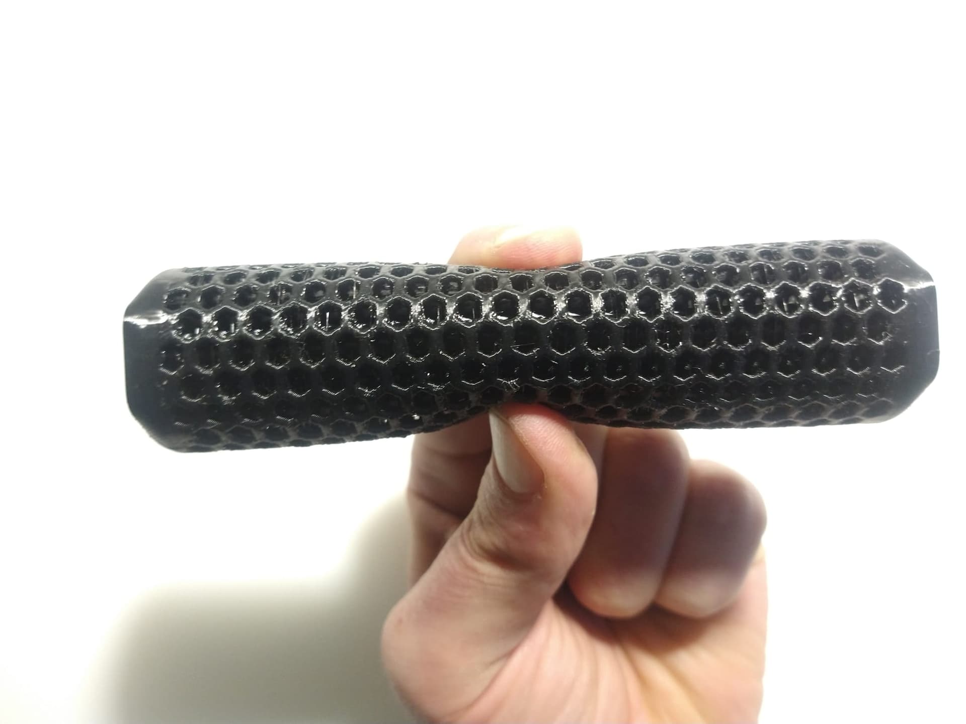

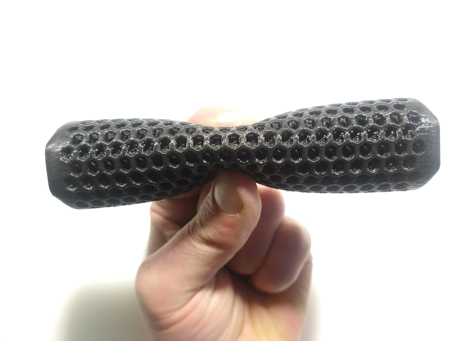

The Bambu 90A is tougher than the NinjaFlex though. Here is the NinjaFlex grip when squeezing:
And here the Bambu 90A with roughly the same force:

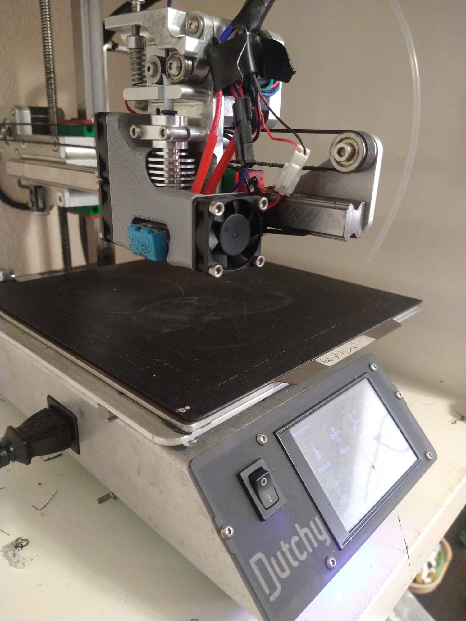

NinjaFlex is some of the most flexible filament out there so I shouldn’t be surprised, I think the 85A would be better. I am disappointed though that the 85A isn’t printable on the A1 series, which seems a shame. Especially since I printed the NinjaFlex on my 7yo Dutchy3D printer with quite a simple extruder setup:
And the A1 seemed to handle the 90A with ease so I wouldn’t be surprised if it could handle 85A as well.
Another issue I had is that I couldn’t select the Bambu 90A filament from my A1 screen when setting up the filament. I had to select generic TPU while generic TPU is far from generic since the hardness (and therefore settings) vary wildly.
All in all I am happy with the ease with which it printed and how cleanly it went. I wish however that the A1 would be able to print softer materials than this, since the 90A is still a bit too stiff for this application. For other applications it might be the right hardness so I hope this is a somewhat helpful review and I tried to be unbiased.
Still a big fan of my grip-design after all these years though (patting myself on the back) but I would suggest the 85A if you want to print them for yourself!

Those turned out great. When the extruder was doing the top layers were they swaying at all? It has so much flex you would think it would start moving with the bed.
Not that remember no. In my experience TPU suffers more from the nozzle rubbing against it than the movement of the bed. That said, this particular print (especially in NinjaFlex) is quite squishy in the squeeze direction but it doesn’t really bend because it essentially is a double-walled tube. Both on the A1 print and the Dutchy print there is no discernible difference in print quality between the bottom and top of the print, and the tougher 90A improves the print stability even more. Results may vary model to model though

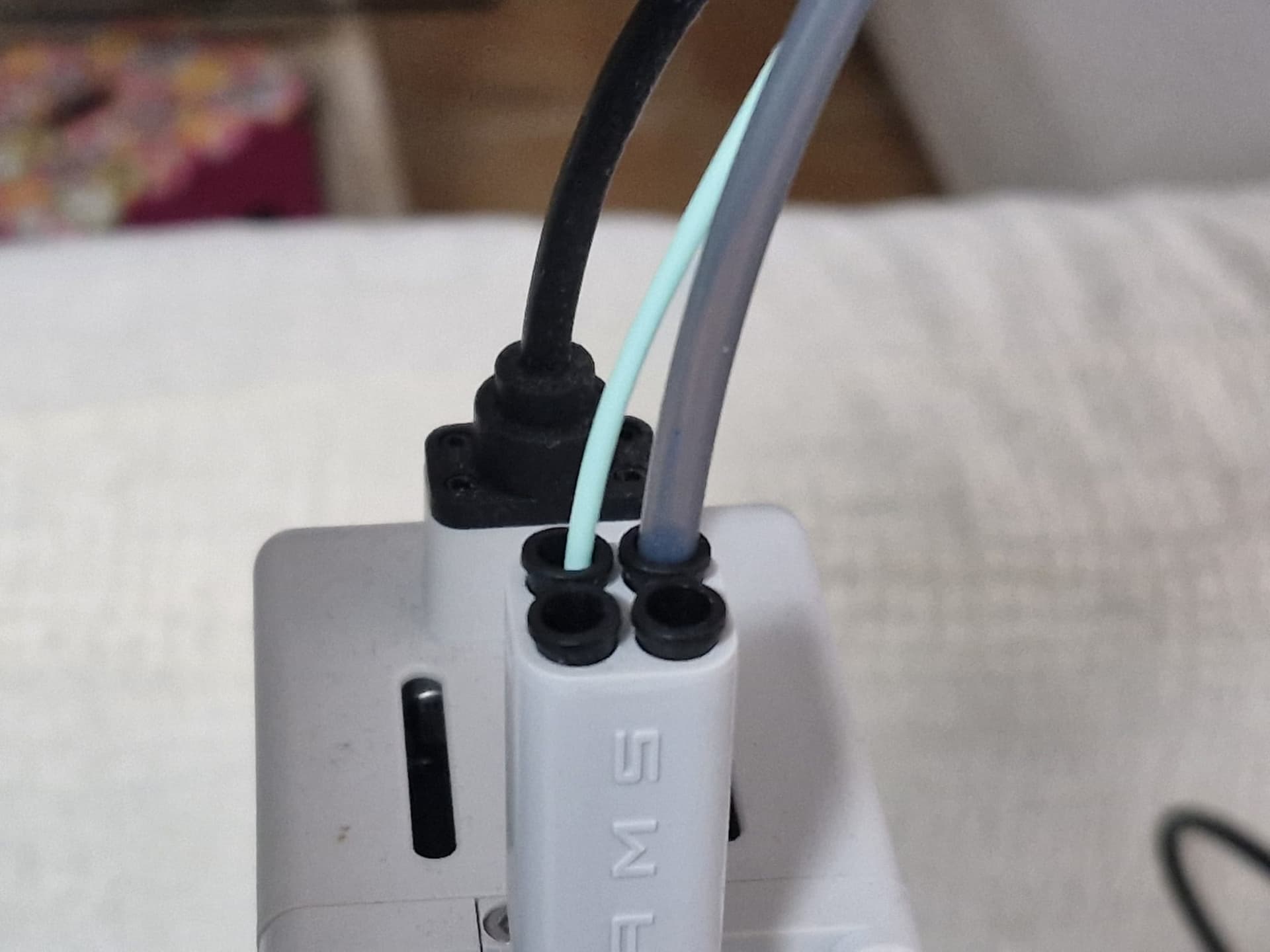

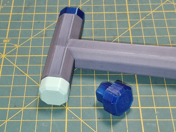

After posting about how I would like to test the new TPUs from Bambulab (BBL) in my Soft Hammers Set
BBL contacted me and provided a spool to test. I opted for the 85A variant.
The filament comes in a BBL high temp spool. They provide a comprehensive How To use this new type of filaments.
The A1 Mini is not listed as compatible nor there are instructions to use with those filaments so, let’s try it with my A1 mini. :upside_down_face:
BBL warns about the filament needs to by dried before use.
So I put it in the oven at 70ÂȘC for 8 hours as stated in the instructions.
The initial weight of the spool as taken out of the wrapper was:
1274.76 grams
After the drying it was:
1273.98 grams
so the spool lost 0.78 grams, supposedly of water. It doesn’t seems too much for me.

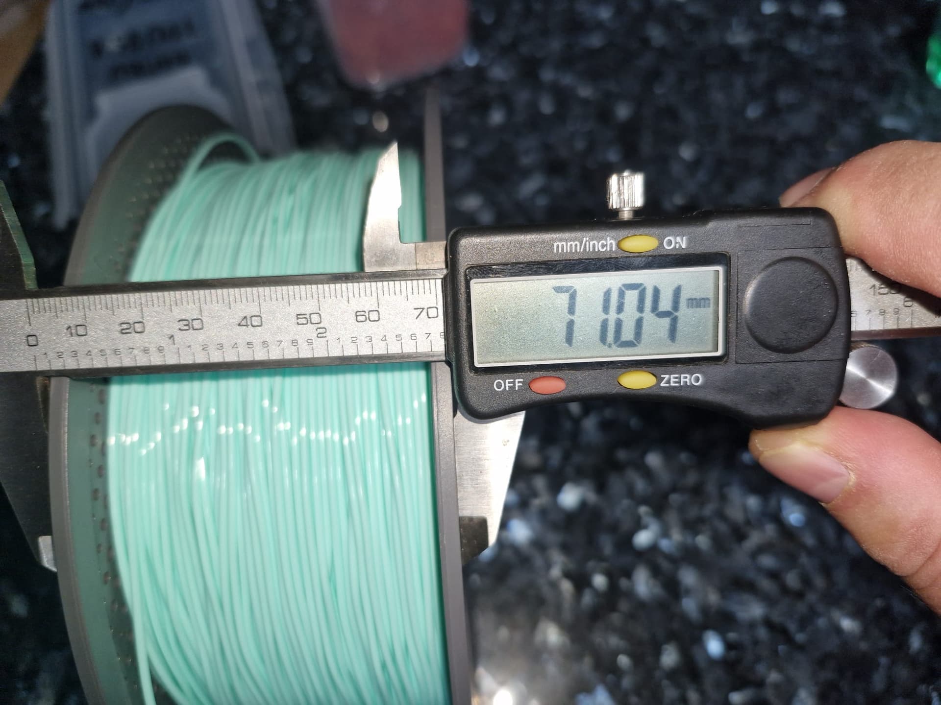

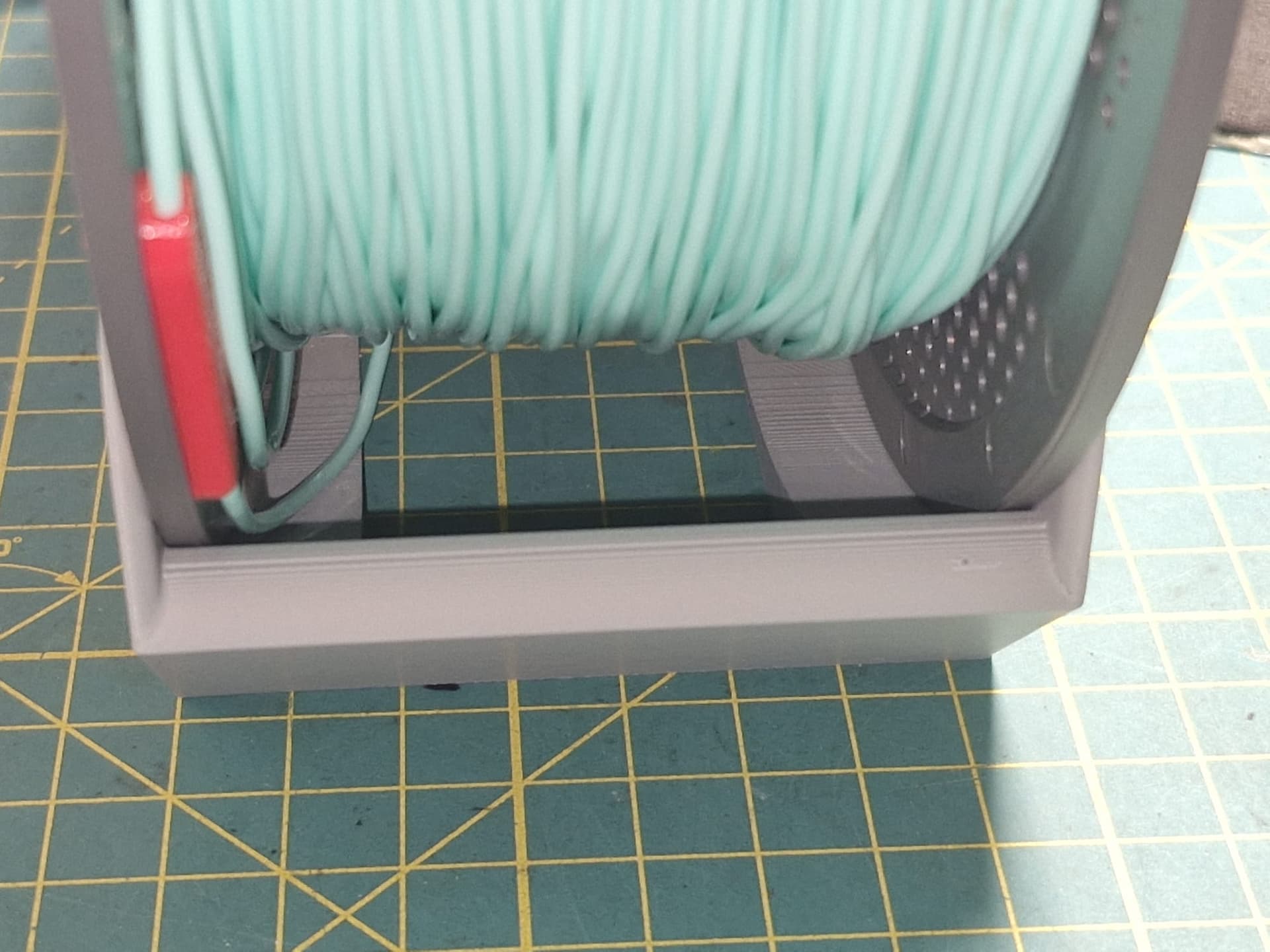

As they warn, the spool expands with the heat from the original 67 mm wide to, in my case,
But fortunately the spool still fits my BBL Spool holder for the Multiboard:
The filament is really soft and it must be feed to the extruder as free of friction as possible, so I feed it directly to the hub, no tubing used:

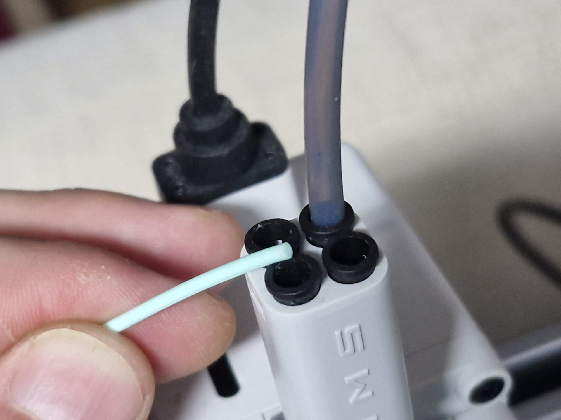

The A1 mini accepted it no problem, but clearly the extrusion volume is to low. It needs some manual purges to displace the previous filament:
The original heads of the hammers were printed in AMAZON TPU 95A using the Generic TPU profile.
There is no available profile for the BBL TPU 85A for the A1 mini so I decided to use the same profile used with the AMAZON TPU. No changes.

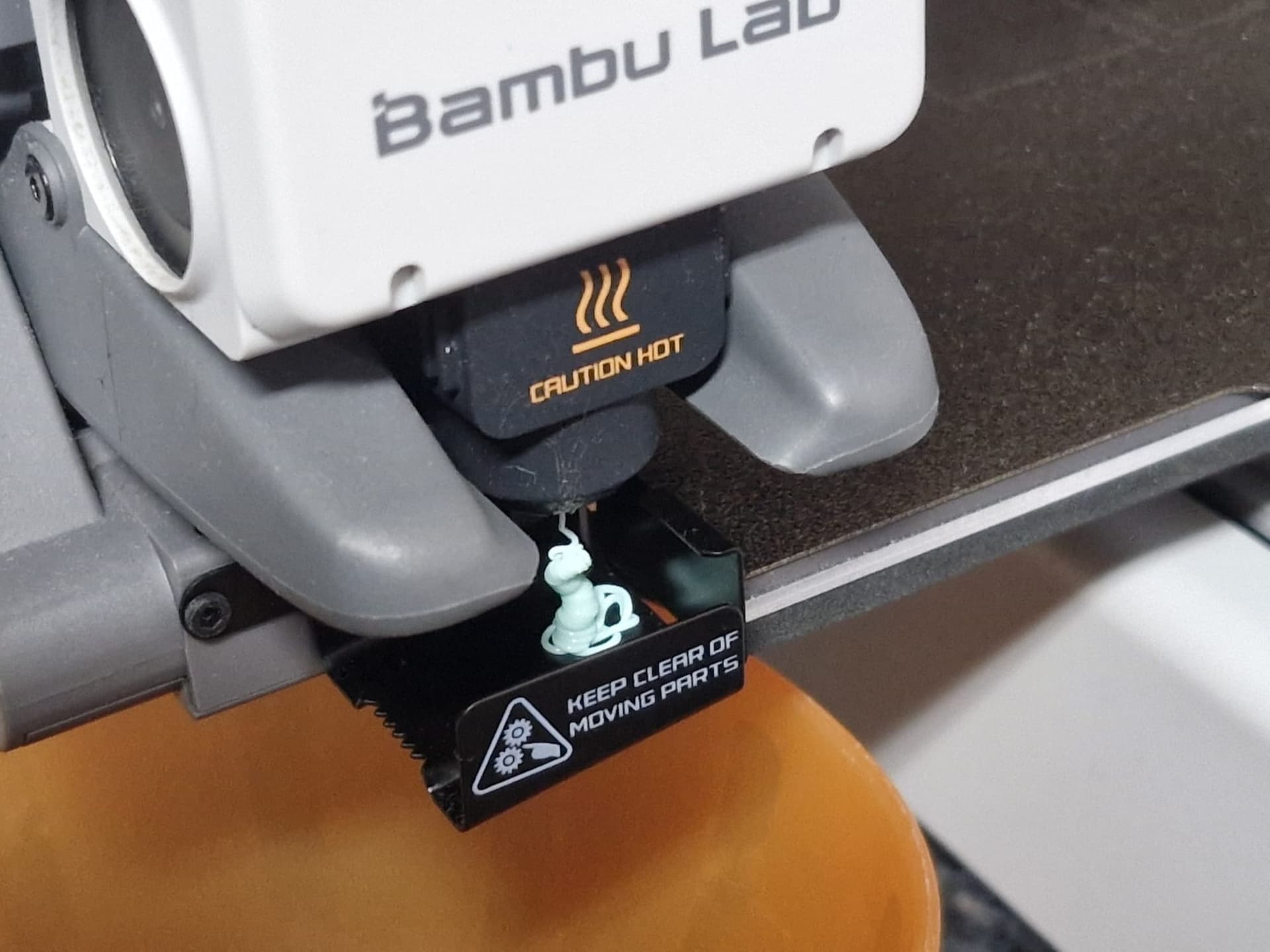

The printer started his job no complain:
The TPU would benefit of a little more flow ratio, but it finished the job:
The unload procedure worked as expected but a little help from the user is needed pulling the filament slightly. The cut is very clear:

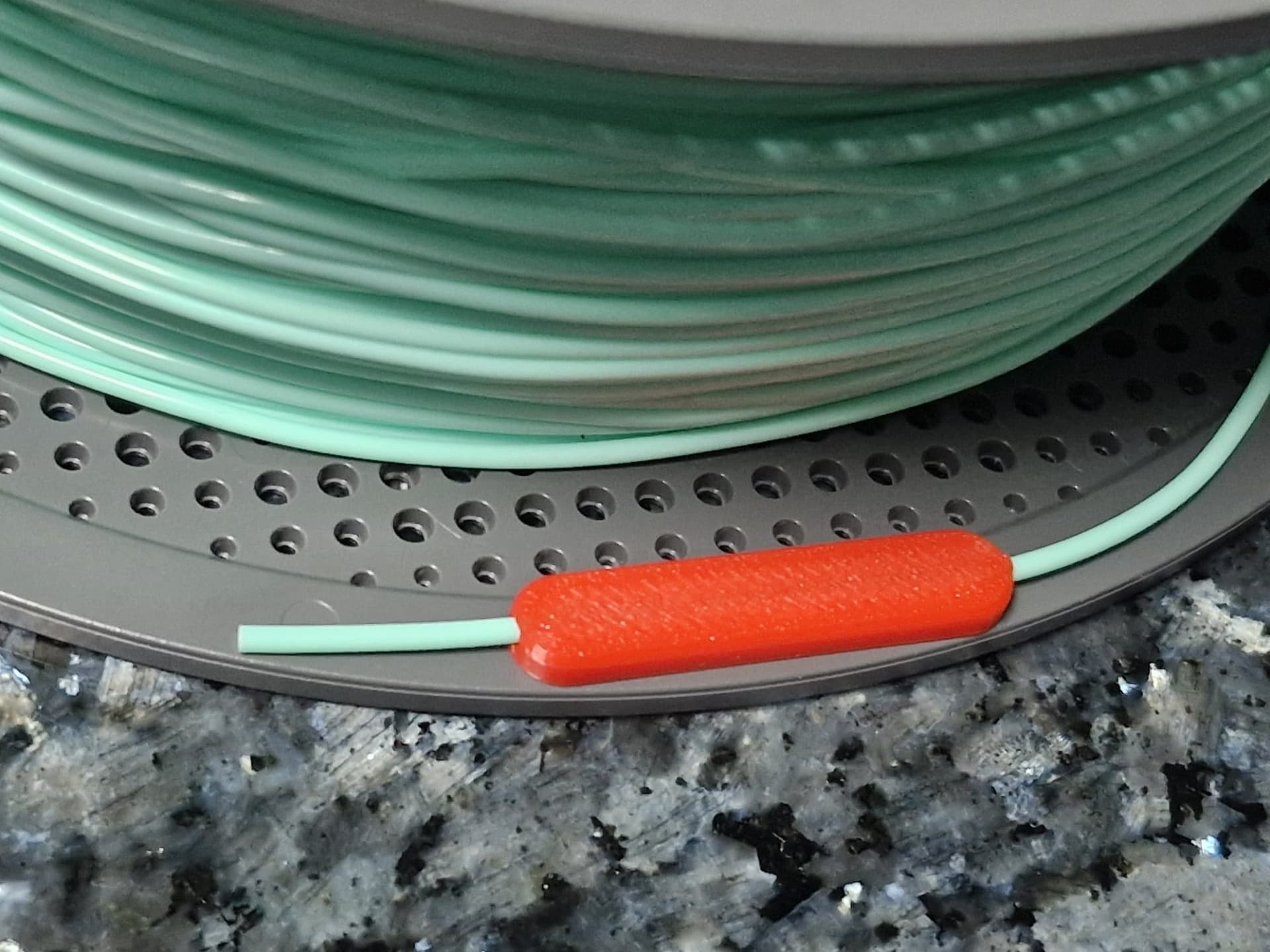

As soft as the filament is, it works perfectly with my clips:
In case you want to try it, this is my clip:

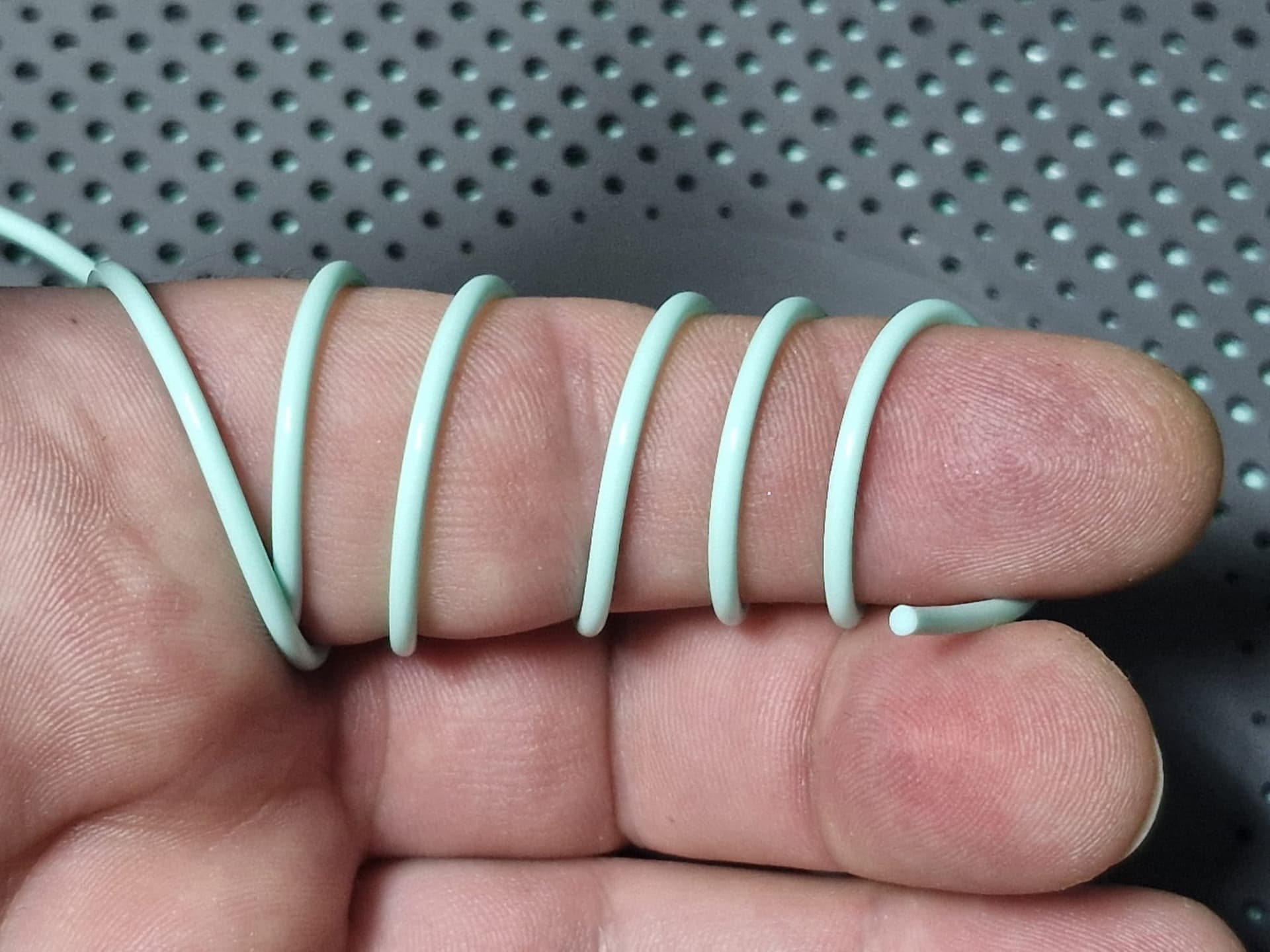

And speaking of softness:
This new BBL TPU 85A filament has a natural rubber touch.

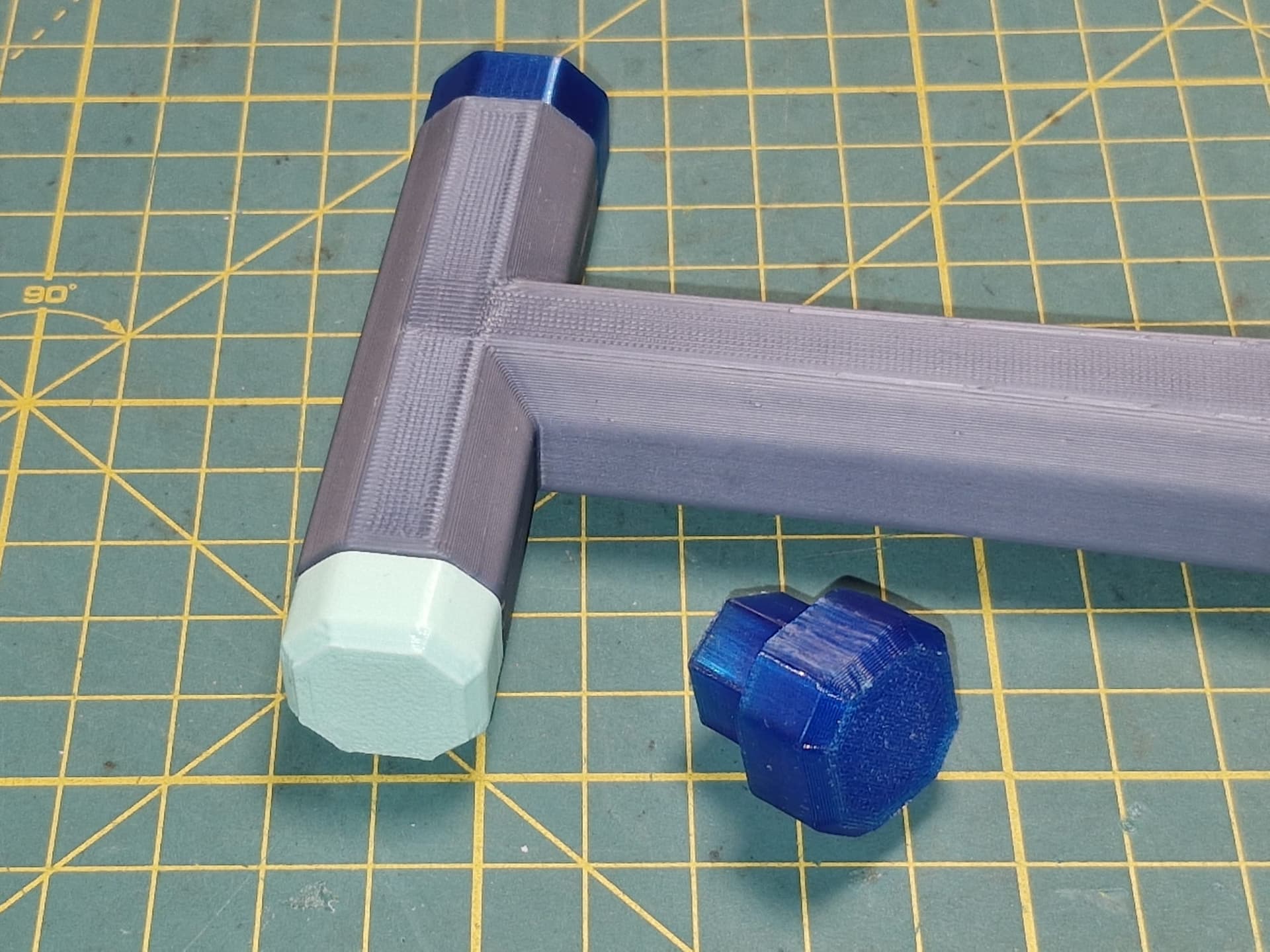

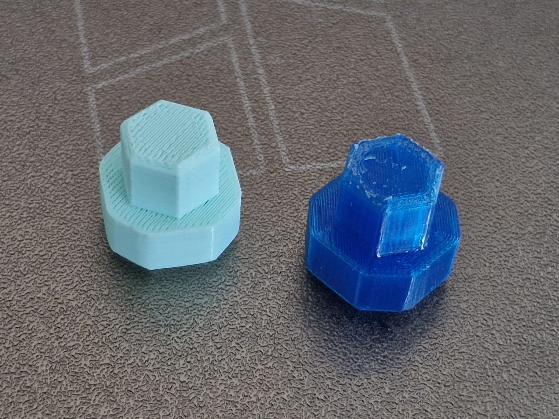

An image of the original and just printed hammer heads:

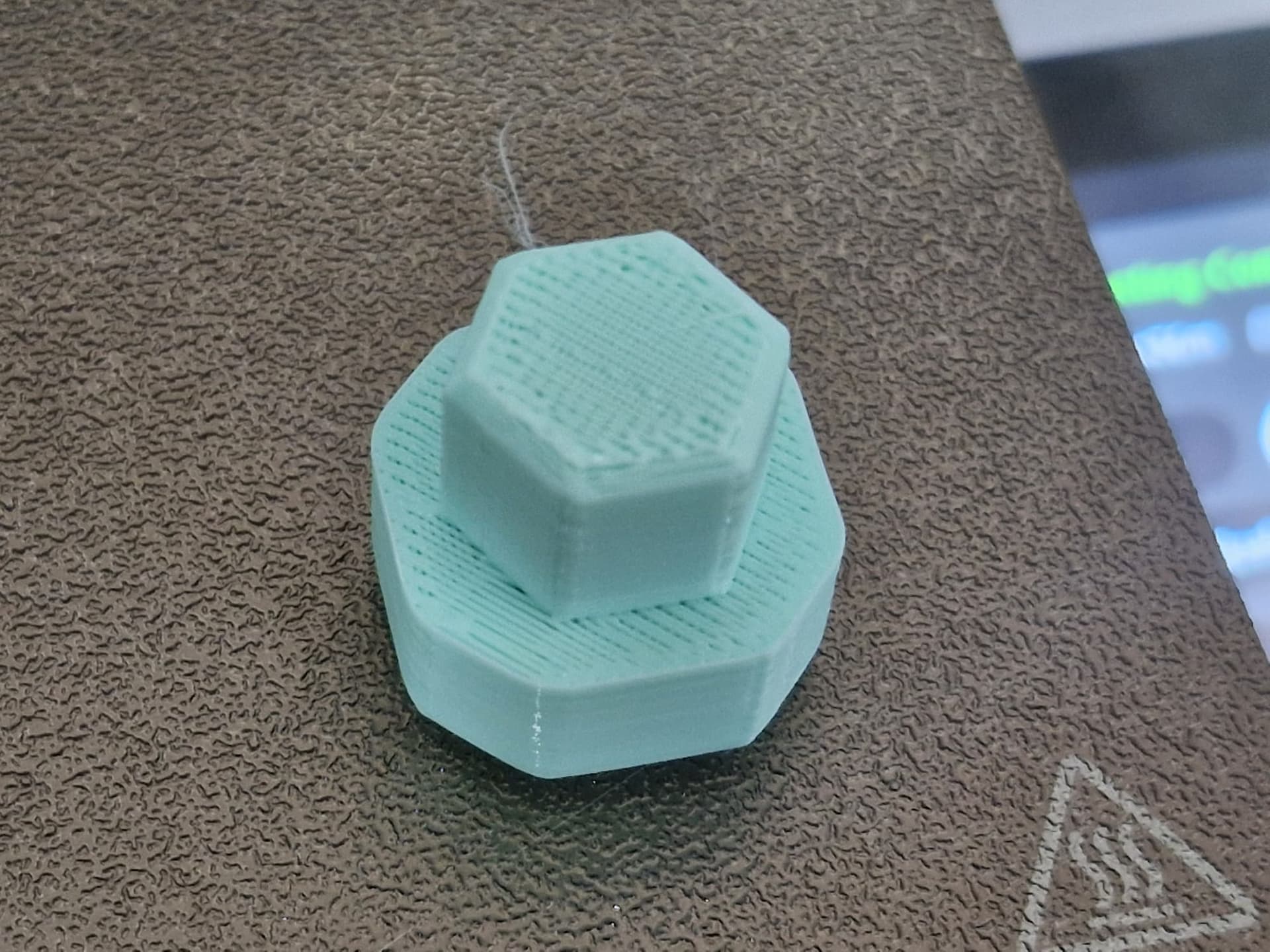

You can see the under extrusion. A calibration would help with this.
Nowadays the 85A is only available in two colors: Light Cyan (the one I used) and Neon Orange (this was out of stock). Strange color options.

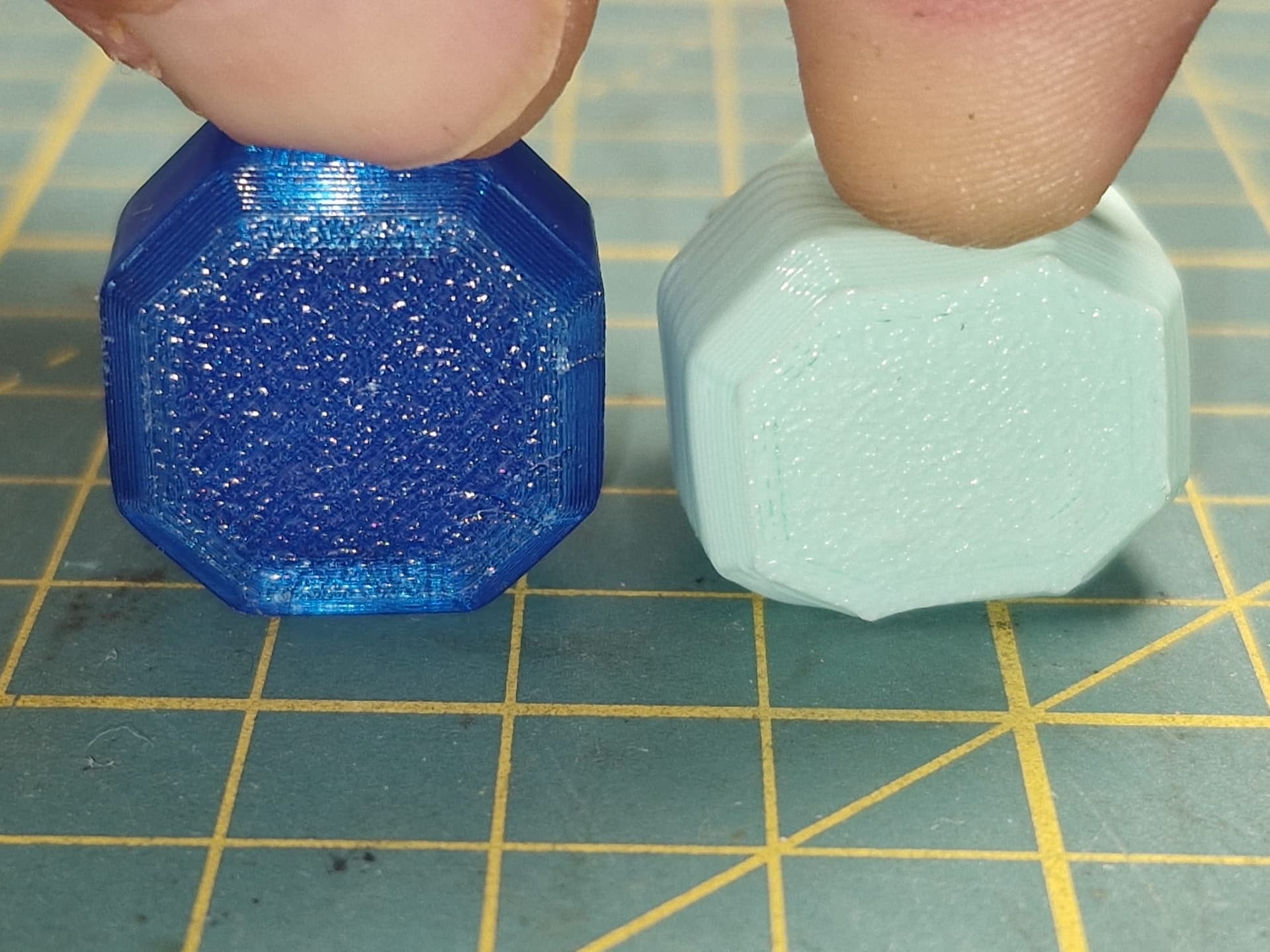

Comparing elasticity:
The TPU 95A for AMAZON was not affected at all from my finger pressure.
And this is the final aspect of one of my hammers, now with a dual head:
