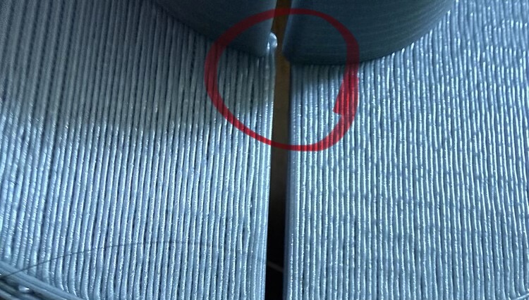

Hello,
I would like to print the two halves of a cylinder that are supposed to be held together by a connection.
Everything fits in the drawing, but the two halves of a printed test cylinder do not fit together exactly.
What could be the reason for this?
The surface on which the support structure was located (I printed the parts upside down because a 30 mm support structure is required there, whereas the other way round a 100 mm support structure is required).
Kind regards
Proape
You have to design for printing, not for the CAD precision available.
Your drawing is very precise, a good thing, but you are not considering how things print.
Firstly, look at the centre if your print, that surface exceeds the way you drew it, likely the same reason the whole of that surface looks bad, it appears to be the underside of a supported print.
The design you have used to connect it at the edge is too small to do the job and doesn’t take the way FDM printers lay down filament into account.

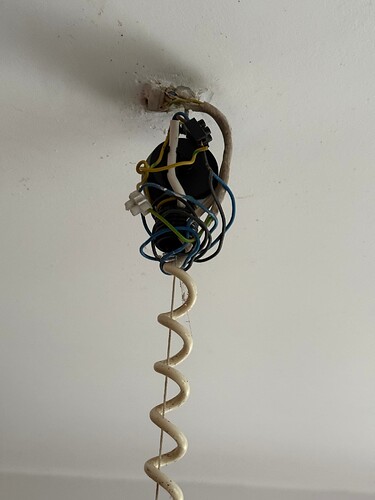

  • What is the part meant to do?
    It’s supposed to hide the cables of a hanging lamp.

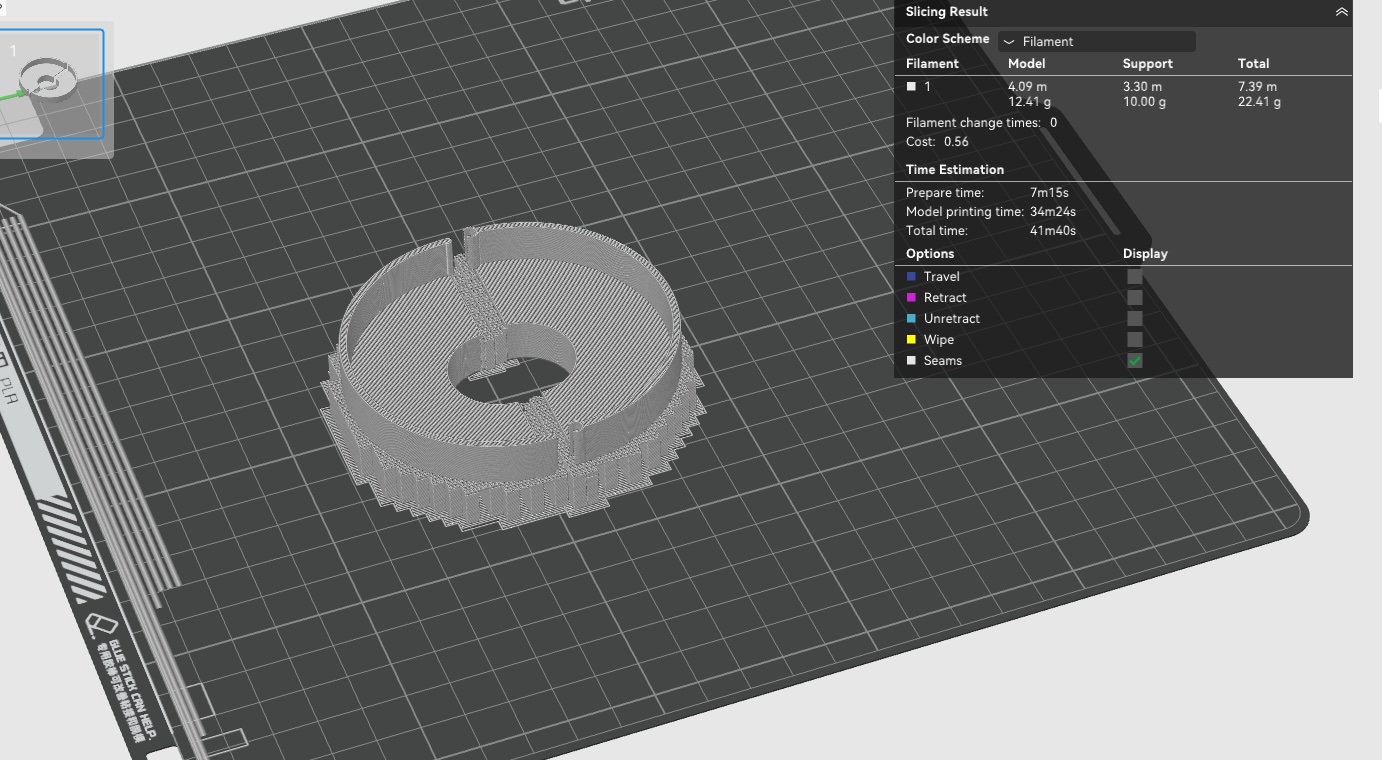

A picture of the sliced plate of my test:
Zylinder test.gcode.3mf (169,6 KB)

  • Are you hoping to hide everything around the black thing, whatever that is?
  • Is this mounting to the ceiling somehow?

I made the diameter of the big cylinder 73mm and that of the small one 24mm, hoping that that will fit and that the small one is tight enough to hold onto the spiral cable.
no (see my previous answer)

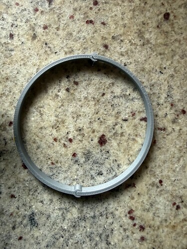

I wanted a self-locking connection. I had first printed a ring with a height of 5 mm, and the connection worked perfectly.
The connection is identical except that I have attached a male and a female connection to both parts. I also made the walls of the female connection thinner so that the male connection could be inserted.
The joint you just made will slip out, the end of the semi-circle will also need to be bigger.
Hold one first in your other hand.
The fist is bigger than the wrist, the hand bigger than the fist, each locks itself in.
In short, your male part needs a bell-end!
You should also have both one male and female on one side and then reverse them, one female and one male on the other side.
So each half has a male and female part to increase the strength and increase the chances they remain together.

I cannot confirm that; the ring holds together (well enough).
Luck is always good.
But, you only have fiction on either side, no compression force to restrict and add pressure to the make connection.
It will fail with some time and if you connect and disconnect a few times.
It should only be attached once and then never removed again.
The fact that it would not hold is not a problem, as I cannot join both halves cleanly anyway and my idea therefore does not work.
