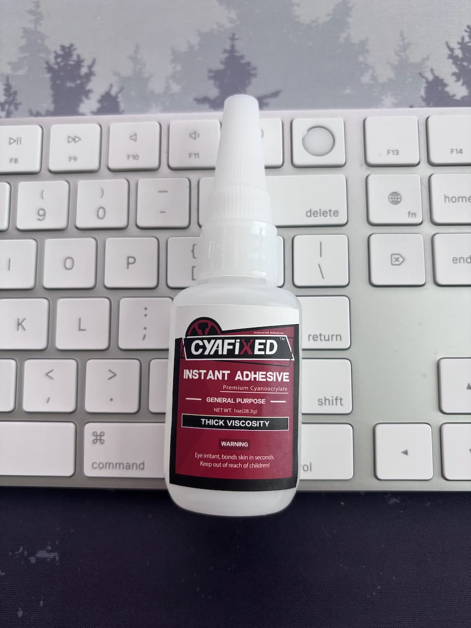

This was recommended by someone on reddit. I’ve been using it for a couple weeks and so far it’s been doing well on pla. Anything I’ve tried to pull apart has been ruined before the bond broke.
This is the exact same brand i’m using. One thing to watch out for - it off gasses a lot. I’ve glued parts together, put them in a box, and came back the next day and they were covered in a white haze. Just make sure you let them cure for a day or more before sealing up any parts.
The other thing I don’t like about it is that it expands when it dries, so it pushes parts that were flush apart a few mm. I haven’t found a solution for this aside from leaving more space in the model for the glue to expand.
Oh, I didn’t know that. I’ve been using it to glue in things like eyes and small parts. I guess I should look for something else for larger parts then.
