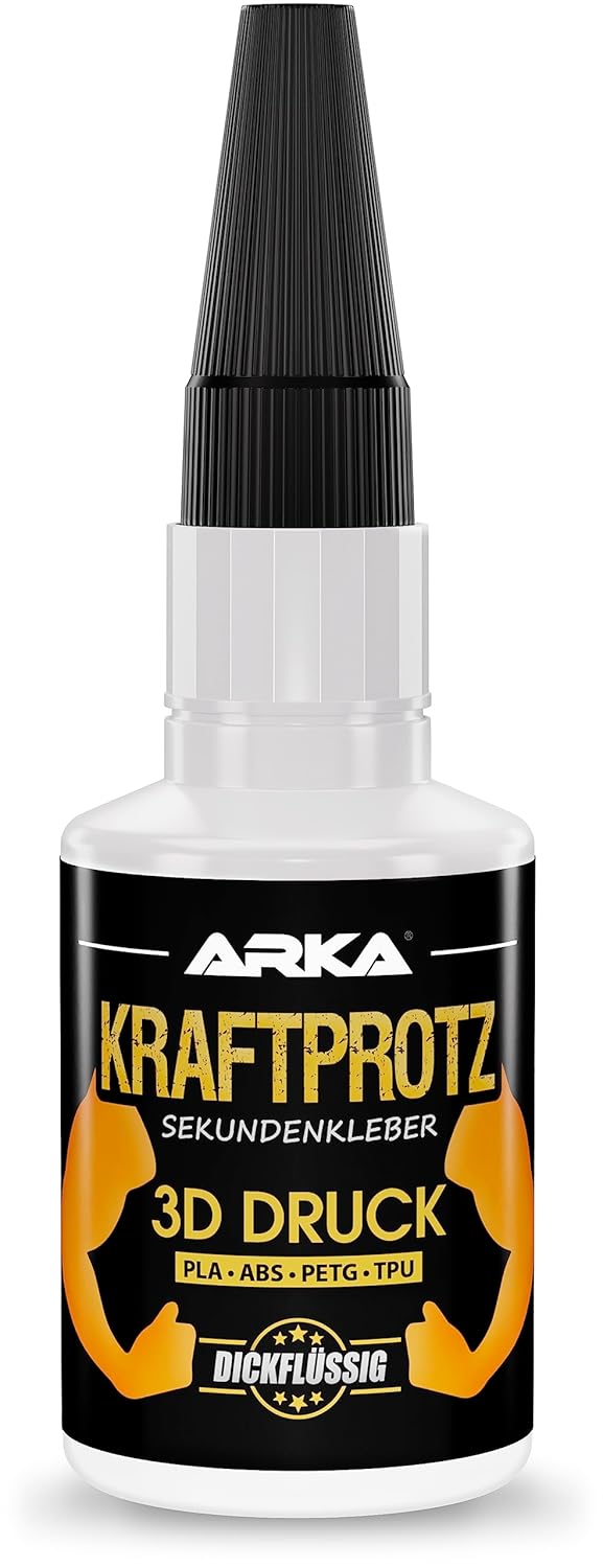

I’m using plain super glue but I usually add pins and holes if I want a part to fit snugly.
What is the active ingredient? Perhaps it is more widely available outside of germany as the generic than as the brand name.

The chemical in pla prevents most glues from sticking. Same logic as to why they sell glue in a plastic bottle - certain glue just doesn’t stick to certain things.
For pla the surface MUST be scuffed and the glue must be pure Cyanoacrylate.

I’ve used this 1st link (cyafixed) for over a decade now 0 problems all the monster hunter swords I just posted were glued with this. This is my workshop superglue for 99% of most things.
The second link cameo I recently got for testing and it’s also working very very well with much bigger bottles and applicators for the price. I am still testing this :
Mini edit : just battery tested this on multiple scrap pieces to see. Very liquid, don’t need a lot, scuff first no problems across all filaments from silk to petg. I don’t have abs to try but should be ok.
I like this brand as well now even though it’s new because of the massive 2 bottle vs price.

The above in my original I posted (both) are pure, there is only 1 ingredient on the label. Cyanoacrylate.
Mugg - I agree on the cra in the link above, but your 2nd link is for contact cement basically lol. That will bond anything so kinda cheating haha but ya, if you want stinky but works yes…any contact cement will bond most prints.
Just go no additive CA. That’s what we basically discovered as why not all working - some are additive.

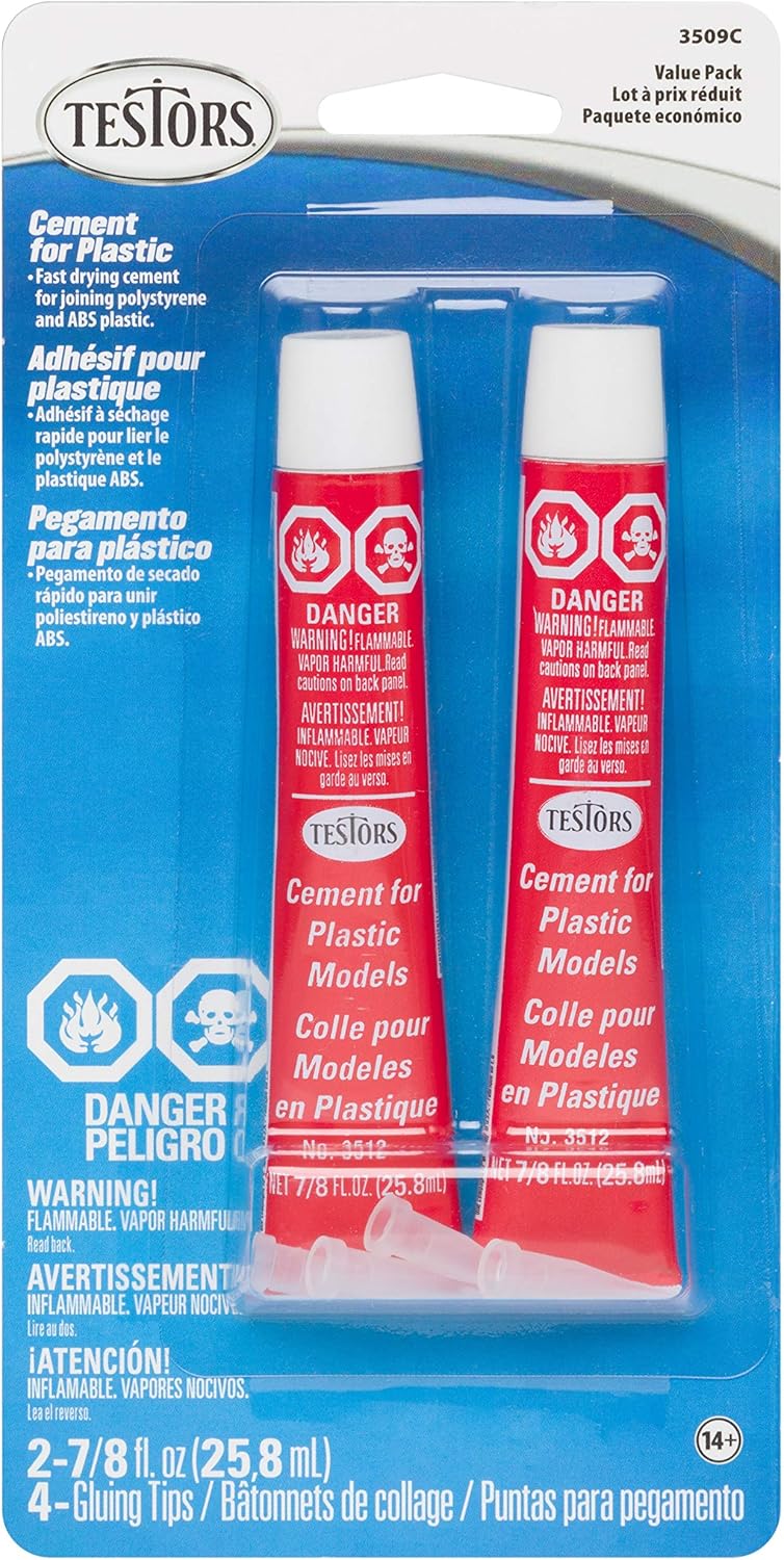

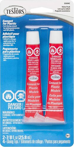

Yes, I’ve not been clear as to what I call a satisfactory bond. In the fifties when I was growing up and sniffing hadn’t yet become a thing, I would buy plastic models and put them together with the glue available at the time for such models. Once you glued the wing to an airplane, you weren’t getting it back off without breaking it. I guess that’s what I would like to see. But-- that’s really a ‘weld’ instead of a simple adhesion and it probably ain’t gonna happen in my lifetime.
Have you tried this?
No I haven’t. I’ll probably give it a try. Testors has been around forever. Thanks.
