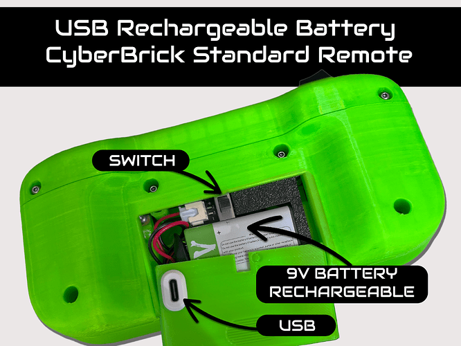

The remote really needs more that 4.5V, its totally unusable via 3x AAA - I Finally figured out a easy way to create a USB Rechargeable Battery CyberBrick Remote - Hope it can helps
I find this difficult to believe. Literally ALL of the circuits in the remote run off the VR in the core, which produces 3.0V. The VR is a low drop out regulator so 1.5V of margin is plenty. Now what IS true is that 3 AAA batteries will drain very quickly running a remote. So more mAH would help a lot.
