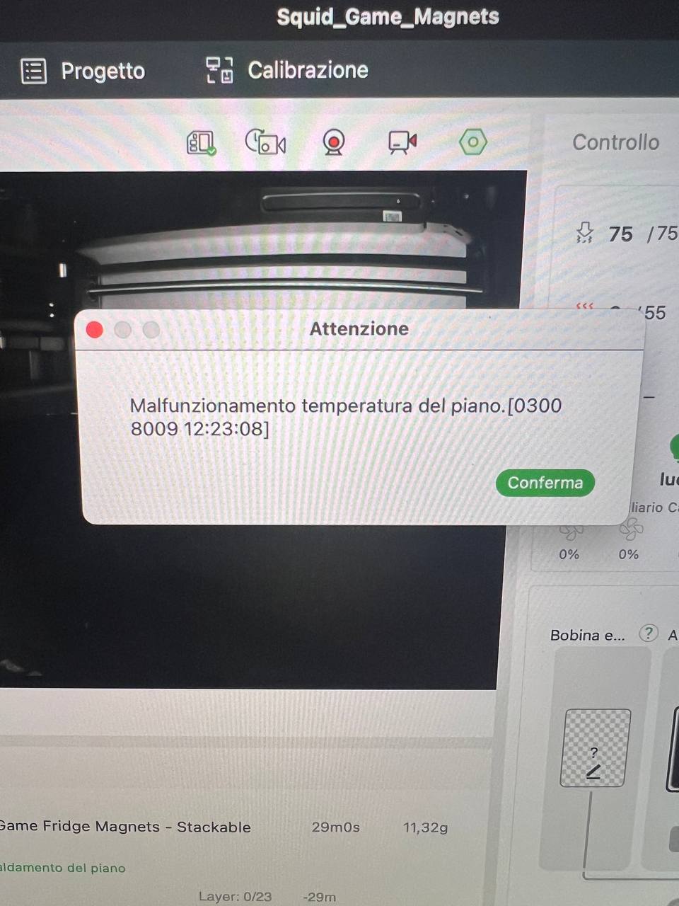

This error appears on every print
Hi everyone, can someone please help me? Does it come out with every print?
Well, in my non italian speaking opinion. You may want to check the temperature of your piano.
On the other hand, you may want to check this wikipage: Replace the Heatbed Sensor Unit / Heatbed Piezo Interface Board | Bambu Lab Wiki
Looks like the same error I was getting. See this thread
Go to the control menu and manually enter a bed temperature like 65C and watch the display to see if it starts to go crazy like mine would. I have a video in that thread I linked.
