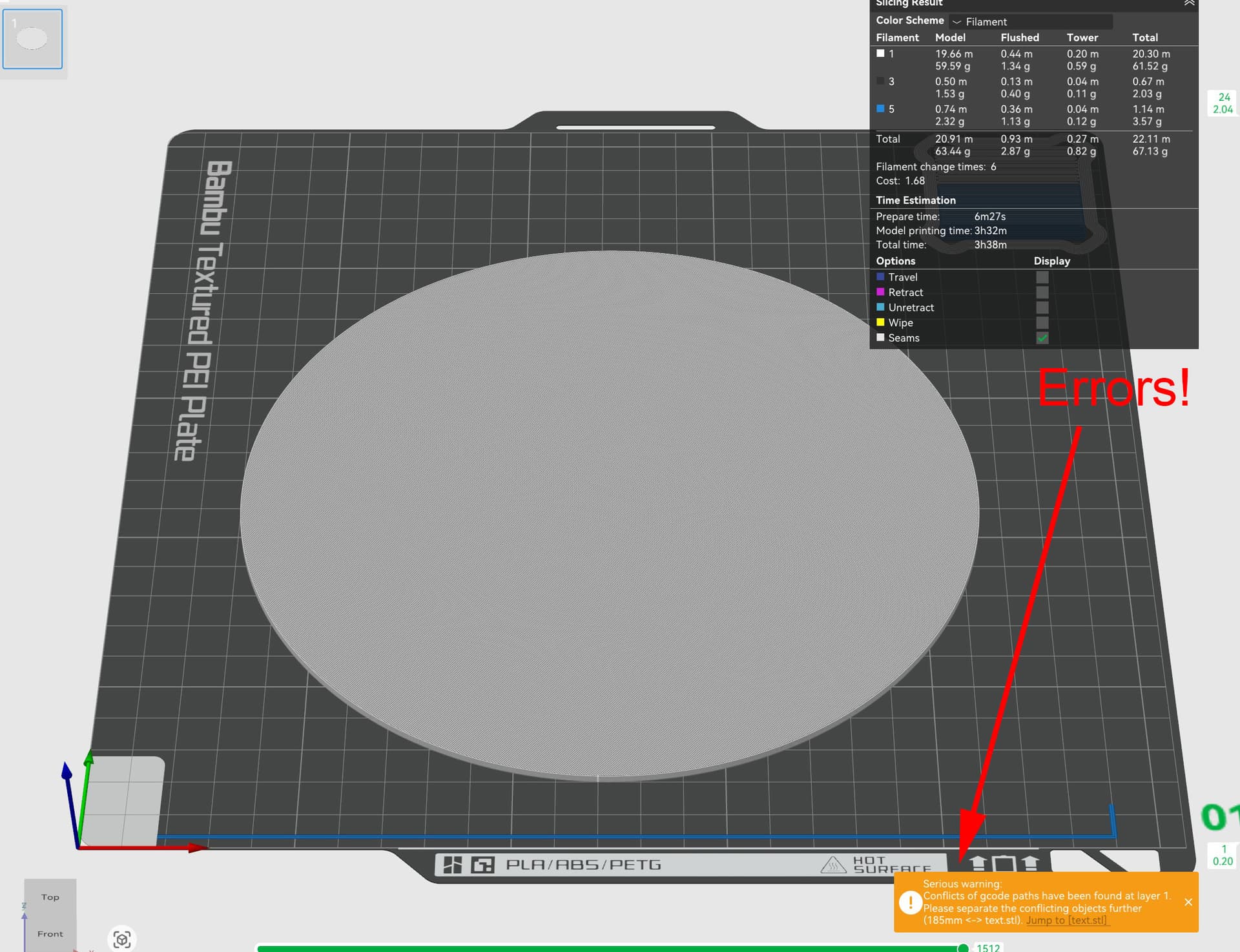

I’ve been chasing G-code errors, serious warning conflicts, you name it, for a full day. I’ve read and tried ever solution I could find to no avail. So, today I began testing by pulling the more complex SVG parts off the plate and slicing one by to find which one was the problem.

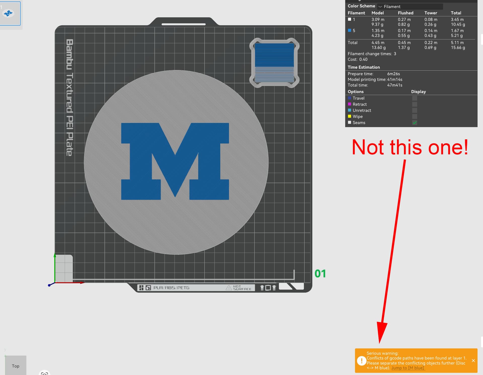

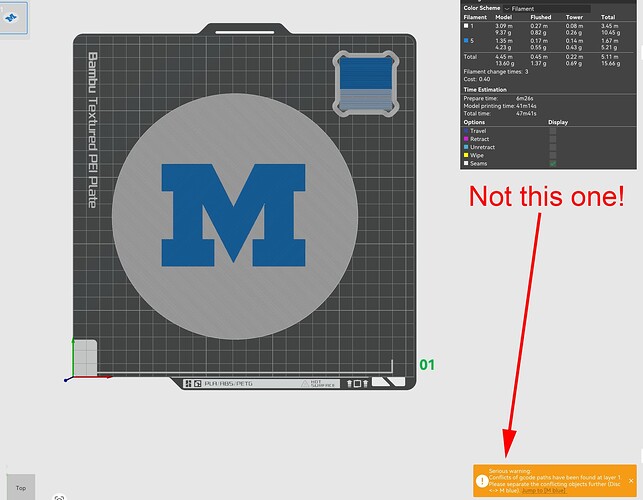

My project is a coaster (See attached photos). I have a simple round base and assembled some SVG parts I designed using a quality vector based software. As the design was complex, I assumed they were the issue. I was wrong! It is the simple round base.

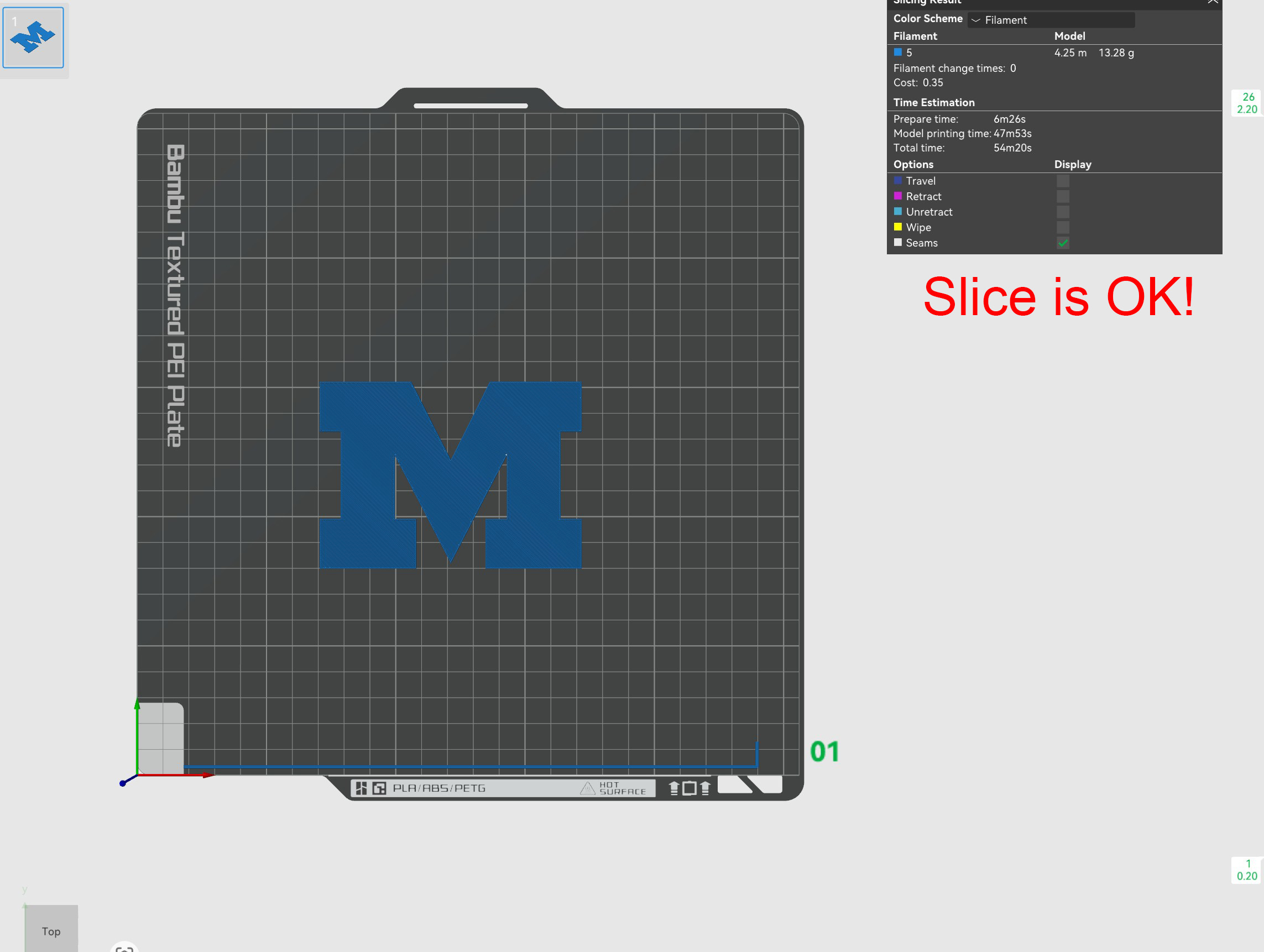

Removing the simple round base and previewing all SVGs I designed sliced OK! Slicing the simple round base alone, no other parts, had all the errors. How is that possible?
I’m a newbie but tempted to ignore the error(s) and print my project. Is that a bad idea.
In the first picture there’s something under the base that isn’t attached to it. Is the “M” under it? If you use the mouse to drag it to the side you should be able to see what’s there.

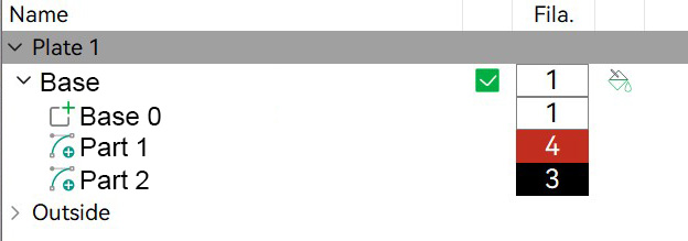

I believe I have found the problem! This probably was suggested before but, forgive me, I’m a thick headed newbie! :wink:
My models are come out without errors now. Working in the Objects window, the first part Imported should be the base model or main part, etc. Resize if needed (so far mine always do!) and locate on the PEI Plate in a likely non-tower interference location.
Then select the Base part before importing the other parts doing the same process each time. This keeps things in the proper order.
This seems to be the solution. I’ve reworked my other error-infected models and this solution fixed them first try!
