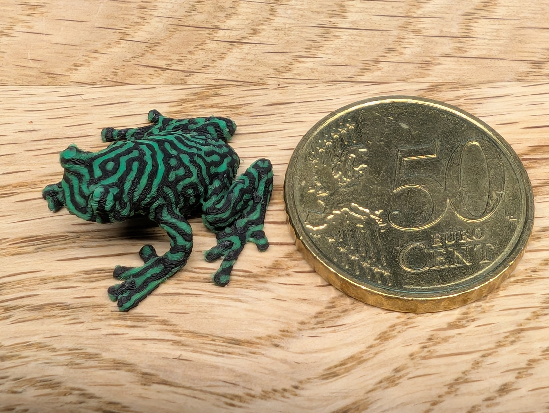

Interesting, I didn’t have much trouble up to now printing regular PLA (e.g. BBL PLA basic) on the X1C and now with both nozzles on the X2D.
This 20mm long frog is black PLA basic on main and green PLA basic on aux nozzle. 0,1mm layer height on smooth PEI plate:
I watched the first layer and anticipated lacking extrusion control of the aux nozzle, but it did a perfect job.
Which problems do you have?
