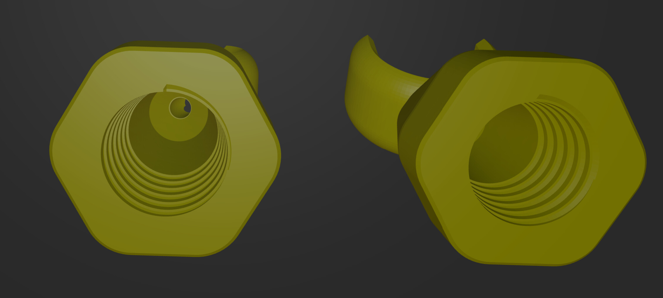

I am trying to create a model where I need the tread that is on Bambulab oil tube but can’t get it right. Is there a specification of the thread to find somewhere?

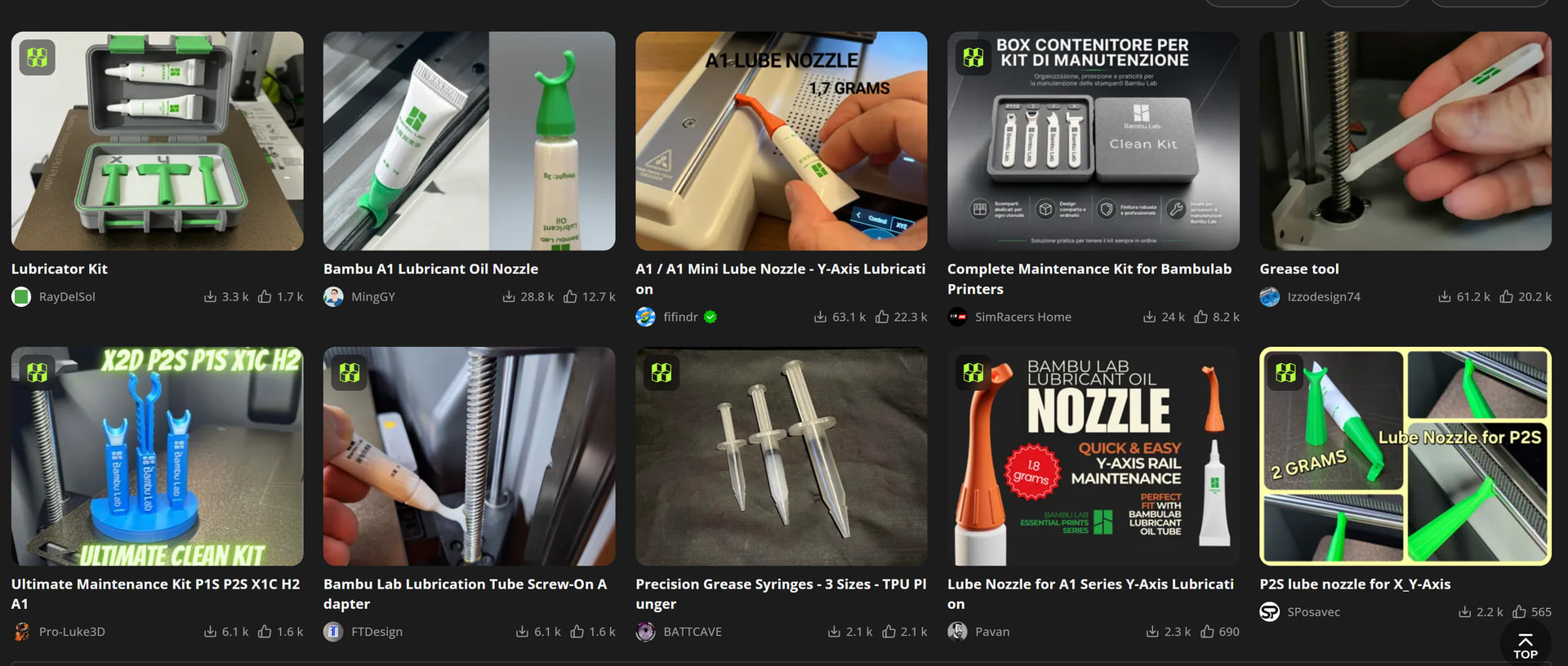

The best thing to do is go to MakerWorld and search for: “Bambu Lab Lubrication Tube”. There you’ll find countless 3D models from which you can determine the thread dimensions.

…or you can make it even easier and just use the threads from an existing model. Then you don’t have to measure it at all.

Problem solved.
I used ChatGPT and described my model and uploaded “Bambu A1 Lubricant Oil Nozzle-stl2” from MakerWorld and told ChatGPT to find & analyze the stl-file for the thread.
ChatGPT found the thread profile in stl-file and implemented it into my OpenSCAD code which I imported to Bambu Studio and printed … it worked just as a Swiss clock
