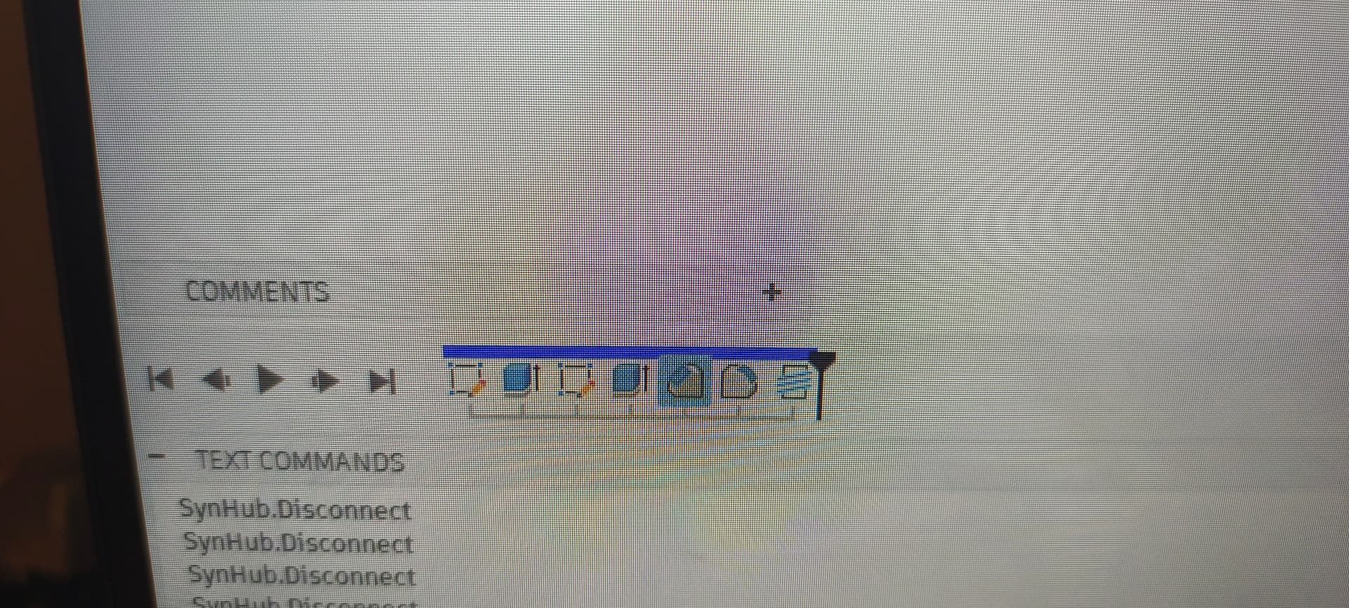

Rotate the bolt and look at the thread start, it will look like mine it wont work, the thread is flat on the bottom of the chamfer, it would work if you were cutting threads on lathe or mill but it doesnt ,model correctly for 3d printing.
I can see what you mean but as you can see on fusions timeline I chamfered the dia first before applying the thread .
I put a 2mm chamfer on and it should if been 1.1mm

I managed to sort the chamfer out so the threads lead wasn’t removed .
I modled the dia down to 19.9mm and opened the bore up to 18.15 on the nut
The parts went together perfectly .
