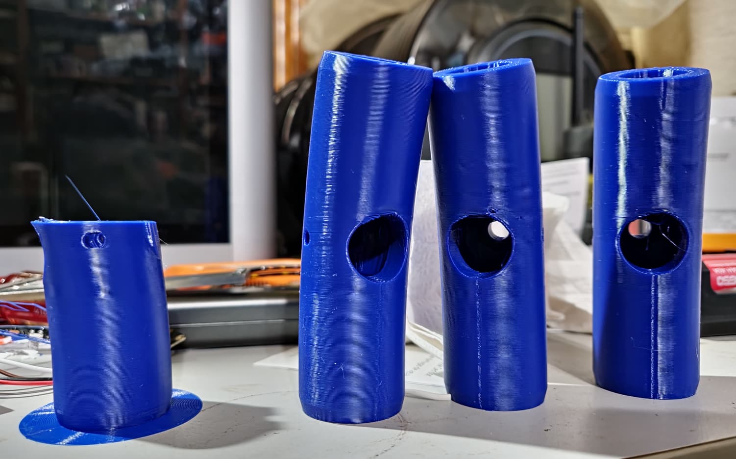

PETG is a challenging filament to print. It likes to be stringy. And the strings tend to collect on the nozzle until they’ve built up enough to snag on the print, leaving a blob behind, which cools quickly and becomes very hard. When the nozzle comes around to that spot again, it hits the solid blob and that knocks the print loose.
These 4 things were printed on the same run. The short one got knocked over halfway through the print. If you zoom in on the top left side, you can see the blob of PETG that was deposited by the nozzle and which was responsible for this object being dislodged from the bed.
PETG has to be thoroughly dried and both flow and PA have to be carefully calibrated if you’re printing objects like this that can easily be knocked down. You can afford to be less precise with tuning if it’s a big object with a lot of contact with the build plate.
