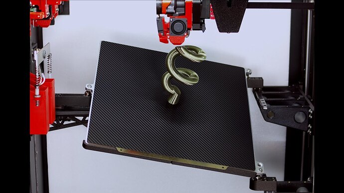

Rather than tilting the entire printer, the heat bed can be tilted.

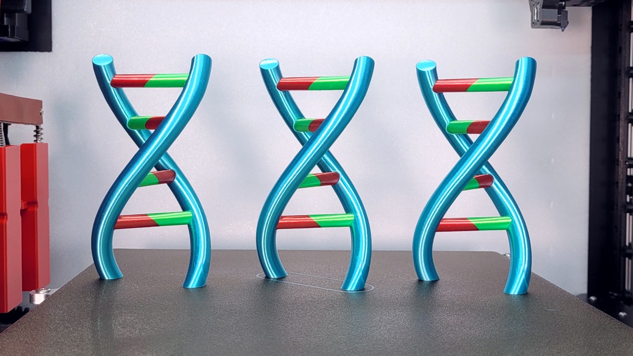

Multicolor, support free printing of a double helix:
Yeah, but since the whole idea would be to reduce the average overhang angles of the last few printed layers as z-printing increases, I think that overall sag risk would be reduced. We usually have chamber temps much lower than HDT temps.
That is cool, even more sophisticated than the concept I was envisioning, since the planes of the layers changes with respect to other layers and the print bed. I think that solution is more advanced and would require other thoughts about the slicer / toolhead-print interference etc..

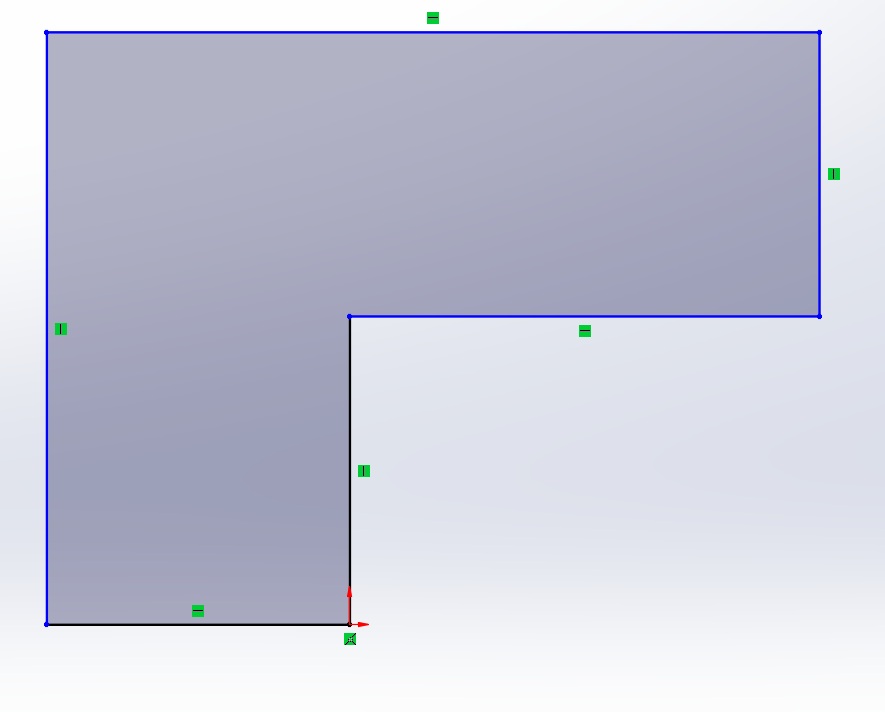

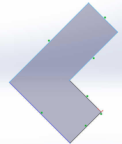

I think I understand what the OP is describing. But lets see if I do.
Lets say I am printing a simple L with the bottom horizontal on the build plate.
once it gets up to the overhang the printer tilts 45 degree so the overhang is supported.
build direction is the same but gravity effectively shifts.
