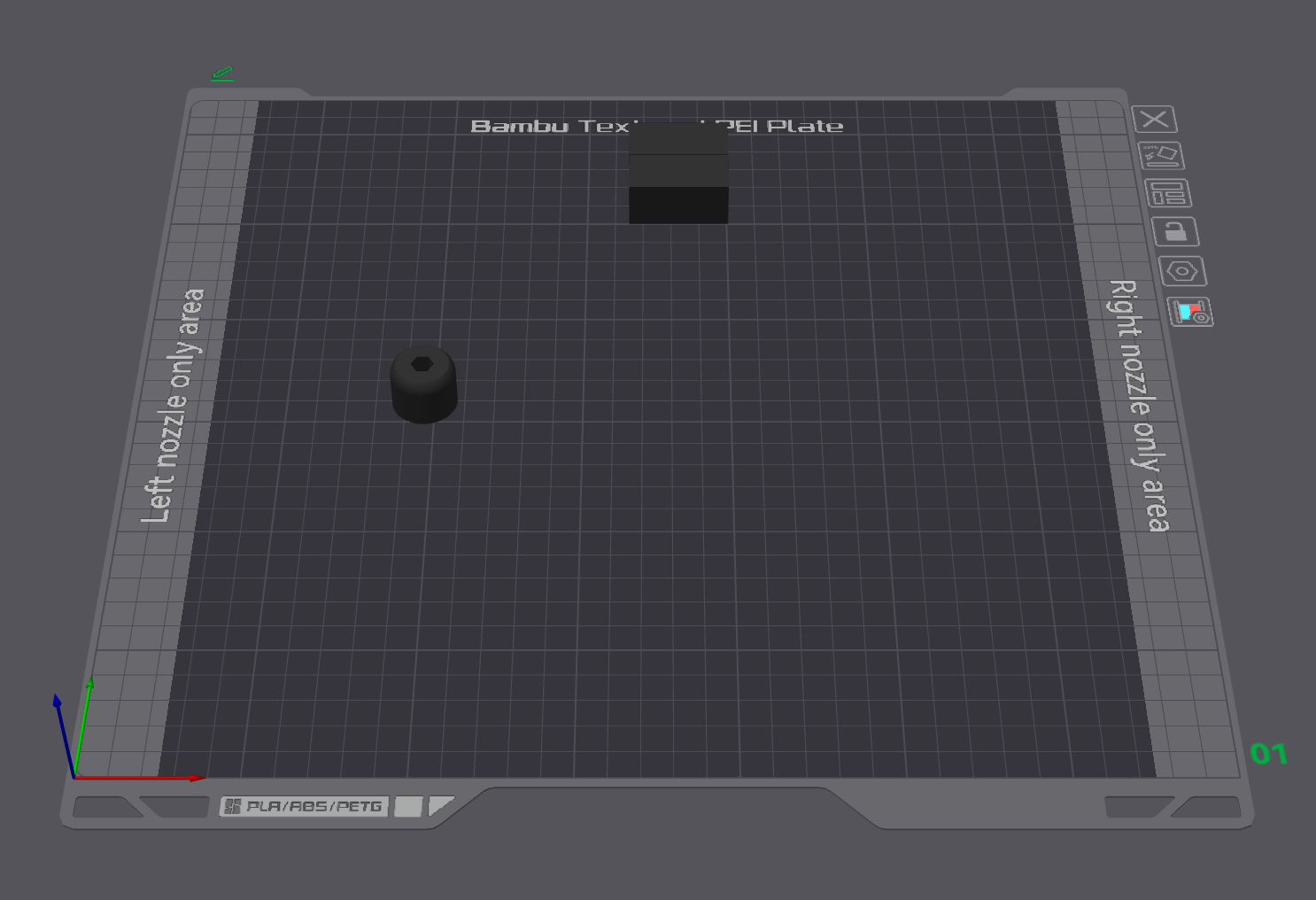

I’m about to start some projects using Bambu’s PET-CF with my H2D. I used to work with Ultimaker Cura, so the Bambu Studio setup is still pretty new to me. (Actually the whole Bambu / ASM experience is new to me!)
Since PET-CF is quite pricey, I’d really like to minimize waste. Does anyone have tips or advice to help me get started?

It should be pretty straight forward with H2D, I dont foresee any issues. Just dry it appropriately (temp + time) and slow down the print speeds for outer walls to maybe 60mm/s.

One MASSIVE tip when doing prints in an expensive filament, is to look through the geometry and figure out if there is a section that is going to be difficult. Maybe, steep overhangs, thin walls, tough supported sections, etc. Once you find them, cut the model in the slicer and only print the tough section until you are comfortable you’ve got the result you’d like. This way you don’t waste a ton of filament on the easy parts only to find the hard part doesn’t print well.
For example, I’m currently working on a model that has TPU and PLA features (print in place TPU detent for a normal 1/4 bit driver). So instead of waiting 2 hours to see if it printed well, I simply cut the model down to the trouble point and test that quick section.
This allows me to test really quickly and without using a ton of wasted filament.

The project I’m doing are an ease print (some boxes), so not really needed this time.

I just finished my first PET-CF print, and it printed beautifully!
Absolutely no issues at all (except that it smells really bad).
Since it was Bambu Lab’s PET-CF, I used their filament settings.
