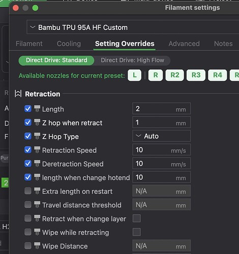

How do I change the retraction?
Here are my override settings for TPU, I also lower the print temp by 10c. Pretty much eliminates stringing.
