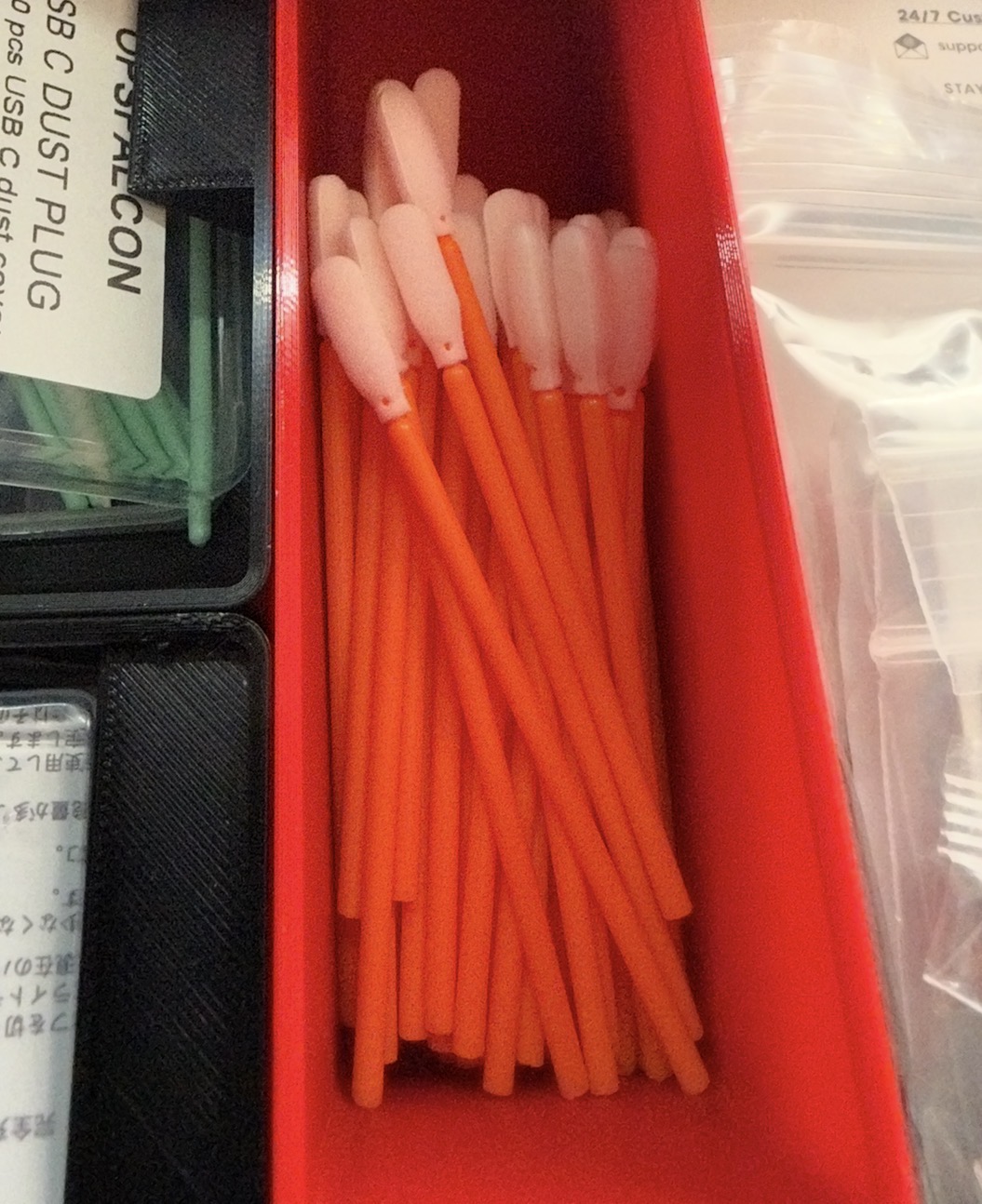

I usually use those little foam applicators, they look like q tips, to apply the oil to the rails. Soak the foam tip and rub it on the rail and in the grooves.

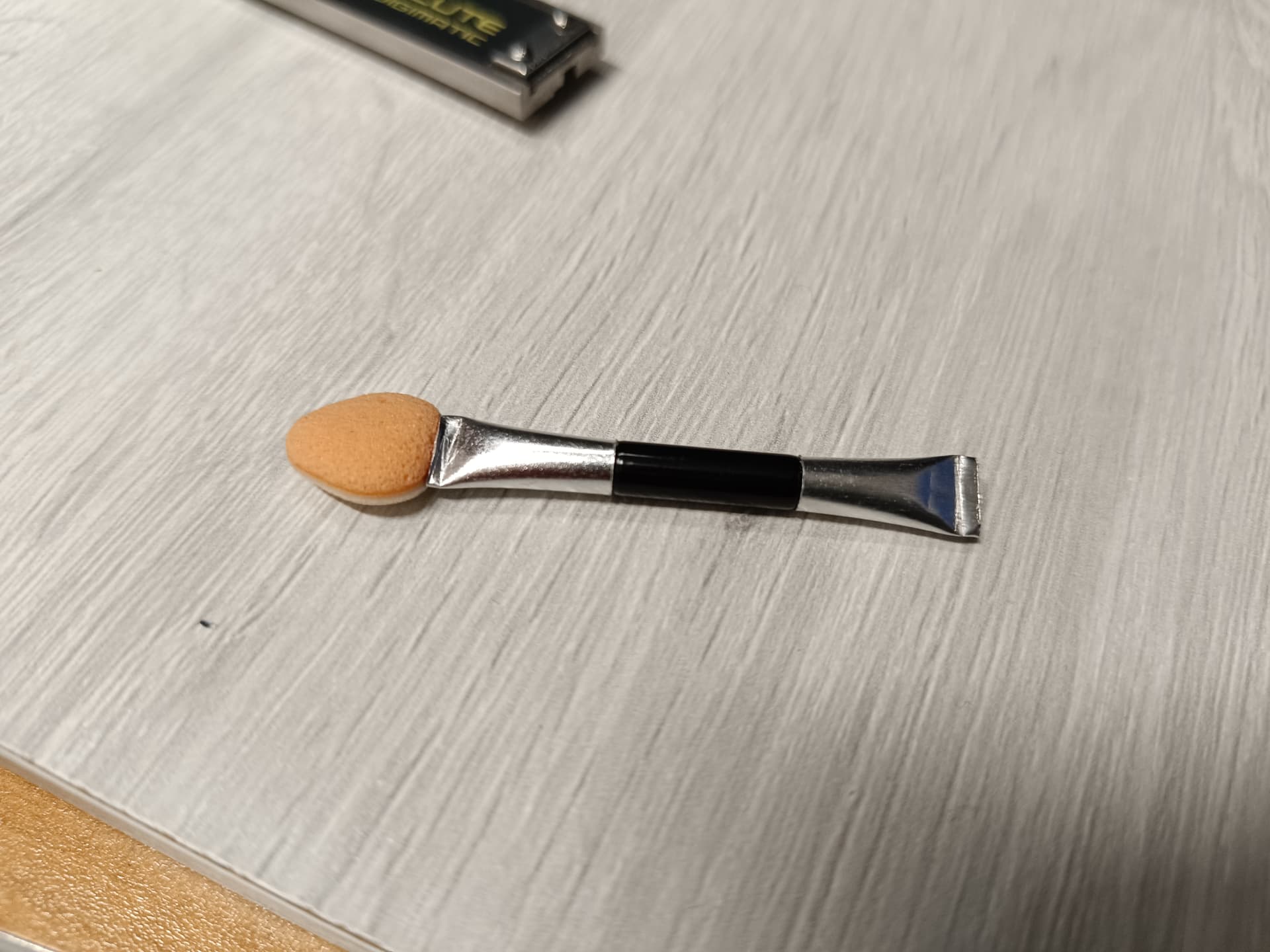

Do you mean something like this?
Great idea, I hadn’t thought of that… I used the tube exactly as shown in the video on the Bambulab wiki.

Pretty close. These are what I use. Wellgler’s 200PCS 3.65’’ Foam… Amazon.com: Wellgler's 3.65'' Foam Cleaning Swabs,Multi-Purpose Detailing Foam Tip Swabs, for Electronics,Gun,Car Vent,Printer,Sewing Machine. KM722 (Orange 200PCS) : Beauty & Personal Care
perfect, thanks a lot for your help :+1:
I use sensor cleaning swabs for digital cameras. You can buy them cheaply on Amazon or Aliexpress.

Thanks, they look more comfortable than the one I photographed… I got it from my daughter’s makeup bag :joy:

That’s what I thought when I saw it; I thought, “I’ve seen that somewhere before.” I also have a daughter, but I’ve never thought of that. If need be, I might even peek into her makeup box! :joy:
Yes it’s true…the makeup bag can be an unexpected resource :rofl::rofl::rofl:
