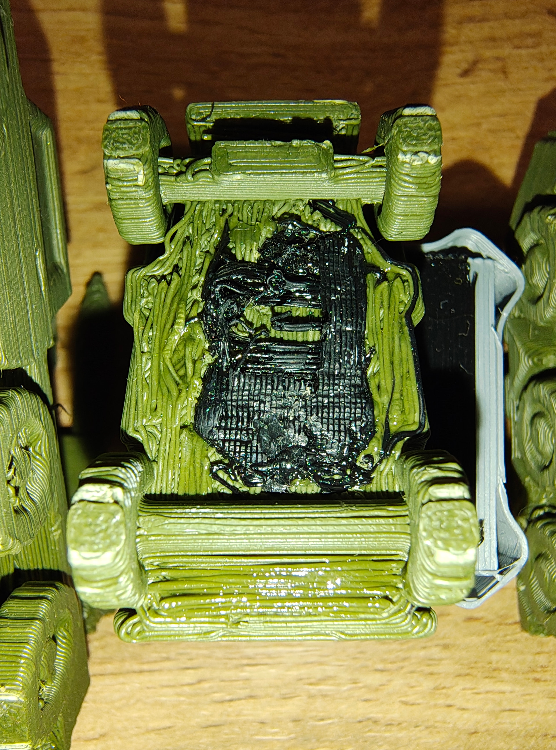

This is PLA with support PETG
Yes I’ve messed around a lot with this. Simple models it works great and I can design small prints without having to be overly concerned about overhangs, but uncomfortable leaving long overnight prints when using secondary material supports. I’m not sure Bambu know exactly how to fix this since they have conflicting info on their website.
One thing to watch for is bed temperature - Bambu suggest lower temps when using PLA, but don’t do that with bigger prints - PETG even more likely to release from the bed which causes a lot of these issues.
Still playing with this so will update the thread when / if I get to the bottom of it. It’s not just the X2D - the H2D has the same issues and I have seen at least one video where someone with an H2D gave up using other material supports on more complex prints.
