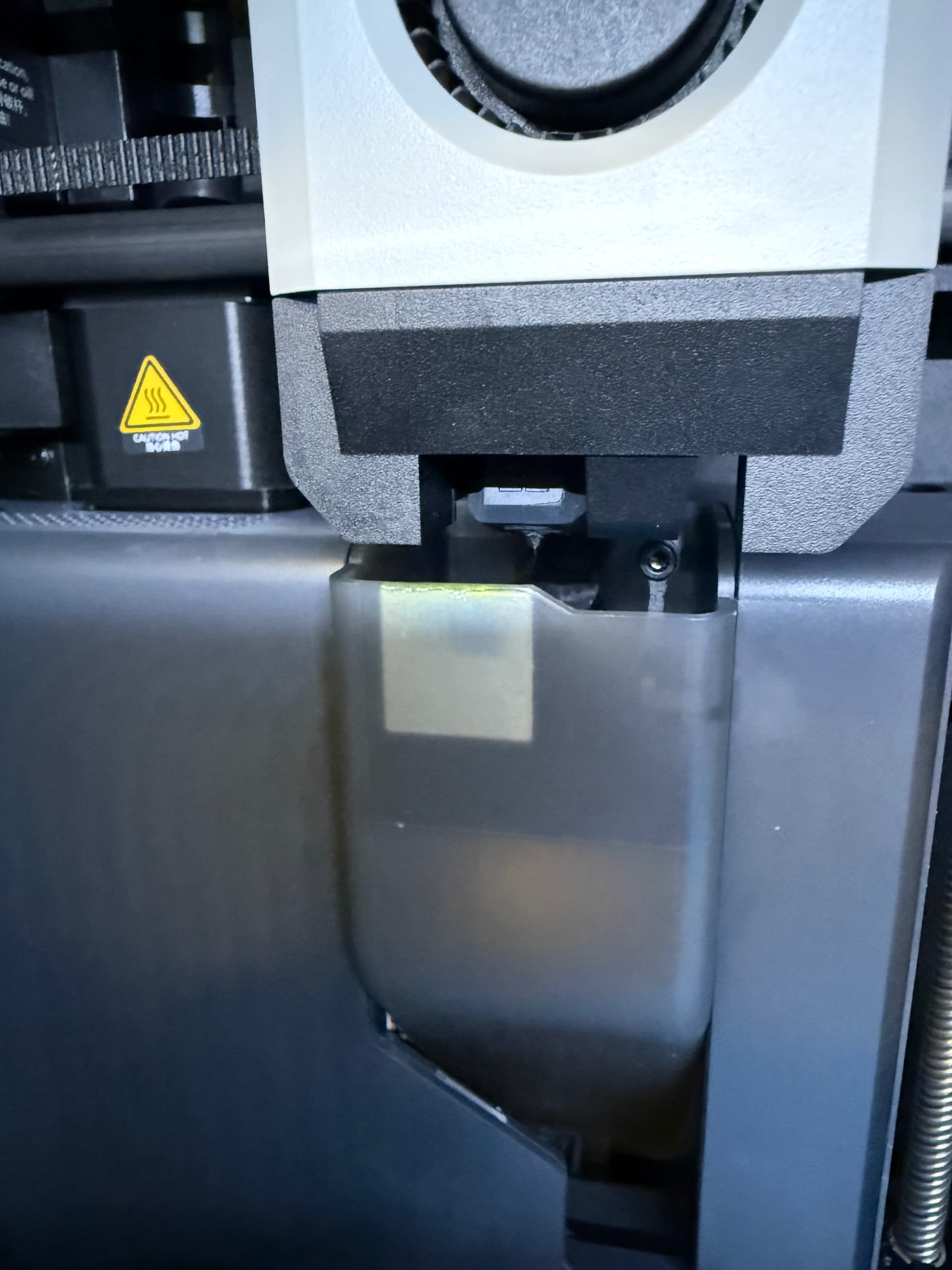

I’ve had a strange issue start with my 2-month old P1S. Just with the last couple of prints, it’s like the toolhead is off axis by a few mm forward; by which I mean the test strips that used to print perfectly along the front of the build plate are now slightly off the front of the build plate, and when the head purges filament into the poop chute, it’s hitting the lip at the front, clumping, and dropping onto the build plate.
The picture isn’t the best but I can’t seem to upload a video unfortunately. You can see the yellow line on the chute, that’s from a multicolour print where it was constantly purging onto the rim of the chute instead of into it.
It really looks like the print head is just sitting a couple of millimetres closer to the door than it should; if everything just moved back 2-3mm it’d be perfect.
Normally this is because either the nozzle is bent or the head can’t fully home in the front right corner. Too short of PTFE tube or mods to the printer can prevent correct homing and will offset the print head in relation to the print bed/chute. Take the top plate off and manually move the print head to the front right corner and make sure there are no obstructions.
Yes. Kill power and see if it moves all the way back. Check for poops that got loose and are blocking the gantry.
