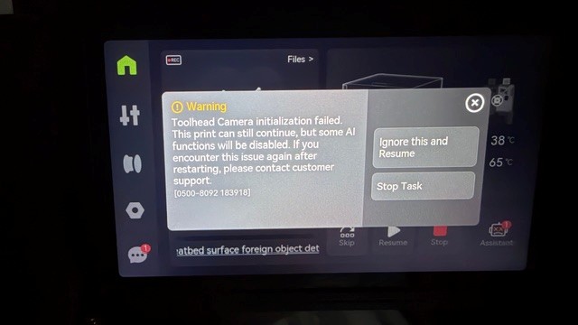

i have a strange problem with my H2C (Firmware: 01.02.00.00).
I start a print (it does not matter if Studio or Handy). The print finishes without any problem. After that i start another print (no power cycle between prints). This print will fail.
It starts during the foreign object detection task. First there is a warning like “nozzle camera malfunctioning”, which shows up in the assistant but the printer continues. A few moments later the task stops with the “tool head camera initialization failed” error from the below screenshot. If i power cycle the printer everything is good again. The first print never fails.This also happens via Bambu Handy.
All cables and connectors are looking good. The cameras are clean. The strange part to me is, that it (so far) NEVER happend on the first print.
I already have a ticket open, but so far no usefull reply. Maybe someone else has/had the same problem?!

Yeah Im having the same issues with my H2C, I would say for the first 10 or so prints it was fine, but now I get this error on every print…if I reboot the machine and give the lens a wipe I found it wont give me the error for a single print, but then it happens again for every print thereafter, I havent opened a ticket for it myself yet as Ive only just recovered fro mthe PTSD incurred from fixing my H2S, but i would be interested to hear if any outstanding issues are acknowledged as lots of people are reporting this same issue.

„Glad” i am not the only one. So far the only Suggestion from Bambu was to check both ends of the usb c Kabel between toolhead and ap board - which would mean I would have to disassemble the whole back of the toolhead with all its tiny cables and connectors.
I already tried a software downgrade, reset and then upgrade again. I now cannot calibrate the Vortek rack anymore. There also now always is a camera error during the calibration. Even a power cycle does not help.

The Toolhead Camera was replaced first, and it worked for a few days before the same Toolhead Camera initialization failed error returned.
I replaced the TH Board and the USB-C cable, and the camera worked again for a few days, but the same error came back. The camera and its cable/connector were also replaced.
Has anyone experienced the same sequence of failures, and what did Bambu replace next?

I didn’t have the exact same sequence of errors, but the past couple weeks I began having intermittent “Nozzle Camera malfunctioning” errors, which became constant and not intermittent after a few days, and was soon followed by “Toolhead Camera Initialization Failed” errors.
Bambu first told me to disassemble the toolhead and remove the Extruder Interface board so I could unplug the connectors for both cameras and plug them back in. Then reasssemble the entire thing just to learn it did not work. So they offered to send me a new nozzle camera which requires the same disassembly/reassembly process.
They refused to send a new toolhead camera or TH board until they see if the Nozzle camera alone fixes it. Which is great for them, not so great for me and all the hours I have to spend tearing apart and putting the toolhead back together time and time again.
In the meantime, someone different at Bambu support told me to try rolling back the firmware which suggests to me this isn’t an unknown problem to them at this point.

I have the same problem with the cameras, too. Bambu offered to replace them, but I don’t think the issue is the hardware.
I think it’s the firmware.
I just ignore the error messages since they don’t affect the print quality, but it’s still annoying.
I also thought it was the firmware so I did a downgrade. I still had the issue afterwards - when I originally was on that firmware I had no issue.
