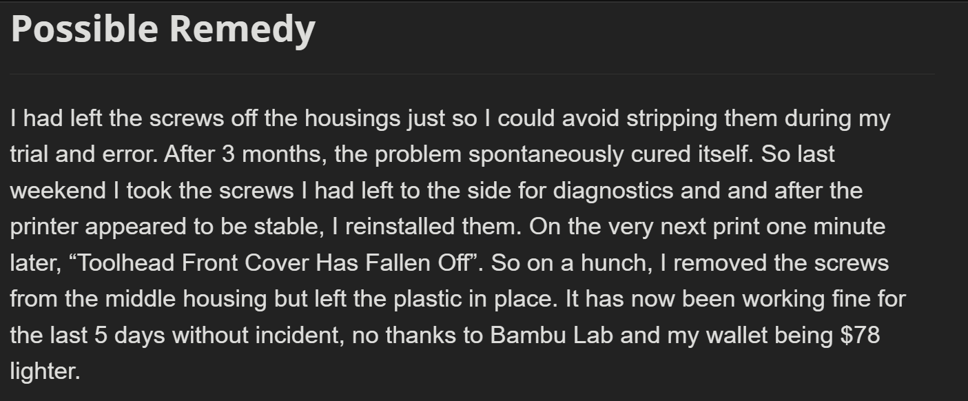

Did you read through this thread? The solutions is right there. Have you tried this?
https://forum.bambulab.com/t/toolhead-front-cover-has-fallen-off/112799/2#p-301100-possible-remedy-2
This remedy has been working now since last summer without incident.

I did all the steps on the bambu wiki - took the casings off, front middle and back, then checked all the wiring was secure
Disconnected and reconnected a few times, checked it was clean - no difference as soon as I start a print it throws the error
I’ll try taking the screws out the middle housing and see if it fixes it - but if it does I’ll be contacting customer service because just leaving the casing loose isn’t a proper solution IMO. There must be a design flaw that needs fixing :frowning:
