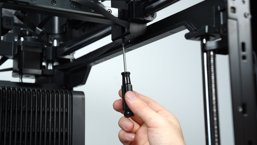

After multiple attempts to fix my hotend fan Bambu sent me a new toolhead and x-axis assembly. Everything was going fine until the last screw - a vertical one holding the x-axis to the y-axis slider. I had removed three of them without problem but on this one I got the allen wrench just a little bit off of perfectly perpendicular and stripped the head.

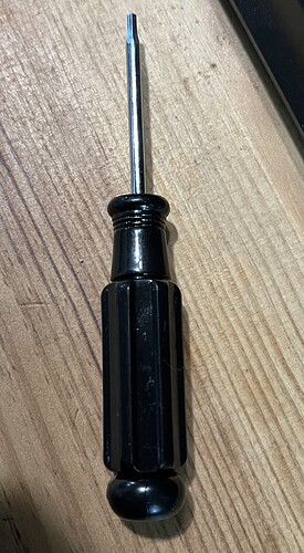

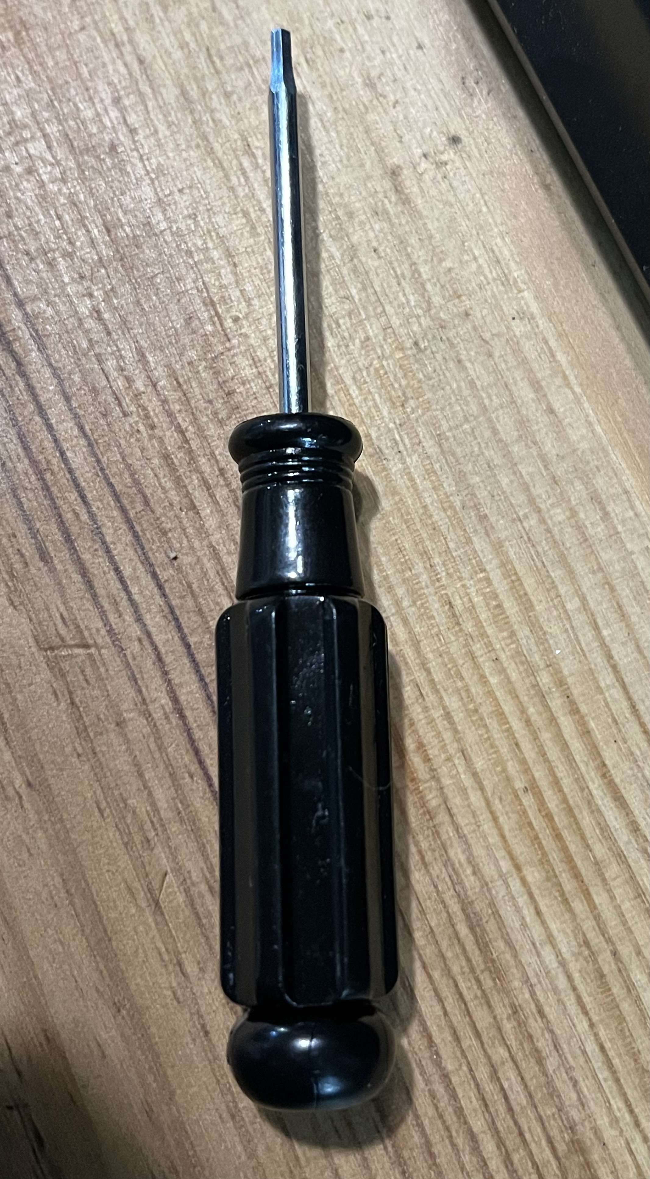

btw, as part of the vortek upgrade kit in the x-y axis assembly box, bambu provides a better allen key driver for that very screw than the one included with the printer. I did not use it as I use my own tools but the one provided has less chance of stripping this particular screw and certainly why they included it in the kit.

They supplied one of those small screwdrivers in the kit with the new toolhead. I was unable to apply enough torque with it on the subject fasteners. I was barely able to apply enough torque using the short arm side of the standard allen key when removing the top screws through the access hole, and thus I tried the same method on the bottom ones. Worked 3x…
